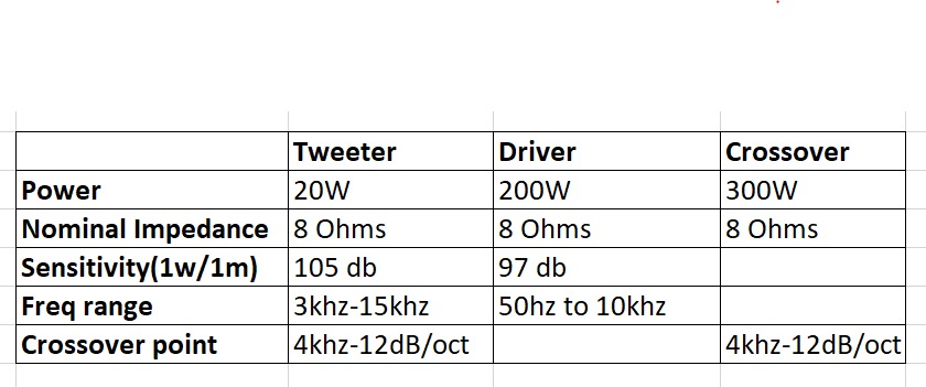

Can you help me estimate the final impedance of a 2 way speaker please? (What is the logic to estimate final impedance by the way?)
The specifications of driver+tweeter+crossover are in the attached image.
Thanks a lot in advance.

I am beginner in diy..... particulary in electronics.
I am sure if two drivers are connected in series or parallel makes the impedance double or half.
But im not sure how the impedance gets effected by adding the crossover in between.
So you are saying the impedance of the total system remains 8. Is my understanding correct?

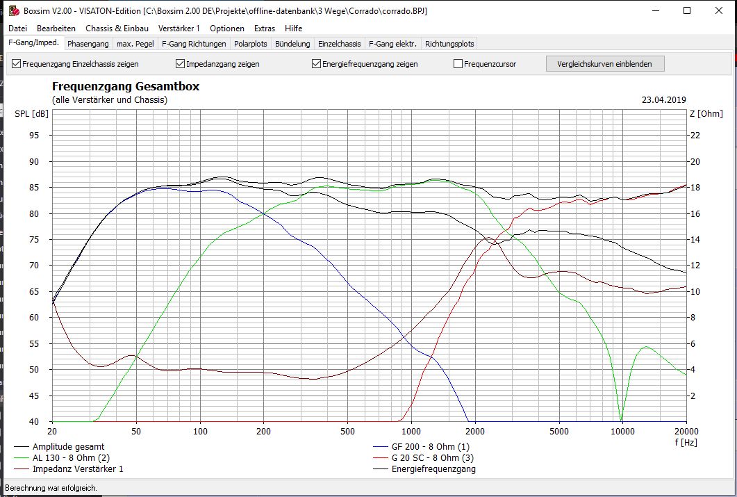

when you say "depending on the crossover" you mean the internal design of the crossover i guess.
The filter design has to fit the drivers. 'Universal' crossovers don't work because every driver got its own frequency- and impedance response, how it changes over the frequency range. The crossover can't 'know' how the driver behaves. Even with just 2 parts (2nd order, 12dB/octave (=double the frequency)) there are a lot of different pairings possible. If the fall off isn't steep enough or it got some ugly bumps or too soon drop in level, some developers don't use a compensation or a steeper filter (i.e. 3rd order, 18dB/octave), instead the serial coil of the woofer is chosen smaller and the capacitor to ground bigger. That works in some cases but at the same time it lets the impedance drop. If the developer isn't careful, the impedance might drop much further down than the plain 8-Ohm drivers might let it seem.

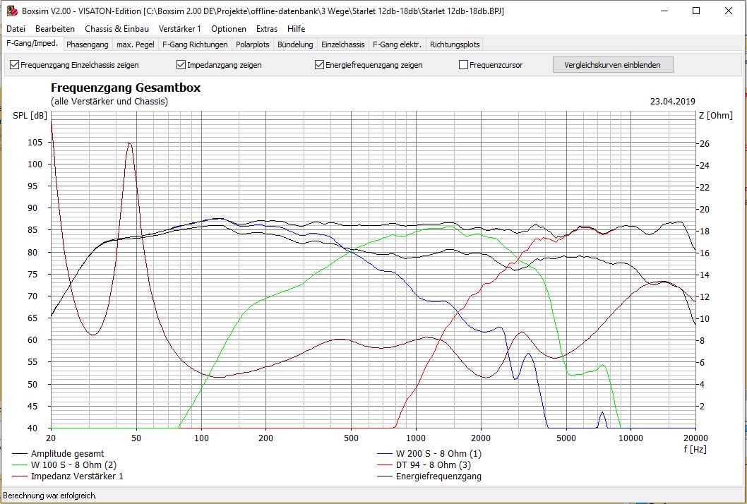

An example:
attachment.php
(Not my project)
Despite all drivers being 8 Ohm, the minimum impedance is just 3,5 Ohm at ~350Hz, overall clearly a 4 Ohm speaker.

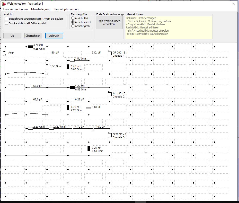

attachment.php
The crossover.
