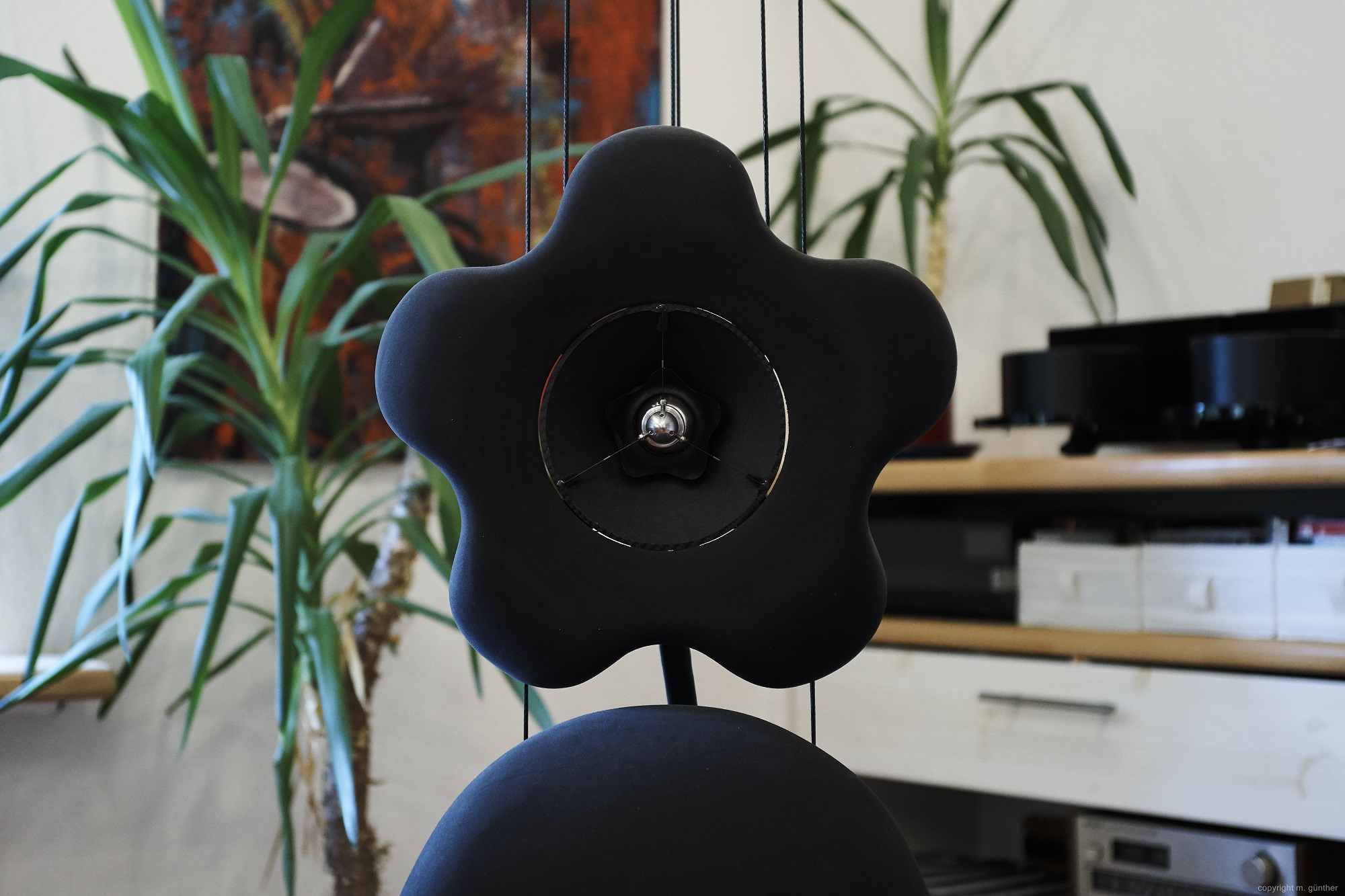

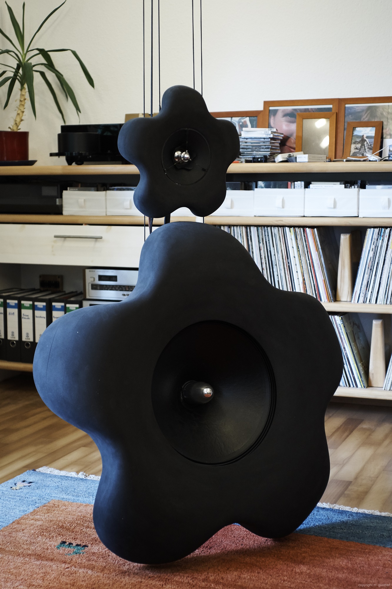

Hi Krakatoa,
with regard to suspension-less drivers, there was the Fostex SLE series as well, although I have to admit that I never heard any of those. They had a very small gap around the cone, but it appears to me that this is not a problem, if the gap is small enough.
The Fertinacoustics M8 models (which are certainly influenced by the Goodmans Axiom 80) have a gap of about 0,1 mm, and again it appears that, at least in vented boxes, this is no problem. My OB application of the M8 has a slightly larger gap, but less than a mm. Measurements showed a very slight difference compared to a smaller gap - hard to tell if they´re there or just measurement irregularities... but then of course I use my fullrange only above 250Hz.
The Davis Acoustics 20DE8 fullrange has 1mm slits in the cone - again it appears that use in a vented box does not suffer too much.
All the best
Mattes

Hello Mattes, I was aware of both your open baffle hanging black flowers (if I remember correctly that's how you call them) and the Fostex surroundless woofers; I did put the question in the context of fullrange speakers, and yes the Fertin speakers are the only ones I know that don't have any surrounds... and they work, it's not like there is just resonances all over the place you can't even listen to them (I don't have the experience of listening to such speakers, but I did listen to speakers with no surrounds lost by decay of by me cutting them out). So I guess in the context of my question this proves a surround does not need to have the properties of an anechoic chamber.
Why do you say Fertin was influenced by Goodmans Axiom 80? I know it's the same surroundless solution but I never heard Fertin borrowing it from Axiom 80. Oh by the way - do you have a description from personal experience what is the sound of surroundless?
On the matter of fullrangers without a surround I know of at least two other models, one of them may not be surroundless (I have a few poor images, can't tell) the other one is an almost unknown "hero" from the past - it's called Exact PX EX (or Exacta, Xacto?) and it's a 30 cm unit from the 70s made in Japan by Takashi Sano with a massive structure attached in the back, high excursion, weird construction, the kind that any collector would like to buy, steel, go to prison for, do things that are hard to describe etc just to own a pair. Anybody that has any information, written or images, on the matter of this unit I am very curious to know more.
The air gap that comes with a surroundless is much less of an issue than people think, I had gaps of 10 mm and it still worked way better than expected in a transmission line.
To supply some historical information, the Axiom 80 was purposed to operate in a large sealed enclosure or a smaller ARU enclosure (aperiodic loading).
I've not seen one in a vented (reflex) enclosure.
