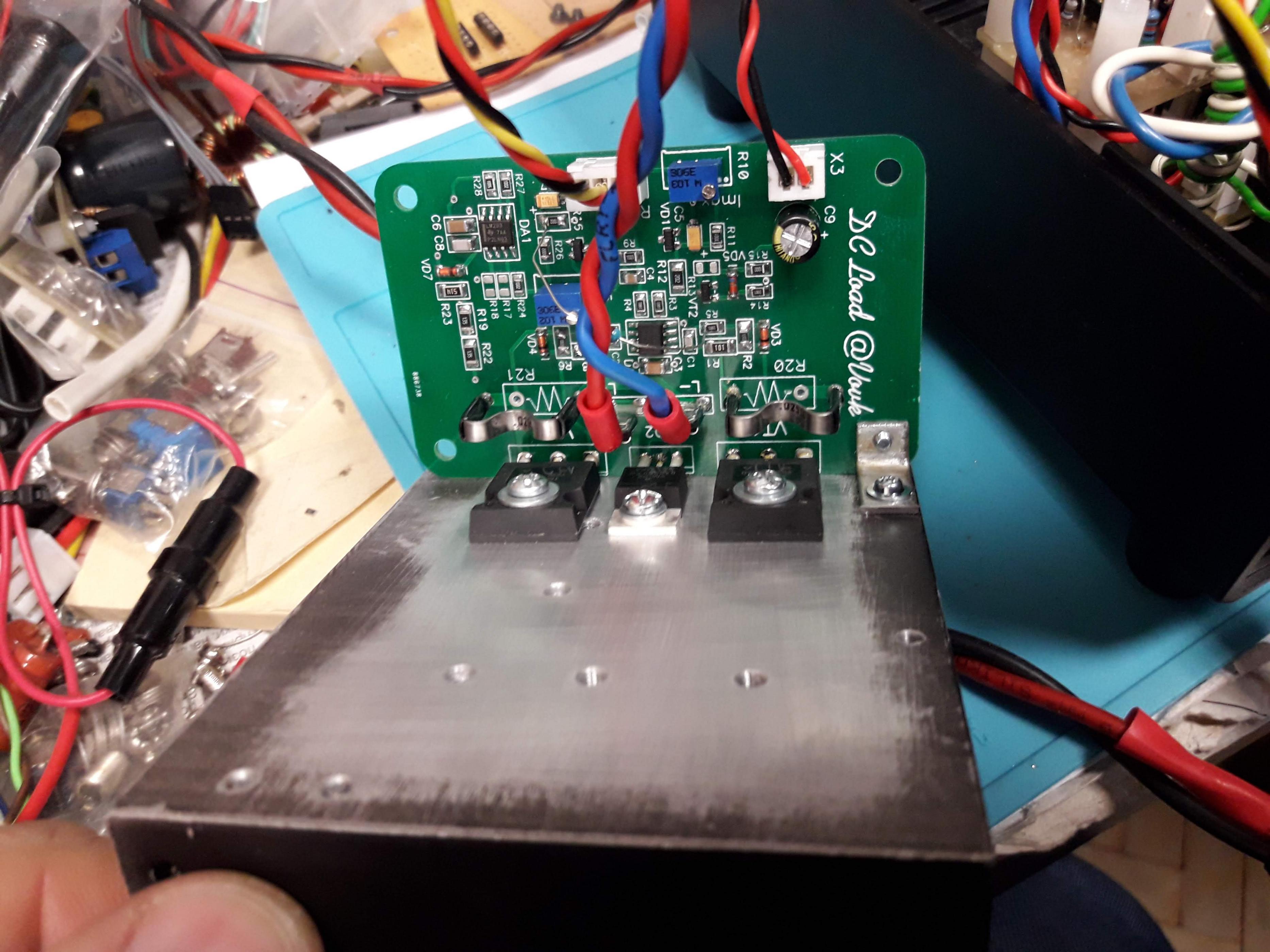

Eletronic load module, made two for me and one for my friend (who routed and ordered the PCBs).
I had an Electronic load long time ago (diy too), but it was made on universal circuit board, and now it is made on beautiful chinese ones with silk etc.
2xTO247, so it is 100 W long time power (up to 150-200 peak), CC only.
Previous project it was high voltage low frequency oscillator, up to 140 VAC, 43-53 Hz, 5-10W.

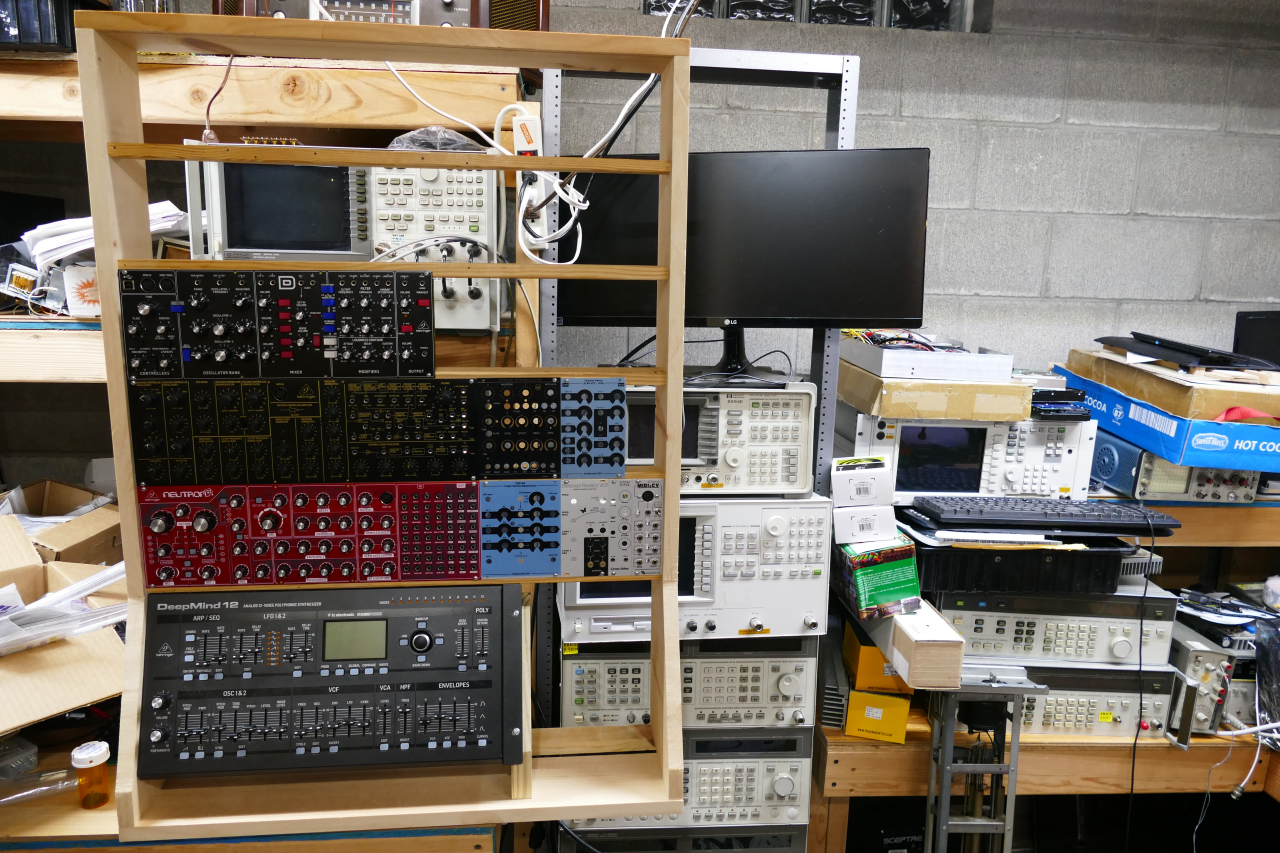

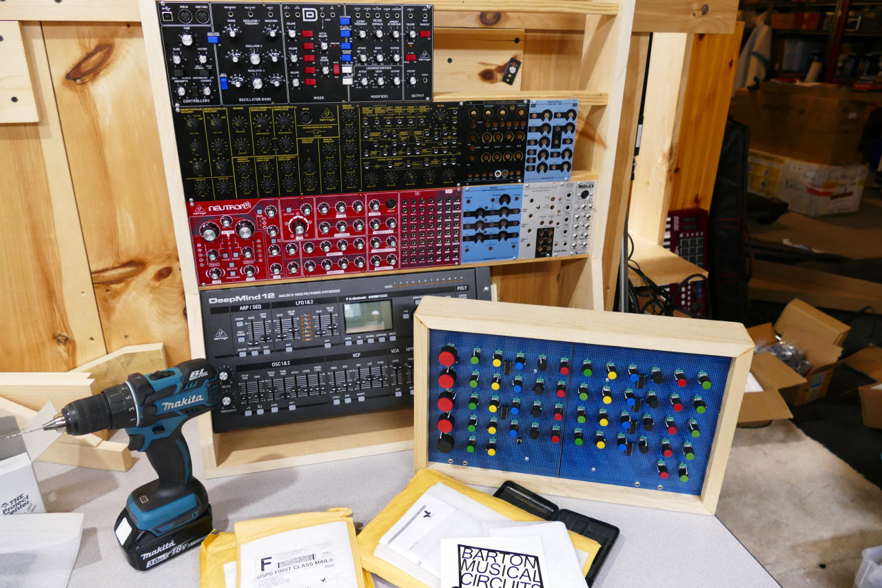

After several weather related interruptions and do-overs, I have decided that the simple wood frame Eurorack cabinet for a collection of synthesizers and modules is "good enough" for now...and maybe forever.
The weather has waffled between cold, but dry and sunny, to yesterday's constant rain-ice-snow, to todays 18 degrees F (-8C) and 20 mph winds. This is expected to linger for a few days with a bit of random snow and ice just for fun.
All my woodworking stuff must be used outside in the driveway, but final assembly is in a reasonably warm basement. I am as the mounting and wiring stage now, with power - up a day or two away.
I was looking for a way to fit Blue Face into the rack, with a real front panel, but there was no easy path to do that, so for now it will remain a separate synth.
This one is actually case #3. I outgrew the first two. #1 was a wood and sheet metal cabinet that I got at a surplus store several years ago. It had a suitable power supply and only needed some holes redrilled to fit Eurorack modules. Unfortunately I filled it up rather quickly, but had no problem selling it at the Dayton hamfest a few years back.
#2 was an Oak fame with pre-made aluminum Eurorack rails. It ran out of space about the same time that it's power supply ran out of amps. I took it apart to re-use the mounting rails, but the weather changed my mind and this one got stuffed into a compressed time frame. The fancy rails are still in the garage. I used some cheap pine for the outer shell, and some harder unknown wood scraps for the mounting rails so I could slap this together in 3 partial days. The unknown wood rails are actually drilled and tapped for 4-40 screws.
I needed something to get most of the electronics into one box and on to one power supply for testing and further development. A better cabinet will likely be needed down the road, but there are too many unknowns to spend time and money on a nice one now....and it's bleeping cold outside.

That's a pretty nice collection of RF test gear you have in the background.
Thanks. I was an RF engineer at Motorola for 30 of the 41 years I worked there. I have been working at recreating my test bench at Mot, one dead Ebay find at a time. I got pretty good at fixing HP stuff, but I also worked in the CAL lab at Mot when some of this stuff was new.
Now that I'm retired, I can legally build stuff like ham radios or do contract RF work.

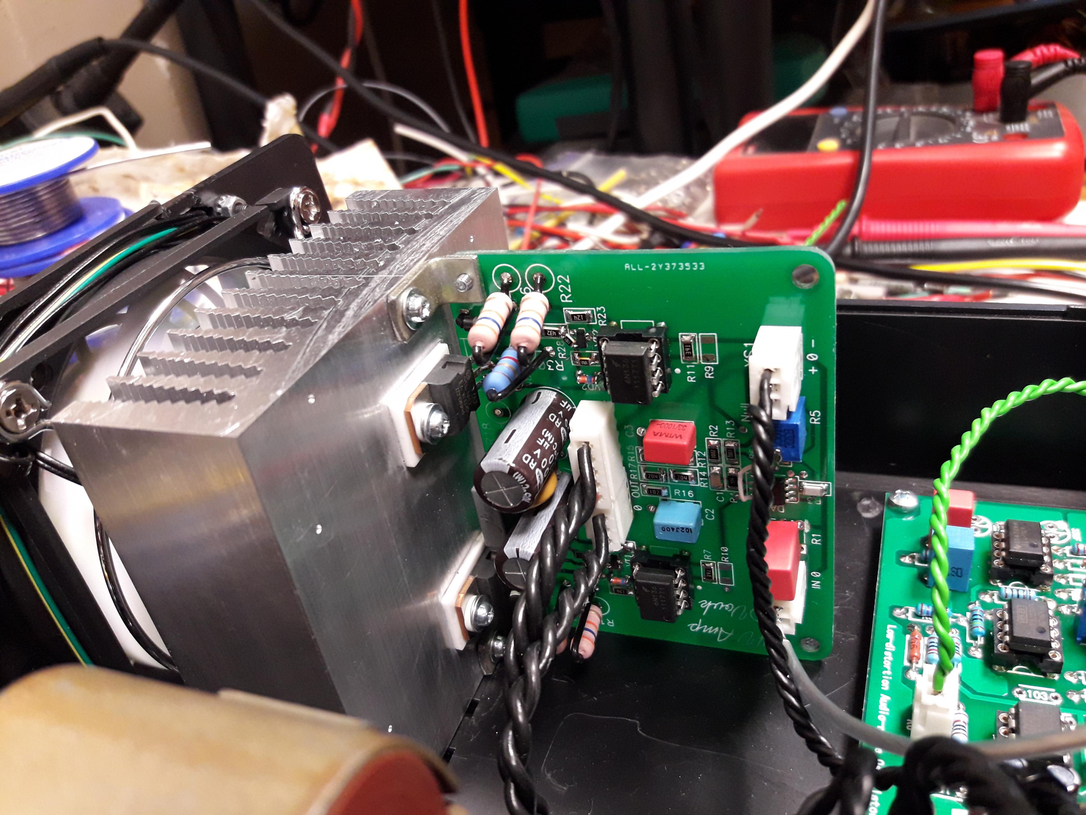

The last thing I built is a stereo amplifier using LM3886. The main PCB is laterally inverted and the chip pads are twice as large as they had to be. With 'some' patience and design, I made two small PCB adaptors for the chips and inverted PCB tracks. The amplifier works and only needs a proper heatsink. The current one is home made. Needless to state, the amplifier was tested with sufficient cooling to avoid damage.
