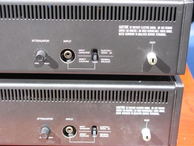

Some vintage Luxman power amplifiers (and also maybe an occasional rebrand like the Eumig M-1000) had a two-position switch on the back for ESL speakers, next to the input. One side of the switch would say: "INPUT CAPACITOR / ELECTROSTATIC SPEAKER" and the other "DIRECT COUPLING / GENERAL SPEAKER". See attached.
Now as a non-EE guy, I'm trying to tease out what this switch was actually doing. Luxman M-05 on thevintageknob.org - a page about a different amp - describes outputs with Zobel networks "for stability into reactive loads", but it's not clear to me that that's what's going on with the switch next to the inputs.
Any ideas? Schematic attached. I assume SW02 is the switch we're looking for, but I could be wrong.

Looks like nothing more than a DC blocking capacitor, it would also limit subsonic signal content to some degree. (I did not calculate the -3dB LF corner so no idea how effective this is.)
The transformers in many electrostatic speakers are not designed to deal with significant DC current and likely very low frequencies either, so this switch would make life a little easier for the transformer and likely the amp as well since transformer primary DCR should be quite low compared to the DCR of a typical speaker voice coil which could result in significant DC output current if there was some DC on the output of the pre-amp.

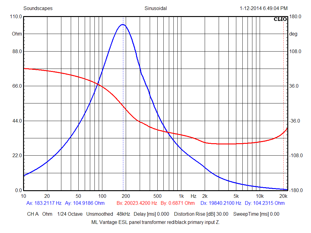

Here's the input impedance of a Martin Logan Vantage electrostatic where I bypassed the passive crossover and measured the transformer directly. Blue is impedance, red is phase:

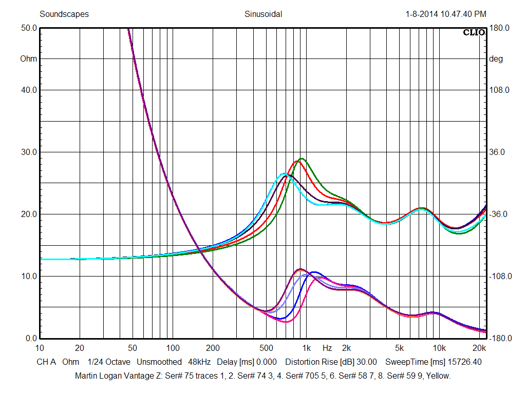

Here is the same measurement (but of 5 different loudspeakers) with the passive crossover in circuit. The lower traces are impedance, the upper are phase. This is the actual load the amplifier sees per Martin Logan's design. You would not need to insert the high pass capacitor with that switch on the back of your amp for this or most other modern electrostatics:
