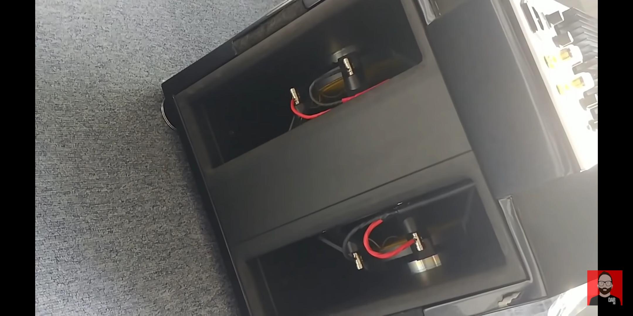

An interesting design indeed. What other configurations should I consider? A friend has dozens of drive units that he will part with for not a lot of money so I was hoping to find something suitable among his hoard. Chances are there will not be anything suitable for said Ripole design.
YouTube
Back of the Voxativ Ripol and video (@0:15) factory tour.
If the bookshelves are on, or near, to a wall, the ripole design is likely one of the worst choices. That's a dipole bass design and needs to be away from any boundaries to work best.

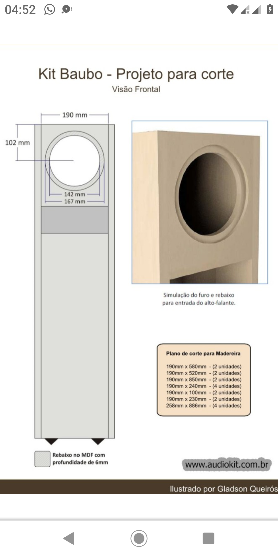

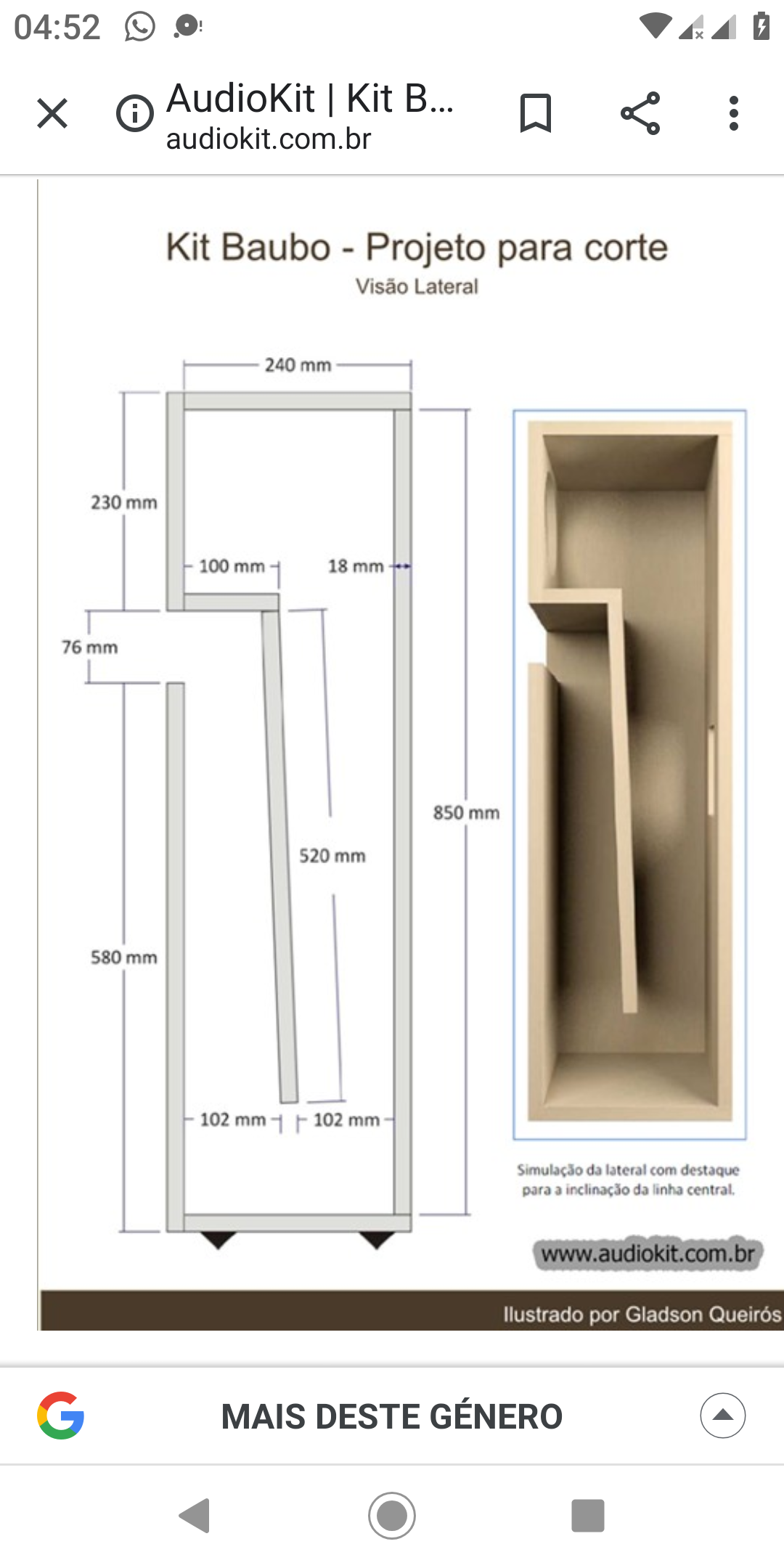

The 220mm limitation on the width suggests that the drivers will need to be fairly small, like the Tang Band 6.5" subwoofer drivers, for example. Using one or more of these in a slot-loaded subwoofer should work, depending on how much output you're looking for.
Maybe I am asking for something that is difficult to achieve. It seems that what I am going to end up with is effectively a floor standing speaker but with only bass units. This is no too much of a problem as I am only looking for some bass reinforcement and not ground shaking home cinema bass. I have recently had to (temporarily?) retire a pair of floorstanders and have bought an oldish pair of mission bookshelf speakers out of retirement. I am really just trying to regain some of the low end I have lost.
