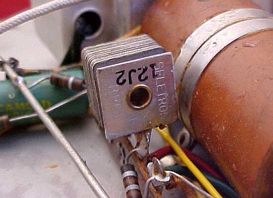

Hello,
I popped open a tube amp of mine to take digital shots to use for my summer project.
There is one type of component that I am not familiar with. It is the metal, square shaped thing pictured below.
This is placed in between the power source and the tube.
Any clue? What does it do?
Thanks in advance.
Darren

As part of this project I want to replace all the parts that are not good. Capacitors have to go.
Should I replace this component with a new one or should it be okay?
Darren
(who knows nothing about recitfyers)

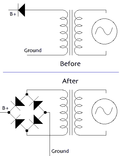

Most assuridly yes... if it is just a single (half-wave rectifier)you probably want to replace it with a bridge (full-wave rectifier ie 4 x IN4007 would do)
It will have less noise & hum, and you will avoid the not that all uncommon phenomenom of the selinium rectifier depositing its guts all thru-out your amplifier.

Thanks for your answer.
You said "full-wave rectifier ie 4 x IN4007 would do."
Do I put 4 of these in series in place of the original?
I see Digikey.com has many types of 1n4007. Which is the best to get?

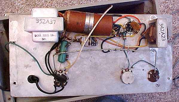

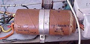

Here is another part I have questions about.
It appears to be a four-in-one type of capacitor. Picture is down below.
Two out of the 5 leads go directly to the tube, one goes to ground, one to the rectifyer, and one to a resistor > tube.
It is a 60-60/40/25 mf capacitor with voltage values are 250-250/200/25.
Do I replace this capacitors with 4 equivalent Electrolytics?
Darren

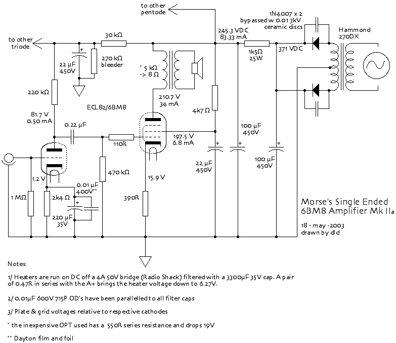

Here is an article i did on a simplier, but similar amp with scematic & pictures, look at the power supply
http://www.t-linespeakers.org/tubes/SEP_50EH5.html
Yes, althou there are some places where you can get multipart elcos for restoration purposes.
Before you do anything you want to trace out the circuit (this is a very valuable learning experience)

this scematic of Morse's 6BM8 amp (there is a whole thread on it) will be roughly the same as yours (at least in terms of where things should be -- values may be different -- your amp may well have a bypass cap in the cathode of the pentode)
dave

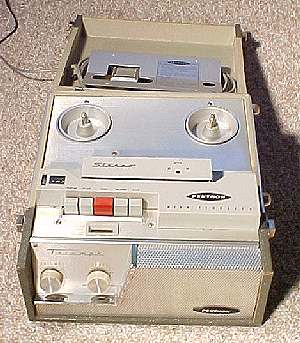

Hello,
Thanks, again for the replys. You are very helpful.
This isn't a restoration job. I am aiming to bring this stylish 40+ year old tube amp'ed Stereo Reel to Reel Hi-Fi system up to date.
It isn't worth more then $10 as it is. Other RtR recorders from the same era and by the same manufacturer rarely sell on eBay even when listed at $5.
Very heavy. Postage is more than the value of these things, I recon.

Back to the rectifier thing. Do I solder all four of these in series?
Can someone show me an example of how this is done? I am ordering those parts, along with others, tomorrow afternoon.
Darren
Re: Re: Re: the 1n4007 and another part
You'll need to learn to read schematics... they are the language for describing circuits...
Here is how you wire the rectifiers (each one has a band at one end -- correcsponds to the bar on the diode's symbol)
dave

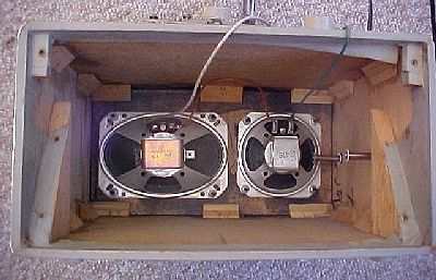

planet10 said:

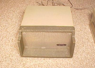

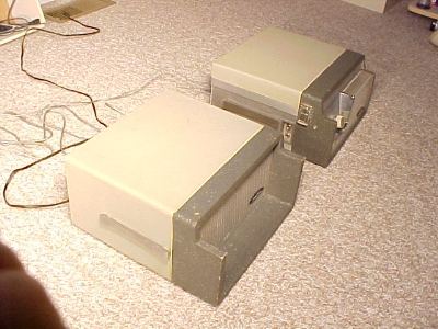

Dot a close up of the speaker?
dave
Hello,
This is quite a interesting tape machine. The Hi-Fi system comes in two parts; recorder/speaker and external speaker.
There are cones inside the recorder that are amped. They serve as the left channel.
On the back there is a line output that connects to the other amp which amplify's the right channel.
The circuit that I want to start with first is this external right channel amp. It is the one that I took the inside photos of that are shown above.
Darren

Centauri said:
How many connections are there to the selenium rectifier? (Some have two, some have three, others have 4). Which connections go to the power transformer, earth (ground) or capacitor positive terminal?
Even a rough drawing may be helpful.

Hello,
I am puttiing the project on hold until the IN4007 parts arrive.
Should be a week from now or sooner.
The old rectifier has two connection points, as shown in the scan at the top of this thread.
I'll draw something up later but it exists between the first transformer and the tube.
Here is the lineage
Transformer > recitifier > resistor > pin 7 of the tube.
BTW, I just ordered some of the recitifiers. 1N4007 made by Fairchild Semiconductor. Can't beat the price. $.05 each.
I hope these are the right ones. If not, it is no great ammount of money lost.
