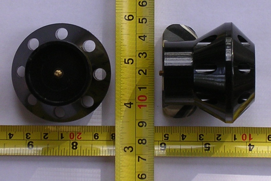

My Dear Sir,
Keeping in mind your valuable advice...
You are acquainted to thousand times of more enthusiats than myself does. Might a few of them own this phase equalizer plug and be kind to measure and share its dimensions?
I would be grateful!
Sincerely,
Cagatay
I have tried Lowther EX3, then I stripped the drivers to DX3 and tried them in BLH with original Lowther plastic plugs, no plugs and DIY oak plugs. With my horns and room I prefer the sound (by small margin) of oak plugs and I like the looks.
In my opinion Lowther plastic plugs are not worth copying - the picture may help you to make different DIY plugs.
http://www.diyaudio.com/forums/full-range/199884-stojek-horns-diy-round-blh.html
Dear marekst,
I forgot to thank you for providing that wonderful image! With the help of it we successfully cloned the new phase plug.
Thank you!
However, you're right. In my listening environment, I still prefer standard ones.
Cheers!
