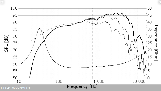

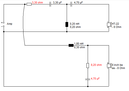

The guys are, of course, totally right that an 8" woofer can work spectacularly well here.
E0045-08S W22NY001
JA8008-HMQ
The main thing is to know a good 8" woofer when you see one. Troels remarks: "To my ears, this is the best speaker I've ever made."

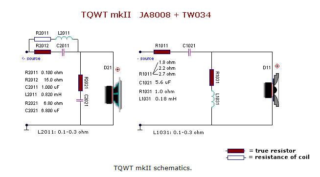

DTQWT-mkII
Not much to the main section, if you regard the twin bass reinforcement as a bit of iceing on the cake. I like this sort of thing myself. 😎
