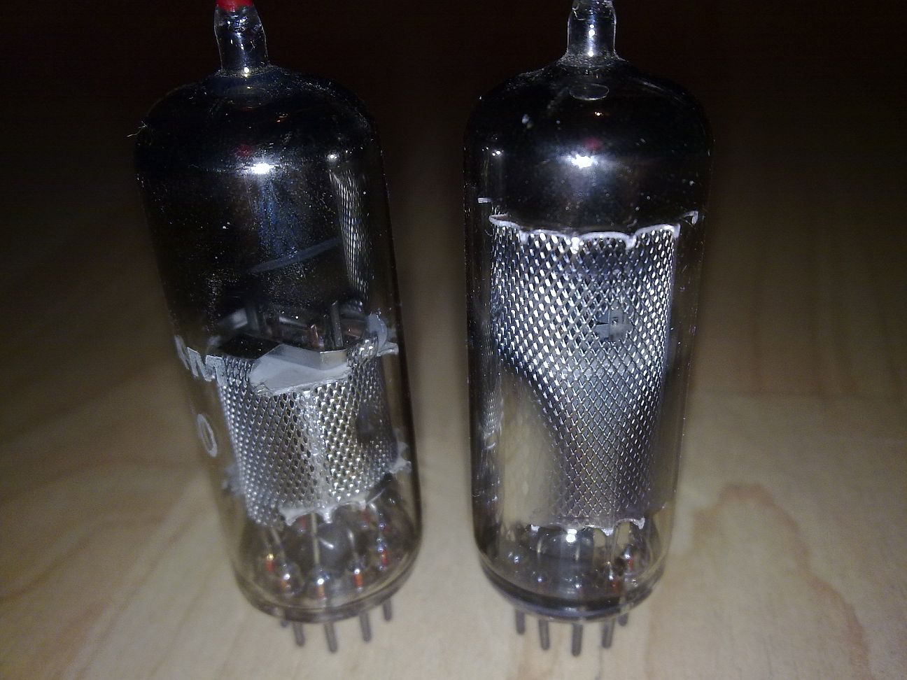

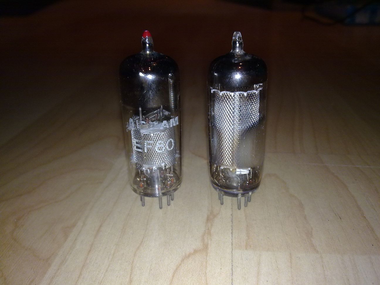

What tube is this?
I cant seem to figure out what tube this is.
It has the philips etching code, but the top row (wich indicates tube type) is unreadable.
It looks like an EF80 but the inner cunstruction is twice the size.

Some German EBF89 look quite different, as they have a solid grey screen. I think of them as a Siemens type, but I may be wrong. The one you have looks like a modified Philips type. I am not sure where the silvering comes from, maybe cathode activation? I don't think it is gettering, as that is at the top as usual.
