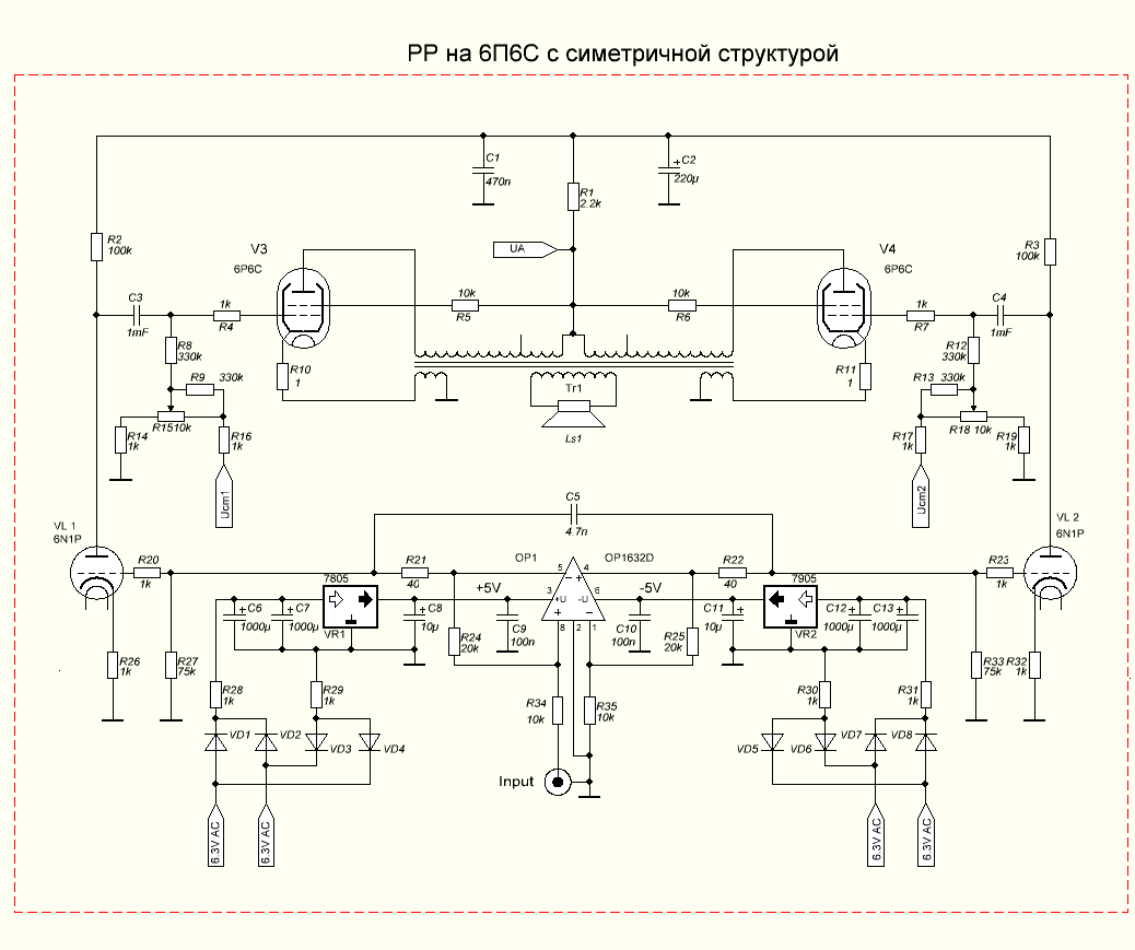

AND THEN - can a 5 watt tube amplifier with a 5% TND play a drum hit?
there will be some sound - but what kind?!!
another thing - a pen-dod PP in Class A with a power of 20 watts - there the chest will vibrate from the drum hit!
true - only on acoustics with high sensitivity with a paper diffuser
Anyway, I'll stop now, because we are talking about highly subjective things.
formally - you are right
but instead of building another triode amplifier with a bunch of driver tubes and a power of 7 watts at 4% THD - wouldn't it be better to make a 20 watt pentode Class A amplifier with 4-6 dB feedback, even on a prototype?
it's 2 times less expensive - and the result will definitely surprise you!
there is another interesting option
