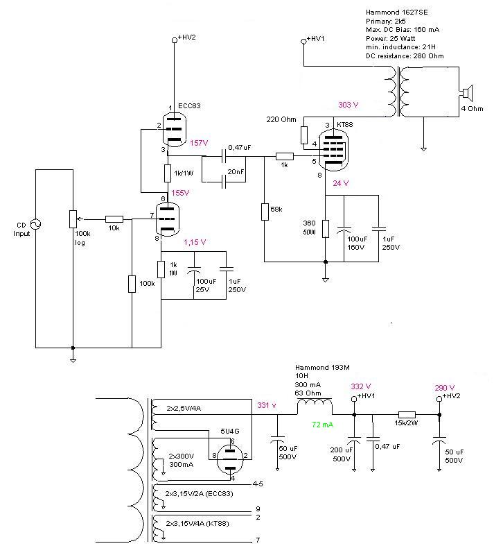

Hi Jon,
Here I enclose the schematic of my first tube amp (my second one is going to be a 300B). It uses a KT88 in triode mode, ECC83 in SRPP configuration as driver, and a Hammond 1627SE output transformer. This components are not difficult to find.
If you are interested in this one, I will give you further information.
Good luck
