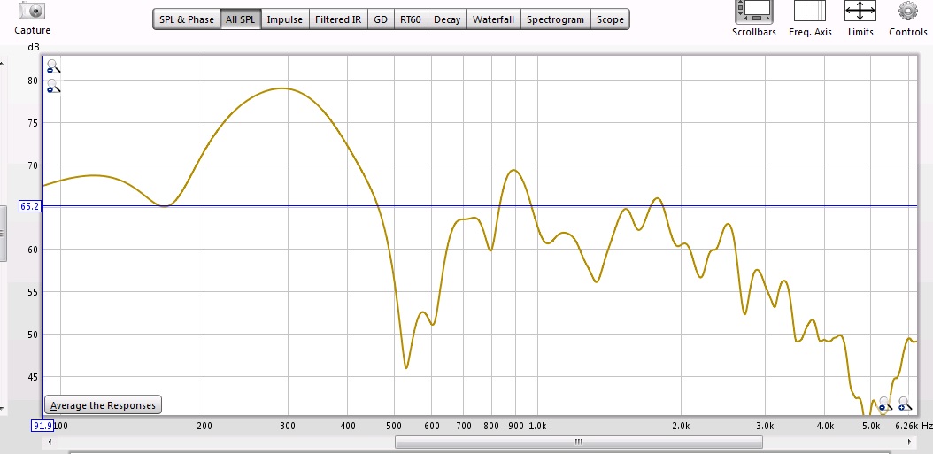

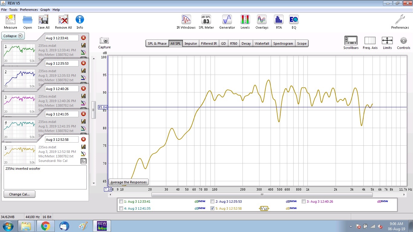

Scott is spot on. I have 2x12" woofers in a W frame.
First pic is the woofer only with no XO, the resonant peak is at 300Hz. Second pic is with the XO set at 225Hz 24db/oct to a MarkAudio Alpair 12P.
Both measurements are taken at 1m from the centre of the 12P on axis
My speakers are biamped with a DSP to set XO then I build an active line level XO.
I have a UM-1 calibrated microphone, and it has taken a few years of tweaking to get these speakers sounding AMAZING.

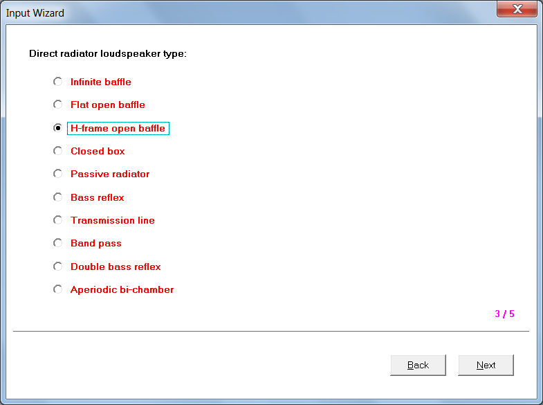

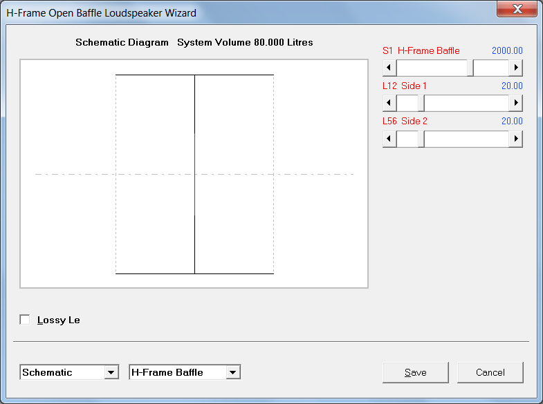

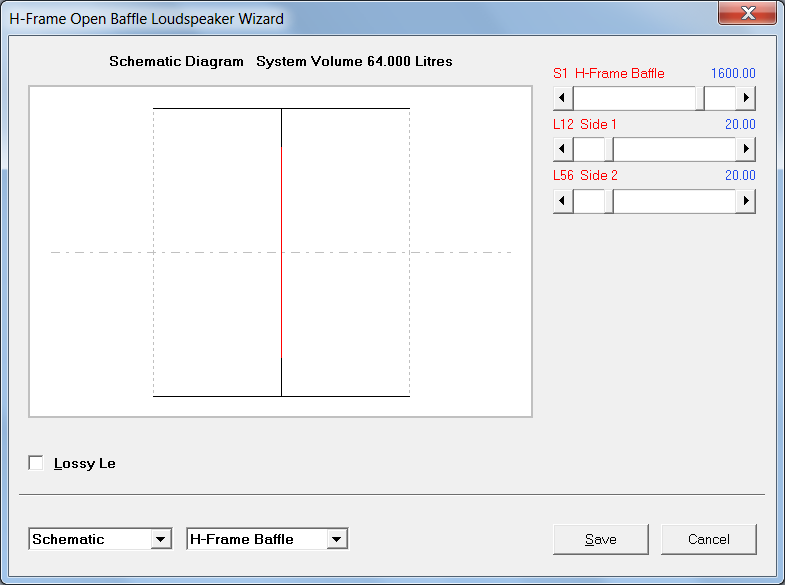

Any good tools to help design this?
Hornresp can now simulate H-frame loudspeakers.
Is there a dummies guide on how to set up for H Frame?
Hi David,
Not that I am aware of.
You can however use the Input Wizard accessed from under the Help menu to specify the generic H-frame example, and then open the Loudspeaker Wizard and adjust parameter values to suit.
Kind regards,
David
