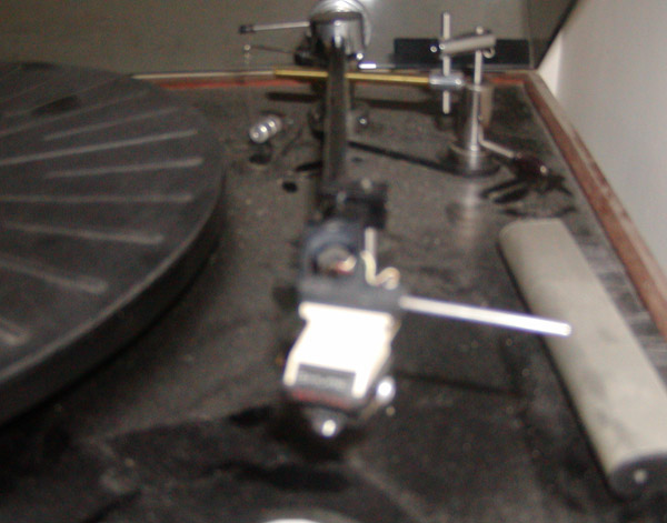

I had this old rega planar 2 in my basement. I got it with a pair of speakers I bought ages ago from a guy who got married and his audiophile life ended. Then I more or less forgot about it. even though when i was younger i always wanted one 🙂
Now its time to refurbish it.
It has this tonearm. i don't know what it is. (sorry for blurry pic) it has a needle point pivot. is it any good? i also have a rega tonearm somewhere loose and im not sure what condition its in but it looks like this one has had special holes drilled for it. i would prefer to leave it on as long as it not a total POS!
Anyways for the anti skating it has a little weight on a piece of fishing line and it touches the plinth of the turntable untill its about half way across the record. obviously it is not correct. if anyone knows what arm this is i would be grateful on any pointer on how to set it up.

A hadcock it is. I sold those new & have one downstris in need of rewire. The new ones are better detailed and have better fit & finish, but this is still an excellent arm. I preferred it to the Graces & the Maywares we also sold at the time.

Planet 10 do you have any idea why the line seems to be too long. could it be the original owner set it up wrong or replaced it
may be the outrigger thing needs to be set up somehow? nothing looks bent or out of place, just the line seems too long.

Hiya there is a Hadcock instruction book avaliable from the UK distrubtors www.hiaudio.co.uk this manual covers complete set up and of course some tweaks as well.
This arm is a VERY early aluminium tubed Hadcock! The new ones have a stainless steel armtube and have done away with the compliant rear stub mounting.
