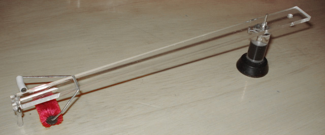

Then there's the Watts Dust Bug, or its modern equivalent, for collecting dust which lands on the record while it's playing.
