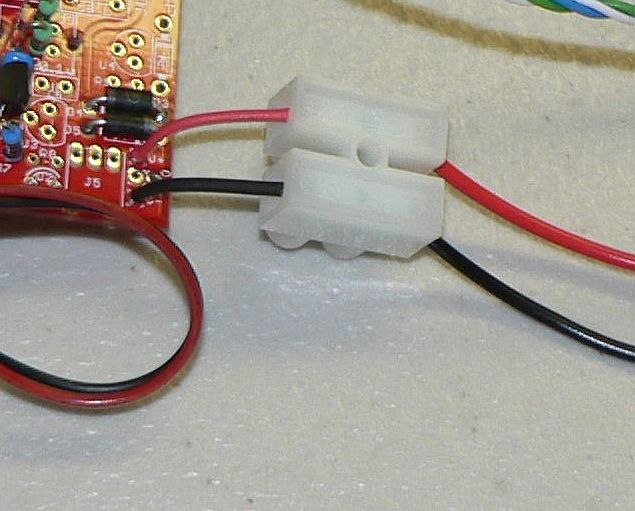

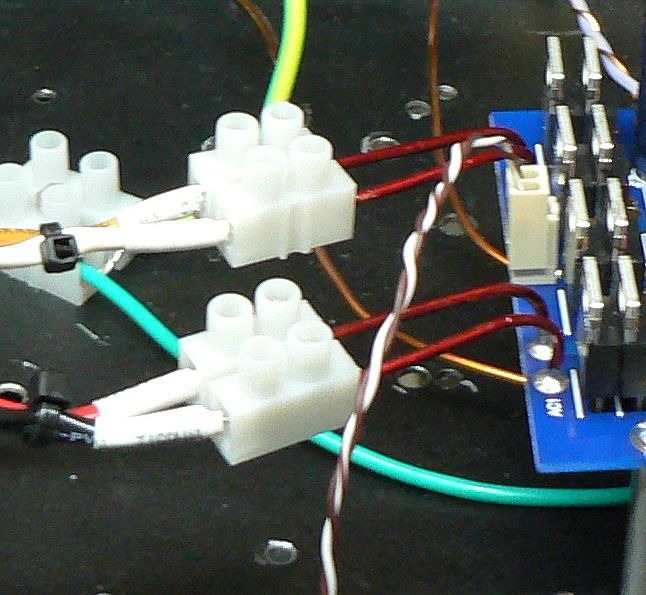

On odd spacing I've used inductor wire soldered to the PCB and then a terminal block added. I like mechanical connection to the PCB as makes it more friendly so you don't end up with an octopus. I mostly use 1.5mm inductor wire but have used smaller depending on the PCB holes.
