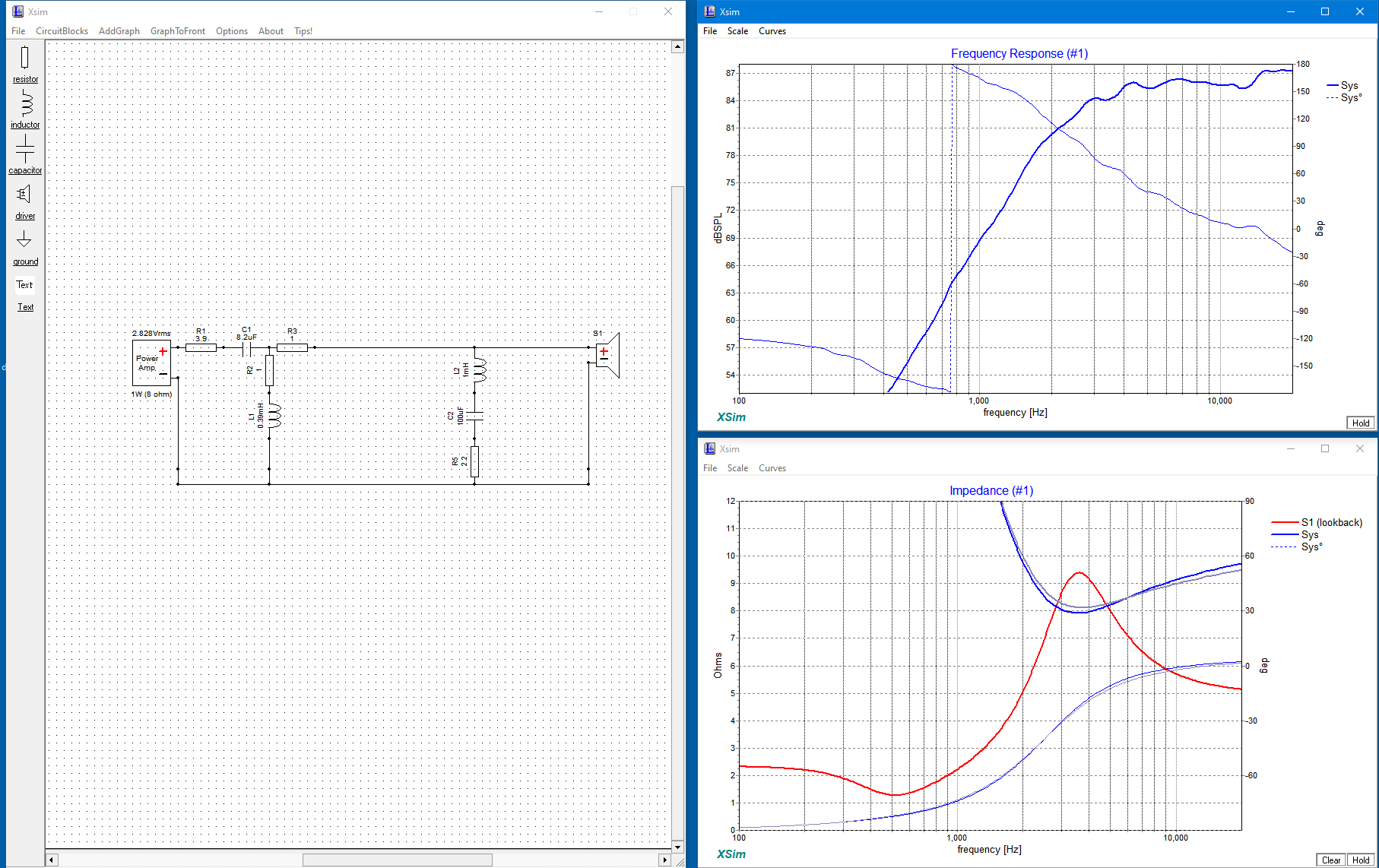

I am new to designing crossovers.I downloaded xsim, and am currently playing with a downloaded frd and zma file for the scanspeak d3004-6600.

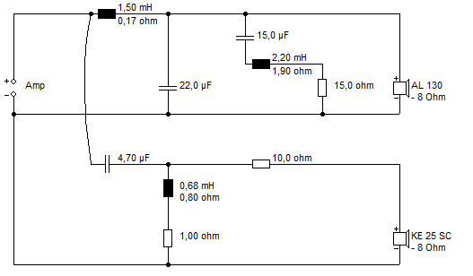

Starting point was a crossover from Troels Graveson (screenshot attached). I was wondering why he did what he did, and played around with the components.

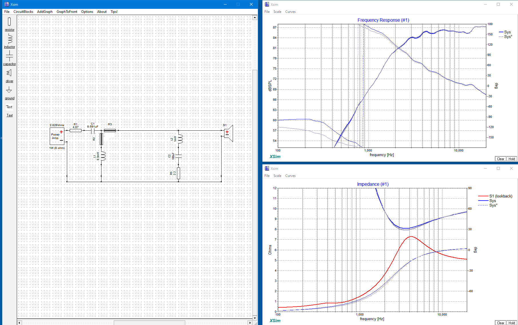

It turns out that it was quite easy to manipulate component values, adn topology too, without significantly changing the frequency response. This is unsettling since it means that manipulating the FR to a desired shape may lead to many, more or less, identical solutions.
I have also been looking at other parameters such as system phase, system impedance and also lookback impedance, but I don't see anything more desirable between the 3 solutions.
So, my question is, how do you know the when filter is optimal. What should I be looking for. Is there a good book on this?
It's easy as you've found to hit a target acoustic frequency response curve with one driver. All you really have here is a filter - not a crossover. There is no other driver in the system.
However, assuming you want to build a multiway system - will the phase response match suitably when you pair it with another driver to net you the desired frequency response both on and off axis through the crossover region?
So adding another driver - that's where it gets trickier.
Plus - your source FRD is likely missing baffle / enclosure effects. The 2 key being diffraction ripple (which can be lumpy for your typical 2 way speaker for the tweeter between 1KHz and 3KHz depending on baffle size and tweeter placement) and baffle step - the frequency range where a woofer transitions from 4pi to 2pi radiation with increasing frequency (6dB rise). Without taking account of the latter - you end up with a "bass weak" speaker.
The last point - unnecessary components or values so high / out of range they have no effect. Take your series impedance compensation circuit. 100uF cap and 1mH inductor. I'd garner these are useless. Impedance compensation is really only useful if you must have an even impedance load (low phase swings) for your amplifier OR you are crossing the tweeter near it's resonance frequency (a bad idea anyway) and you need constant impedance for your crossover transfer function to be maintained.
So - remove that impedance compensation and see if there is any impact.

What was mentioned a few times turned out to be true: I also added a woofer, and, indeed, even though the FR for the tweeter is identical for every variation of the high pass, the crossover to the woofer was different for each version. This hadn't yet occurred to me (seems very obvious in hindsight, but learning often works like this).
So, the take away is to focus on the target curves and optimise the crossover between the drivers. (and make no stupid mistakes like creating super low impedances etc.)

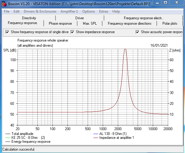

Thanks for the link to boxsim. Does this software also work with actual FR and impedance measurement data? That's what intrigues me in xsim: in theory the results should be dead on (provided I do my measurement very well, which does NOT seem easy at all).

I assure you Boxsim can do it:

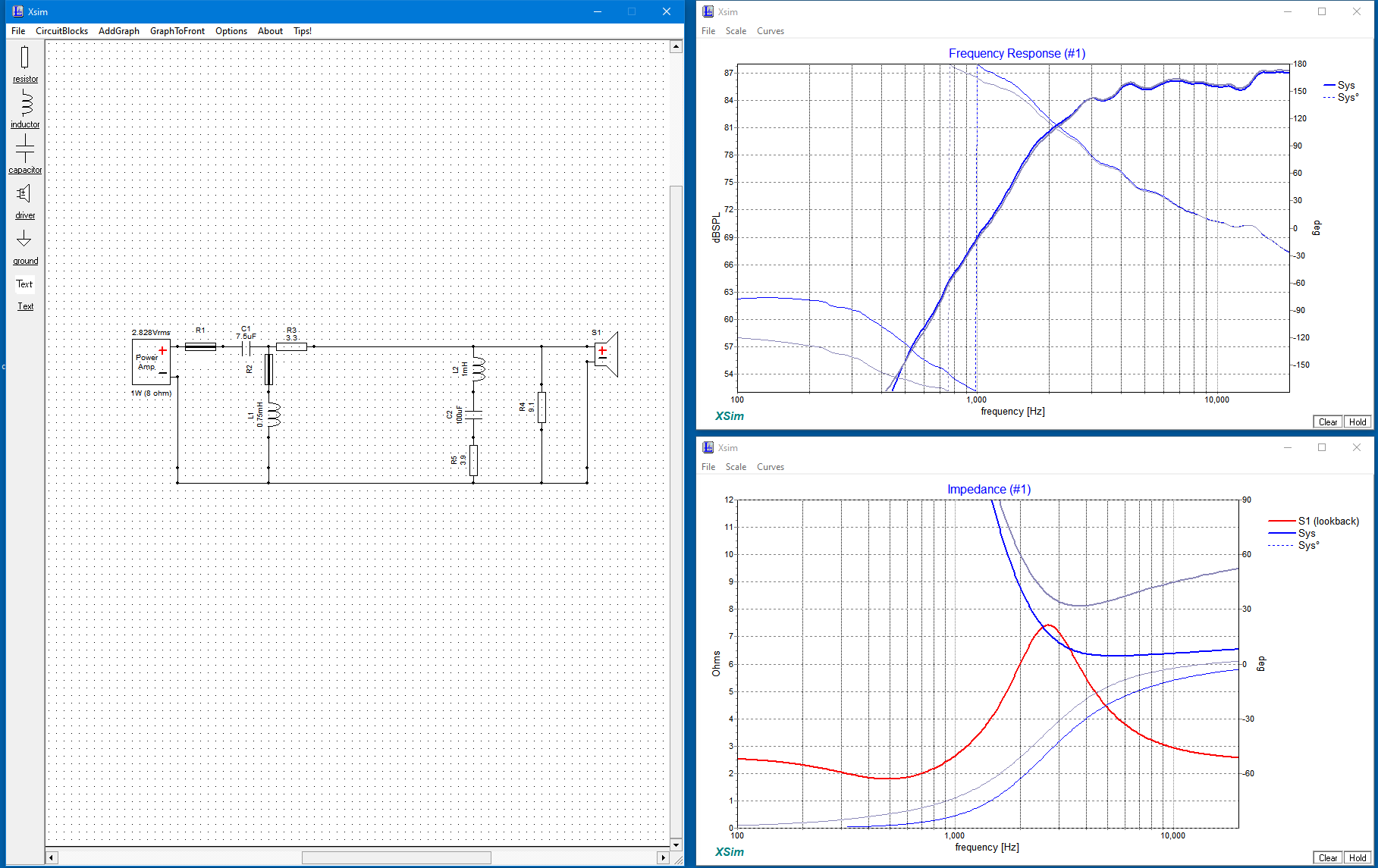

Steve, are you talking about the driver impedance as a result of its own actions, or the source impedance as seen by a crossed driver?
When I use a word like back-impedance, like the Red Queen, it means exactly what I choose it to mean... 😀
But I mean the impedance the driver sees looking back to the amp.
Here what the tweeter sees in a regular metal 5" plus 1" looking back to a voltage amplifier. Surprising, eh? 😎
Yeah, this is what I meant. Calculating this ain't rocket science me thinks.
So, do we take this into account? My assumption has been that near the peak the driver might not behave as we hope.

So now we have mentioned circuit impedance from three positions.. the driver internally, the driver source, and the speaker externally as seen by a Voltage source amplifier. The ensuing conversation would be quite different in each case.I am not sure source impedance matters much, after all, Harbeth speakers have horrible impedance:
Hi Allen,
Yes, the discussion would get somewhat diffuse. My concern has been the impedance that the driver sees on its terminals.
I am not an expert on moving coil systems, but my midrange has a Qm of 13, which means there is very little mechanical damping (if I understand the parameter correctly). Hence, the system (which is at least 2nd order, which we want to bahave as a zero order) would to be relying mostly on electrical damping. At the given frequency, the impedance of the source is very high, and, hence, insufficient damping.
My reasoning may be flawed. As I said: these are my first baby steps in speaker design and I am trying to learn what is of importance.
On a side note:
Another thing that has worried me is the behaviour of a driver that is filtered by only a inductor (say the same midrange). In the frequency range above its resonance frequency (in my case 300 - 800 Hz) the voltage at its terminal is actually higher than the input voltage of the crossover. The effect is probably caused by the capacitive nature of the driver impedance at these frequencies, combined with the inductive filter and very little damping. The effect on the FR is little, but I worry about its transient (time) behaviour.
I have examined other designs and have never seen this effect mentioned. This could mean it is unimportant. (I know I have a tendency to make thingS more difficult than they need to be)
