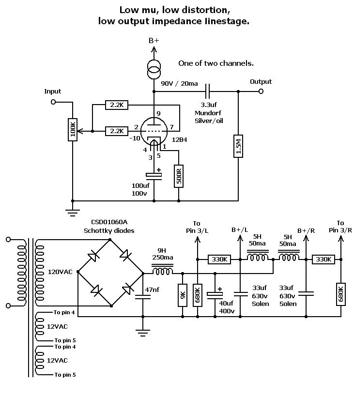

When wired common cathode, most triodes are not capable of directly driving the IHF 10 KOhm "standard" I/P impedance. An exception is the 12B4. There are more 12B4 based designs than you can shake a stick at. FWIW, I've uploaded my version of a 12B4 based line stage.
