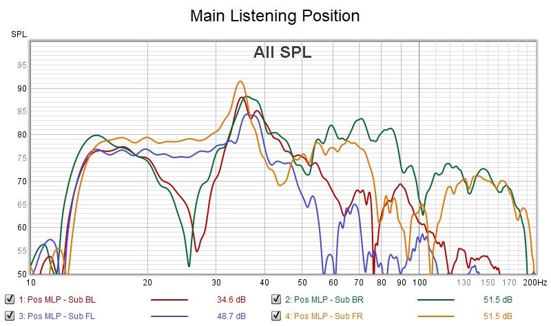

I have a 4-way digitally active system with two 12" sealed (Rythmik kits), and even though I use Acourate for room correction the room seems to be just awful and response in the lower octaves is a challenge. I'm considering adding another 2 similar subs, a miniDSP 2x4HD, and use MSO to get a more even response. I'm using MSO to simulate the corrected response, yet I wonder how accurate the simulation might be vs reality. Getting input from those who have done this, who can maybe confirm the simulation is representative of what I will get in reality, would be great.
Today I have the two subs placed on the front corners. The system is in the living room so aesthetics and ergonomics limit placement options. Room is 13' long x 15' wide x 8' high, with a large opening to the left to another room of similar size (dining room). I have a fair amount of bass traps on front and back wall, and on the ceiling.
Against the back wall there is a 3-person couch. For "critical" listening I bring a chair in front of this couch, which I call the main listening position (head about 4' from back wall). The back left and right positions are on the couch, which is where I sit with my wife/kids to listen to music/watch movies (it's a music system, though).

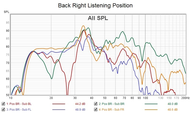

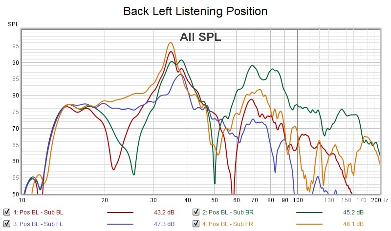

I took measurements from these 3 positions of the front right and front left subs, then moved the subs where the new ones would be located and took the next 6 measurements.
The 4 measurements of the subs at the main listening position.
Subs are labeled Front Right, Front Left, Back Right, Back Left.
See how the FL sub drops above 40Hz. FR makes it to 70Hz and drops off a cliff. The room mode at 35Hz is quite noticeable.
Note the hole for FL and FR in the 45 to 65Hz region.

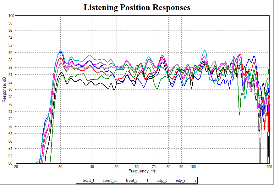

So I bring the above into MSO and get this initial summation at each listening position, uncorrected:
Don't know that it sounds as bad as it looks, but it does look ugly.

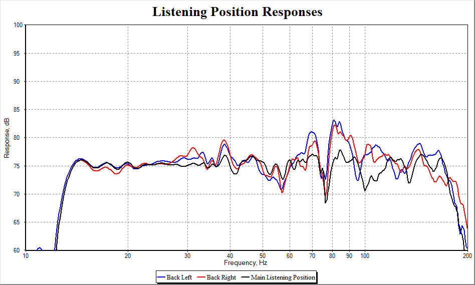

I ran an initial correction, and after 30min:
This is looking much better. Still issues in the 65 to 90Hz region, but much smaller issues than before. Maybe crossing this at 65Hz will do the trick (to open baffles). I was estimating a xo at 80hz or below anyways. Would need to experiment.

If you spend some time reading the MSO thread at avsforum, you'll see many people amazed by MSO's predictions. And the people that aren't amazed usually just have configuration issues with their AVR, for example. For me, the prediction was spot on and the improvement was the best thing I've done for my 2.2 setup.
Before you get another two subs I'd try running MSO with your current setup, if you haven't already. As you mention, the front position responses seem to drop pretty fast, but if you position the subs at FL and BR (for example), I think you could get a pretty good combined response. You might want to measure some more listening positions for best results. You could, for example, measure the left and right side of your listening chair instead of a single position at the middle. This way you also increase the weighting on the chair a bit without making the software overfit things. Also make sure to make a few copies of your configuration in MSO and run the optimization separately for each. The results can vary quite a bit, as the optimization can get stuck in local minima.
You can also play around with the crossover frequency limits depending on how much your mains require help and how much you can sacrifice imaging. Try different PEQ boost limits too, depending on how much headroom you have in the subs. I also had better results by allowing different SPLs at different positions and by including my rather bass-heavy room curve. The latter is not recommended by the author because it might make it difficult to apply a new room curve without running a new optimization, but I take a moving mic measurement of my combined response after applying MSO to apply a room curve anyway so it's not a problem for me and reduces the total amount of filters, for what it's worth.

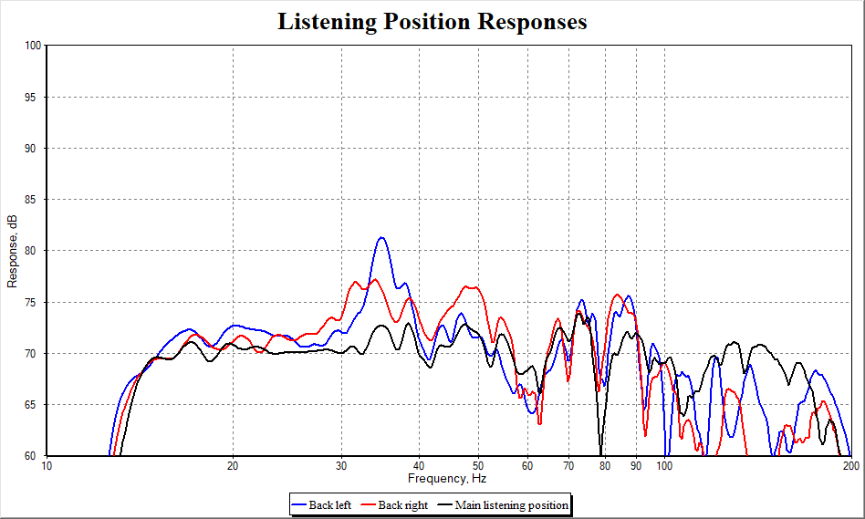

Here's the simulation optimizing for 3 subs: front right and left, plus back left. It's an improvement over the baseline, but quite a bit worse than 4 subs. I was kind of expecting less difference between optimized 3 vs. 4 subs, mostly from comments by Earl Geddes and others. Maybe more tweaking of MSO parameters is in order?

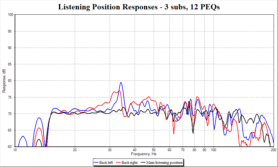

Wanted to follow up and thank you for the input. I went to the avsforum MSO thread, and while 170 pages of thread are intimidating, I did some reading and found a great reference for how to go about choosing the number of PEQs. I had been using 4, per the tutorial. I now know I have 12 axial modes below 110Hz, so I tried the 3-sub simulation with 12 PEQs, shown below. I'm including the 4 PEQ optimization as well, for reference. Same 3 subs. Still room to improve, but much better result.
More reading and experimentation in order. Will try with 4 subs and 12 PEQ.

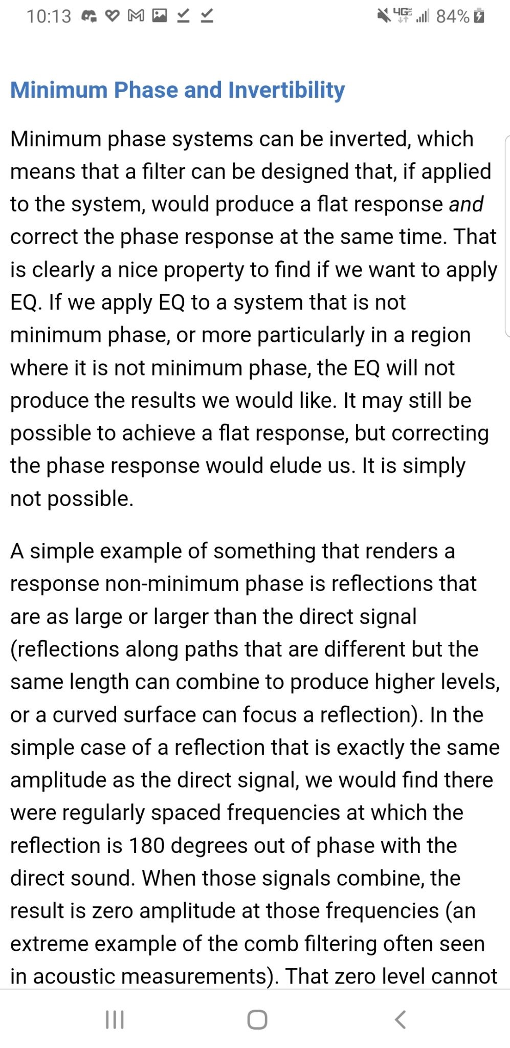

I have no experience with mso.
However, if i was concerned with response below 30, personally id like to see some boost (not flat response) in the infrabass to compensate for our rapidly decreased hearing sensitivity in that range
Also my experience with eqing room modes has been so so. Refer to "minimum phase" phenomenon
https://www.roomeqwizard.com/help/help_en-GB/html/minimumphase.html#top
