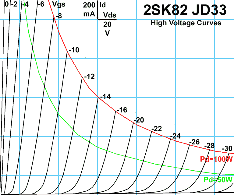

I've seen Sony curves up to -240v, not sure on maximums though, have you seen anything on this?

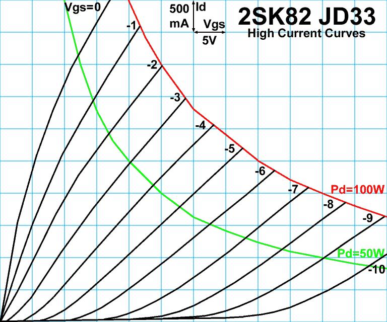

Thanks, 240v as a maximum for now. Here are some graphs of the high voltage curves, which look pretty evenly spaced. MR's Luminaria article has even more info, including the lower 1500 pF capacitance at >80v , if you're updating the simulation

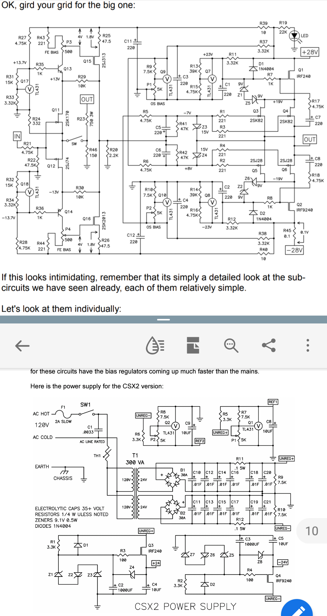

Speaking of Vfet output stages, I'm working on a CSX, and wondering if anyone has already discussed the similarity between CSX2 (Common source) and the VFET2 (follower) output.
The idea would be to switch the CSX2's 220uF capacitors from the output reference, to the VFET2's front end's ground-reference, and then flip the polarity of the lower transformer coil. It just looks like the topologies were asking for this.
Inspirational pictures attached:
coincidentally I was wondering the same.
Did anyone see a discussion of the CSX2 or the Vfetron ?
