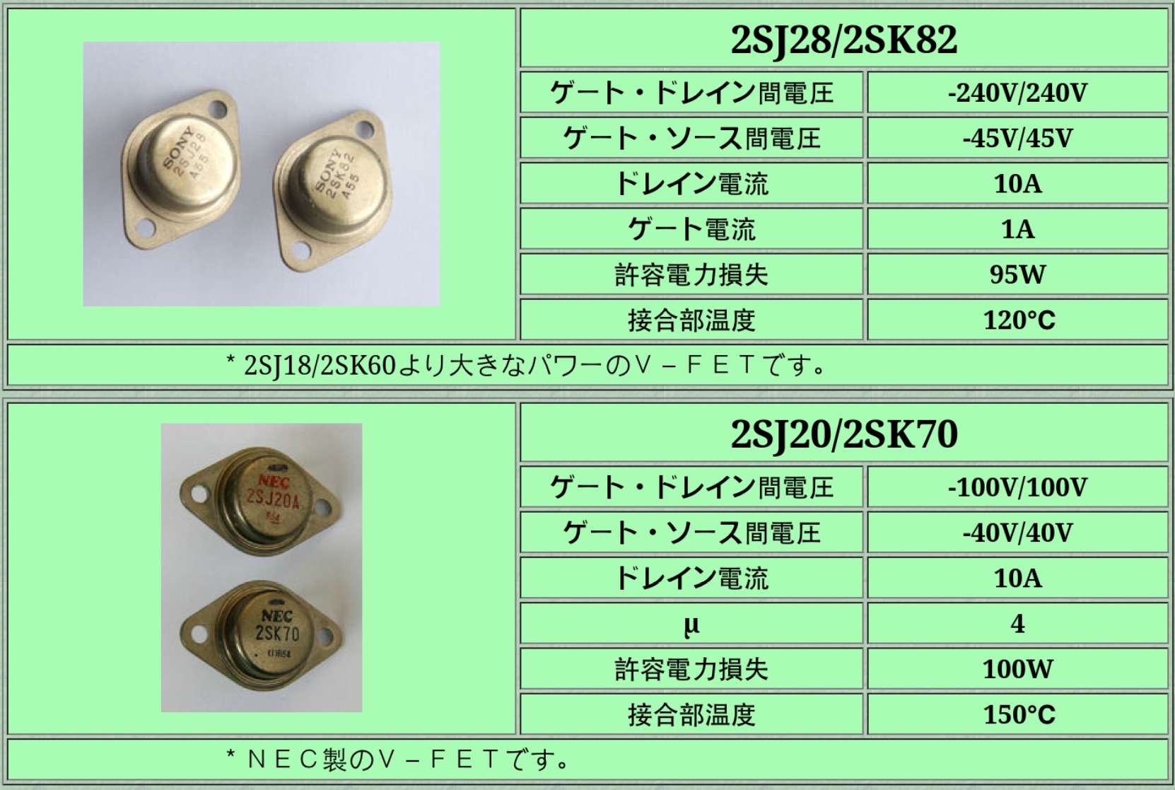

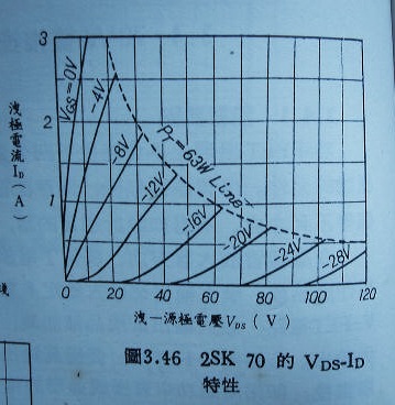

Has anyone found an N ch device that plays nicely with the 2SJ28 for use in a DEF amp design?
Other than matching gate voltage in order to self-bias, what would the needed parameters be? Is finding a suitable candidate simply a case of combing thousands of data sheets to find one?

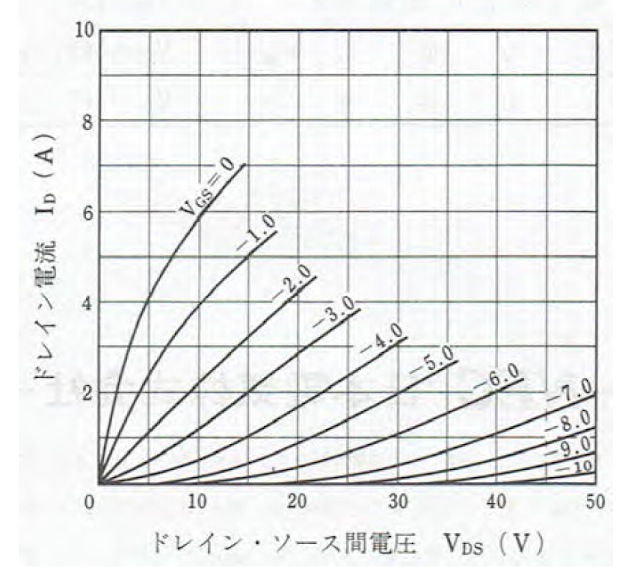

Unfortunately the ones I have have Vgs starting at -8 volts or so and
go up into 11v, so it's tough to find a match. You would have to consider
a bias circuit.
There is another unrevealed trick in the SIT-3, but I haven't tried it with
such an extreme Vgs difference.

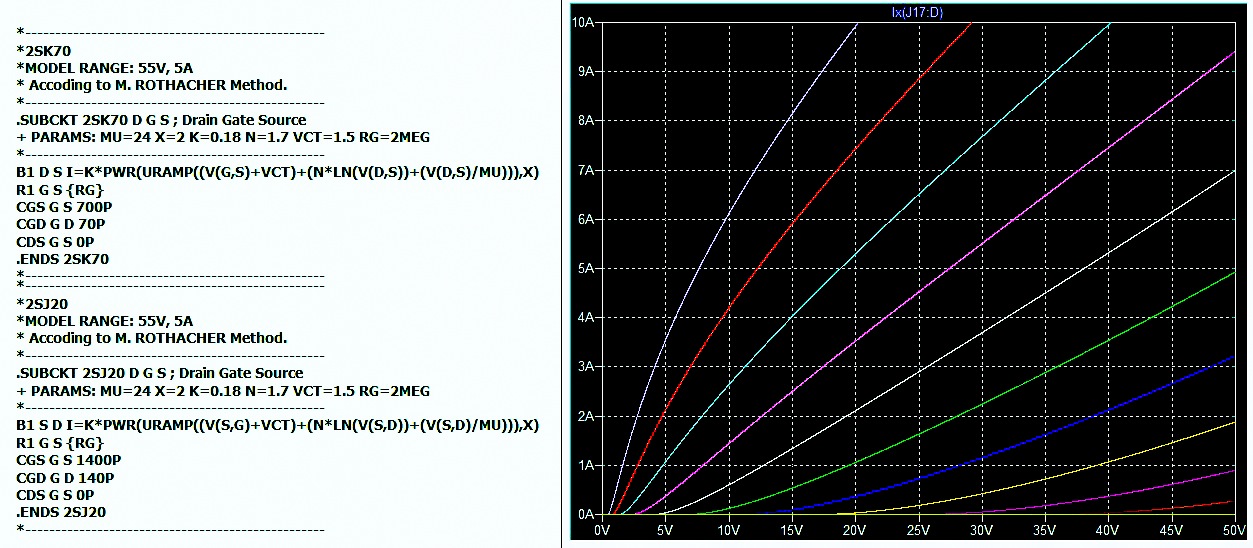

Curves of the N channel part 2SK70 and some LTSpice models linkGot curves?
Are they available?
How many are you going to send me?
オーディオ自作賛歌 : SIT NEC製 2SK70/2SJ20の特性とSPICEモデル

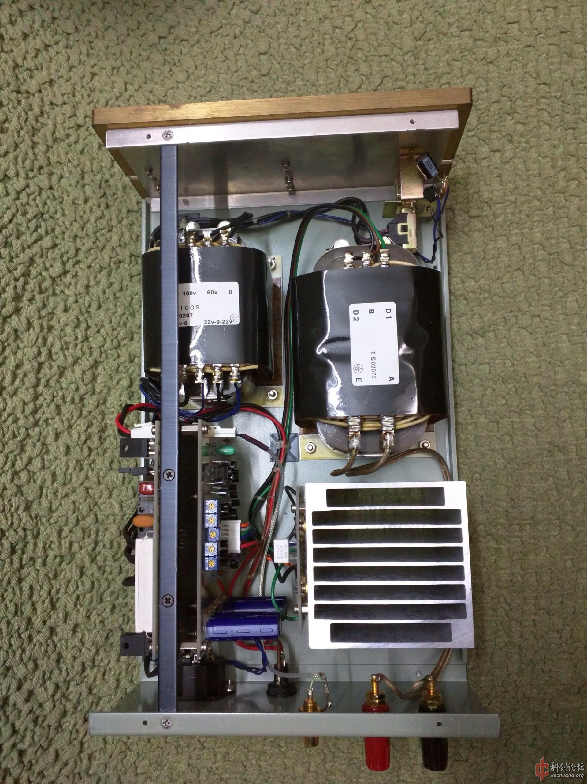

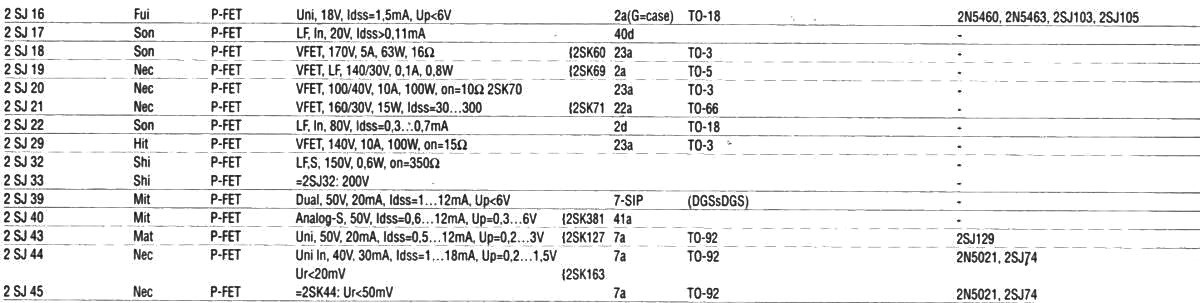

I have a few of those NEC vfets (Ns and Ps) all tested good.
There is a chart somewhere in diy audio forums which shows their operating characteristics are very close to Sony versions..

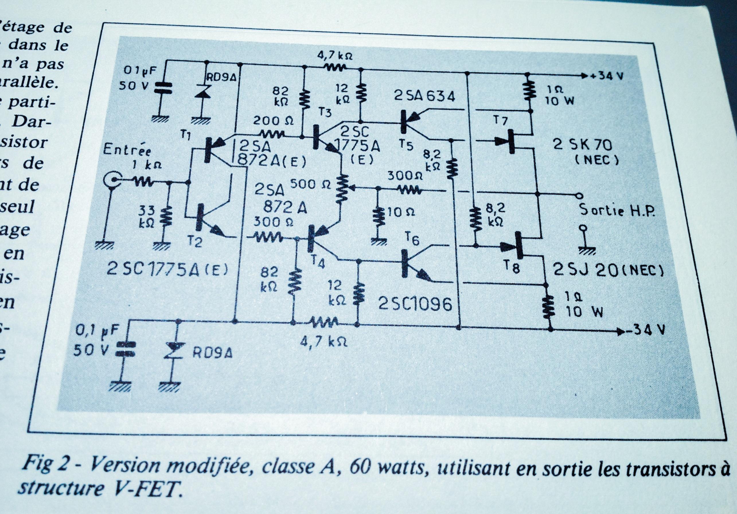

In 1979 Mr. Jean Hiraga published article with amplifier schematic for NEC V-fets.
Christophe, that one is a ticking bomb.In 1979 Mr. Jean Hiraga published article with amplifier schematic for NEC V-fets.
... Jean Hiraga fell into this trap in his conceptual drawing of the 30W class a with 2SJ20/2SK70 VFETs, and in fact introduced another problem in form of potentially fatal cross-conduction when clipping because of simply shoeing in VFETs where BJTs used to be....
