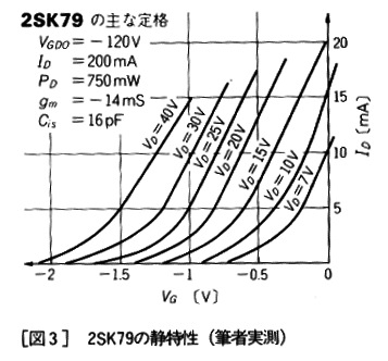

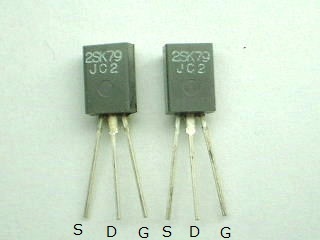

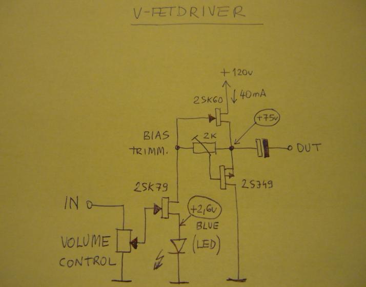

I don't see many designs for small SIT's Sony 2SK79 , they matched pairs are available
http://www.diyaudio.com/forums/vend...-rare-toshiba-transistors-18.html#post5053635
With two 2SK79 matched pair can we build useful front-end for stereo 2SJ28 DEF power amp stage ?
http://www.amplimos.it/images/2SK79_data.pdf

So, I gather there are a number of orphaned Sony 2SJ28's out there,
so let's use this thread as a scratch pad for ideas to put them to use. 🙂

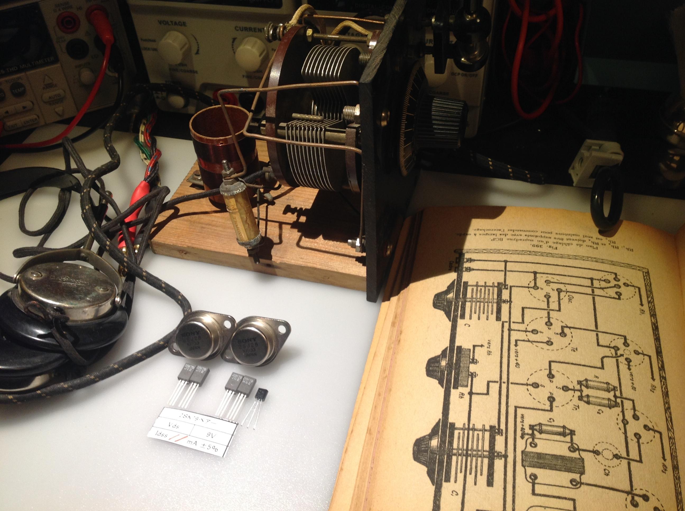

Something to amplify antique radio oh just joke !
Anyway create from the orpfans one family.

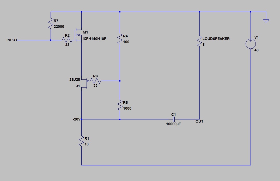

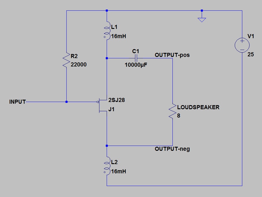

4 parts and a power supply constitutes a feed forward error correcting (SUSY-ish) power amp with very low levels of distortion. 2 X voltage gain.
It has a very good damping factor, due to the feed forward EC and the NFB.
If the 2SJ28 needs a gate resistor then the amp needs 5 components per channel plus a power supply.
L1 and L2 are two windings (bifilar) on an aircored choke. Since they are very close magnetically coupled together they will force the two outputs to closely follow each other in anti-phase (hence the SUSY-"ish" feed forward error correction).
Cheers
Johannes
I simulated this amp with an IRFP9240.
11.2 volts P-P output with 0.10% THD into a resistive 8 ohm load.
A nice balance of the harmonic content in the FFT graph.
All this is a simplified simulation, and should only be taken as a crude approximation of a real amp driving a real load.
Johannes

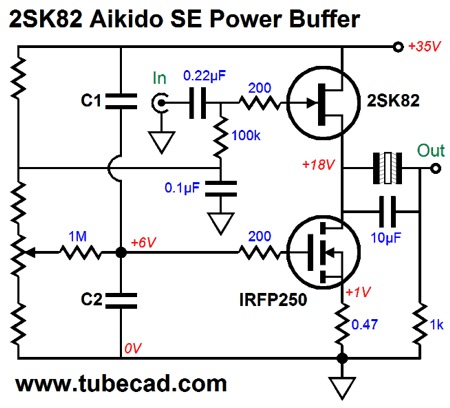

We could approximate one by flipping a couple of the polarities in the behavioral model like so. Close enough for government work. Don't try to land a probe on Europa with it. 🙂
As presented, it's simply a mirror of the 2SK82, feel free to adjust to taste.

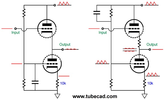

Adapt elements from John Broskie Aikido mojo logic but for 2SJ28 stage with circuit who self-cancel his noise ?
