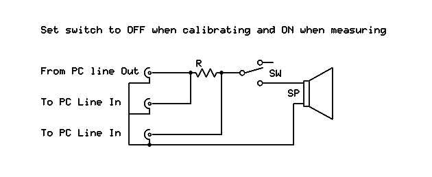

1- Does anyone in here have any info's about its T/S parameter?
2- What can I do with this pair of drivers?
3- What type of enclosure would you suggest ? ML - TL - HL or whatever ?

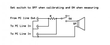

We are all assuming the T/S parameters are going to be rather hard to find...& myself I can't seem to locate any info also. Do you have any test gear that you can rig up to get the T/S numbers?? Like AF generator, multi-meters, components, etc??
Myself....when I see these big (8" plus) full-rangers.....I'm tempted to build an ultra-simple open baffle. Especially when the T/S is nowhere to be found...and I just want to listen, I get a big sheet of MDF, cut a hole in it ....listen while I decide how I'm going to approach it. Often times I like the OB so much I wind up "jazzing up" the crude OB & let it go at that.
A 4x8 foot sheet of 3/4" MDF pre-cut at the store...I'd go 30" by 48" with the remaining cut-offs for a "footing/stand" assy. A centered hole about 2/3s' the way up.
