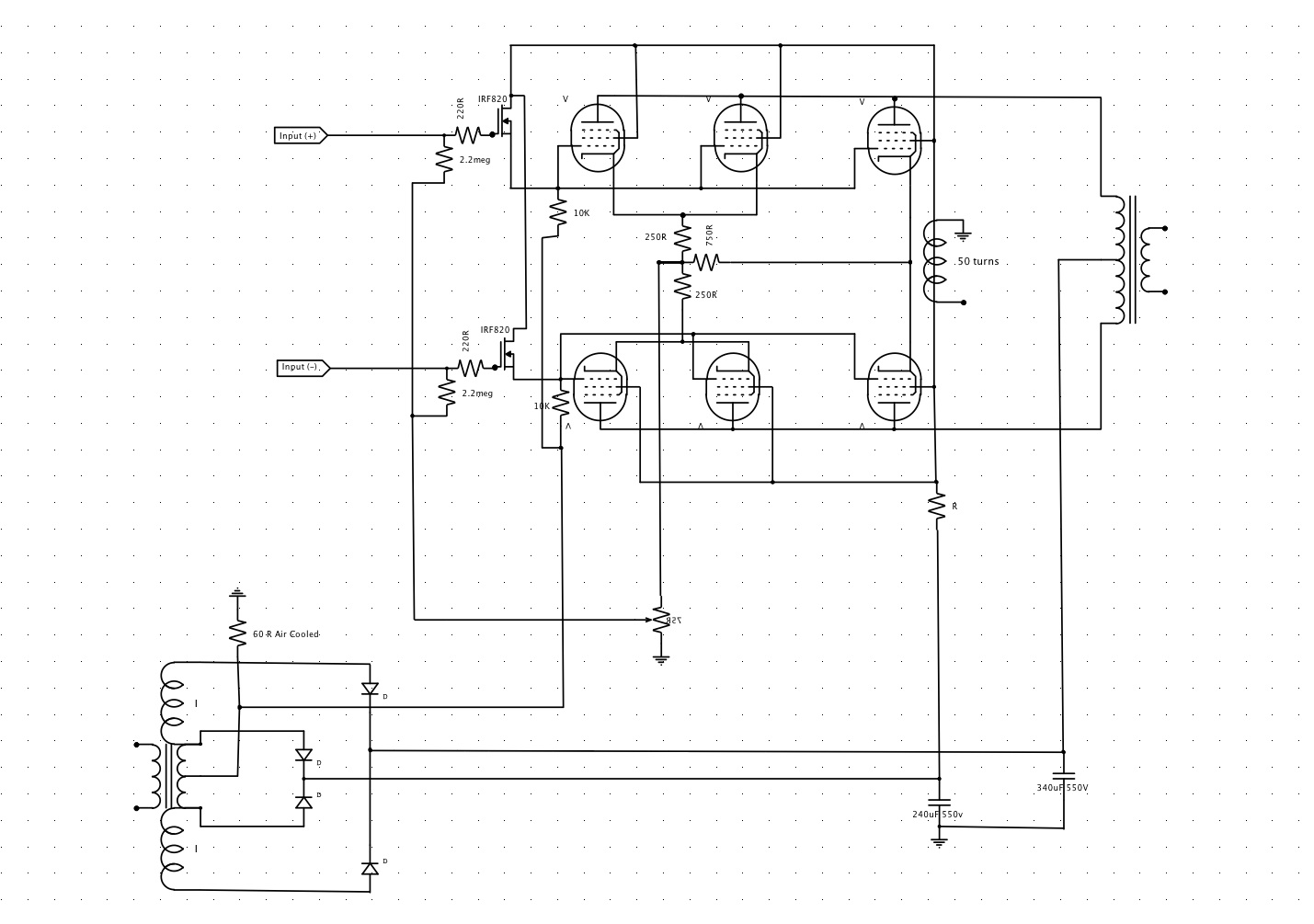

I decided on a push-pull parallel, 3x 6p3s-e per side. Cathode bias via 200-ohm resistors each all connected to a 75-ohm 1-amp ceramic rheostat (huge), which should give something like the equivalent of 0-700 ohm adjustable bias. Equal filaments per side of the 12.6 winding, second side of each tube heater connected to ground via cathode resistors (thus biasing cathode with dc and getting 6.3v per tube). Cathodes are fused at 1.5 amp per side. Screen supply is taken from inside B+ taps, not sure if I need to put resistors in like the SVT. Will probably use some form of cathode feedback in addition to slight global feedback.
Haven't quite finished designing the driver, but I intend to drive each side's grid with an IRF820 source follower, driven by a 6CG7 floating paraphrase. That leaves me with 3 noval and 2 octal sockets, probably do a push-pull 6SN7 or SE 6EM7 for the reverb. Outboard chassis with the input jacks etc has two more noval sockets. I do have a NOS 6L7 and some input xfrmrs, so a 50s RCA mic/guitar preamp ain't to far, but probably will end up with something simpler.
Power supply isn't totally designed yet, but I decided against a bipolar supply for many reasons. Plus I prefer cathode bias, it's cold lately 🙂. Solid state rectification is a certainty, into a 680uF bank of computer power supply caps. Hopefully that'll be enough. Got a bunch of 4k7s for the preamp dividers.

Alright, so I'm still working on this thing. I had tried and failed to get a 6AV5GA cathode follower to drive each side. So I swapped those for two IRF820 (actually the higher capacitance NTE knock-offs locally available 🙁 ). It amplifies music, but there are some disturbing circuit conditions I can't explain. Total plate supply voltage is 505v. One side's anodes seem to be at 660v. Cathodes are all around 45v. One mosfet seems to drive about 6v higher than the other...oscillation? The OPT is a strange beast, actually 1700CT. Center tap is white, plate leads are red and blue according to manufacturer. DCR is not equal.
I've attached a schematic of the power stage. Comments, criticism, and screaming hate mail welcome:

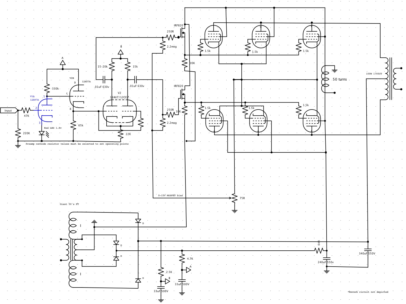

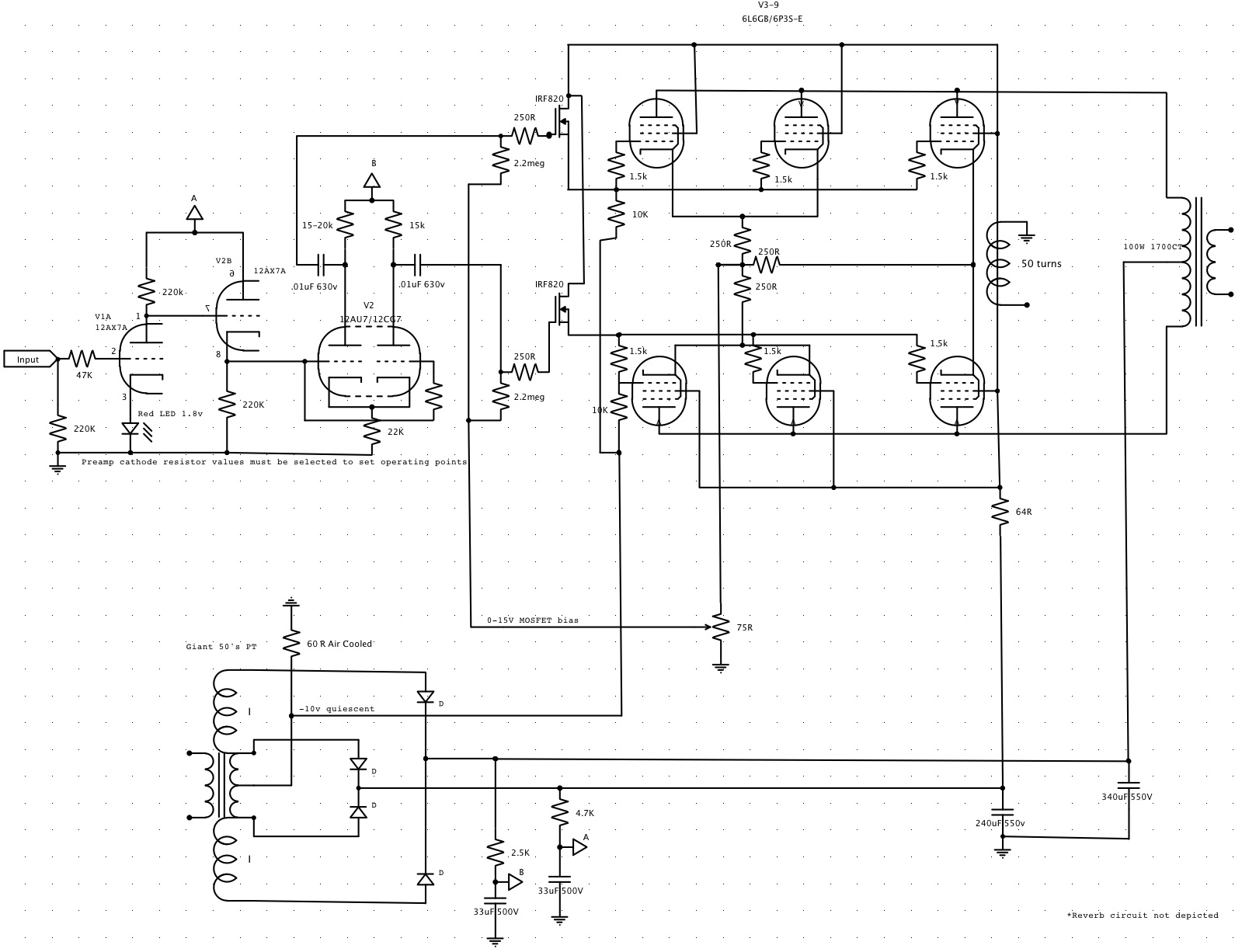

I wanted to make a quick explanation of my understanding of how the biasing works here...First off the power transformer is back biased by a giant 60 ohm resistor mounted to the chassis, near where the fan will be. This gives me a -10v quiescent supply. The power tubes are cathode biased up to 45-50v via the resistor network in the cathodes. The potentiometer (a giant ceramic rheostat from a motor controller) takes a small amount of voltage to provide bias for the mosfets (approximately 10v). The mosfet sources tie to the -10v supply through a 10k resistor. Since they are DC-coupled, the rheostat sets the Vgk by adjusting the amount of V on the mosfet gates. Current conditions are something like 20-30v Vgk after the circuit settles.
I'll be surprised if this doesn't oscillate. You definitely need grid stoppers and you may well need some small inductors in the plate leads to keep things calm.
Will grid stoppers prevent AB2/B2 operation, or just limit the power dissipated in the grid somewhat? How many turns on the plate leads do you recommend? I had plenty of space in this chassis for good lead dress, and all grid wires are shielded or twisted pair, screens and plates are twisted together (that seemed good to me, not sure though). Everything is point to point and "layered" away from each other in 3 dimensions with perpendiculars etc. No AC on plates or screens w/o mosfets, but Vgk is about 40v in that condition.
Audio sounds clear, I am using a heavily used 30w 70v PA head to drive the mosfets during testing. If it's oscillating, it's oscillating very high frequency. I'll try to rig up an RF detector for the mulitmeter and check. Not getting RF burns from the secondary or nearby grounded metal surfaces, at least! There was much less "stray" AC on screens plates etc. before the mosfets were added. I am thinking its the mosfets oscillating, and some screen related oscillations perhaps.
The plate voltages on the side where they read wrong start out at 550v, as current is drawn drop to 495, and then as the tubes turn on ramp up to about 660v. I suppose RF might read as DC to a bad multimeter such as my own.

For a normal-sized grid-stopper, there won't be much of a limit to AB2 or grid current- something like 1-2k is typical. It forms a low pass filter at the input.
The plate inductors are trickier and very much depend on layout. Sometimes, they're just used on the tubes with the shortest leads to the output transformer. A few turns around a 100R 2W carbon comp would probably do it.
Grid stoppers on the side that had incorrect voltages have already fixed the problemo. Hadn't even put in the grid stoppers on the other side yet. Ended up using 1k, since I had 5x 1.5k (one short...). Grounded the shielding on the grid wires between each tube as well instead of just both ends of the bus.

Well, I plugged in some music. The preamp schematic isn't right, the cathode follower was driving the LTP into grid current. The Vgk was -40, I bypassed all the 250-ohm resistors with 10-ohm. It's now -28 (about spec for AB2 via STC 807 datasheet, -27). I did a quick rearrangement of the values.
The good news is that it is incredibly loud, to the point where I was worrying about the survival of paralleled drivers and neighbors. The bad news is that it was incredibly distorted (imagine standing say a mile from a loud concert distorted). Some transients had a "videogame" sound to them, and some bass notes were fuzzy (feedback might help here eventually). There is also a significant 120-hz hum, which is not really affected by grounding inputs etc. The 2k (10W) divider to the LTP is getting hot and fixing to die. Something just isn't right yet, I think there still may be oscillations or operating point issues. The preamp of course is far from perfect at this point.
I am going to redo the cathode circuits, since there's too much resistance in there. They are also tied to the heaters, and I fear that my hum is cathode driven. Do MOSFETs usually require extreme filtering of the B+? I already have something like 240uF. I will probably also put in anode and screen stoppers while I'm at it, requiring rewiring about half the pins on 6 sockets (ppp is a chore!).

I just removed the back bias supply (1k grid R goes to ground instead of back bias -8), properly bypassed the cathode R and fiddled the preamp to get Vgk right between the voltage stage and the LTP.
It's ALIVE! The preamp is far from optimized (settled on 12AT7 or 12AU7 driving 12AU7 LTP, to be replaced by 6CG7 driving 6CG7 when I redo the heaters) but after putting in a selection of resistors I got Vgk close (+10 on LTP cathode). Haven't redone the loadlines yet even. Clarity is much improved, but I think the preamp could be tons better. In any case, the hum and some weird sonic artifacts have been cleared out by fixing the pre.
No feedback yet, should sound even better (until it clips, of course). I may put another coupling cap at input to roll the ULF off (bass clips much sooner than treble).
