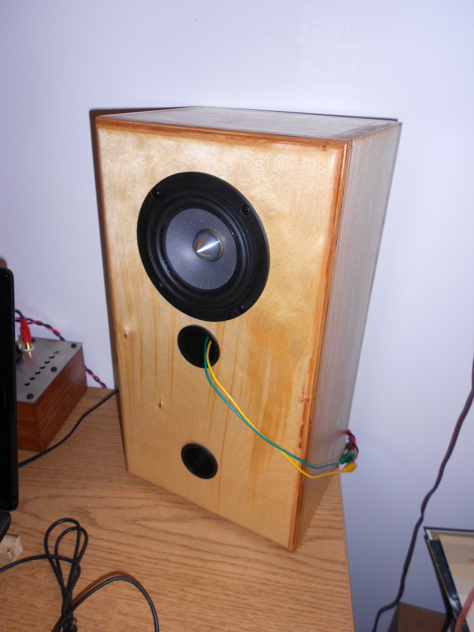

I wonder what build the OP ended-up going for, maybe he'll chime in?
In any case, I've build a DCR, dual-chamber reflex, for my pair several years ago. Similar to the Bandit, but I've made mine a bit larger, for stand-alone listening. I've measured and find the W4-1320SIF to be flat and extended to 20kHz on-axis, so not really "dark" as some say, as long as you are in the sweet-spot. Otherwise, the HF response does seem to fall-off sharply when moving off-axis, so one might say it has a dark power response. A helper tweeter above 10kHz might be a good idea for HT application, unless it's a single-seat setup.
I don't want a 4" go down to 300hz. I like to play loud some times.
Digital aktive x-over, Audiolense XO, with 8-channel RME usb.
A quick overview and it seems to hit Xmax at 200Hz at 50W max power. A 2nd order highpass at 300Hz and it barely goes over 1mm travel at 50W max power.
