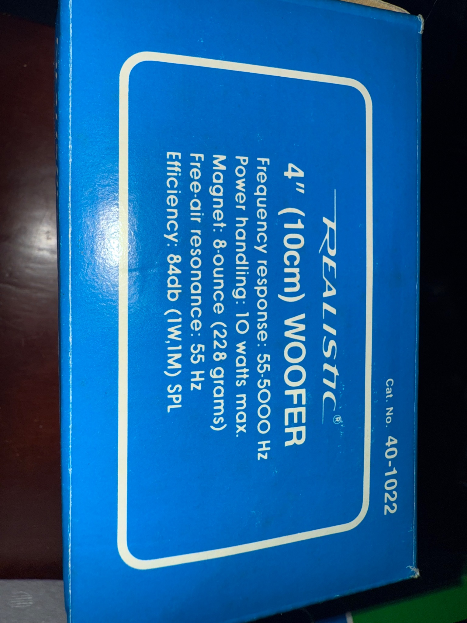

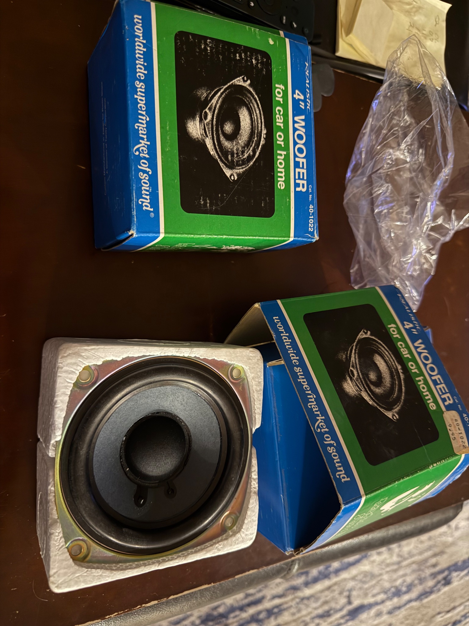

A friend dug these out of storage and gave them to me. They were never used and look to be perfectly fine in the packaging. I see they were often part of a well known “Minimus 7” bookshelf speaker.
I guess I’m wondering what a nice short path to using them might be? My wife could use some book shelf speakers in her office. But I don’t know where to start in terms of a tweeter or crossover.

David Weems has a design for the 4" 40-1022 woofer.
It is a closed box of internal dimensions 3.5" x 5" x 8" (d x w x h) for an internal volume of 138 cubic inches, constructed of 1/2" plywood.
The woofer was originally matched with a 3/4" polycarbonate hard dome tweeter (Radio Shack model 40-1376).
Here is a similar modern tweeter: https://www.parts-express.com/Visaton-DTW72-1-2-Polycarbonate-Dome-Tweeter-8-Ohm-292-676?quantity=1
The woofer is run direct from the amplifier terminals while the original tweeter had a 3.3 uF capacitor in series.
The original tweeter was attenuated following the capacitor by an L pad consisting of Rs = 5 ohm and Rp = 10 ohm.
