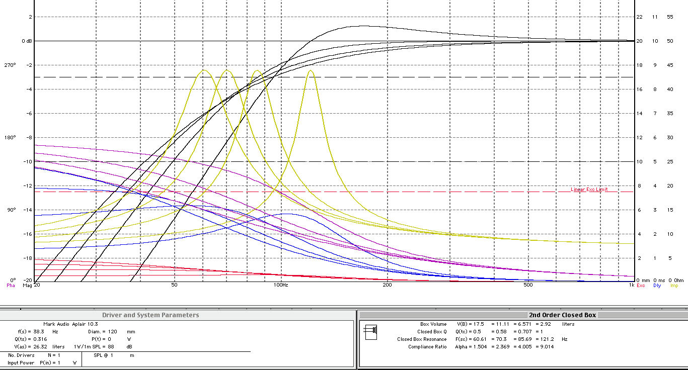

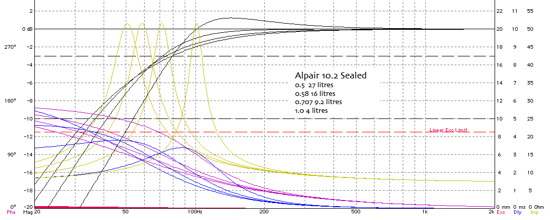

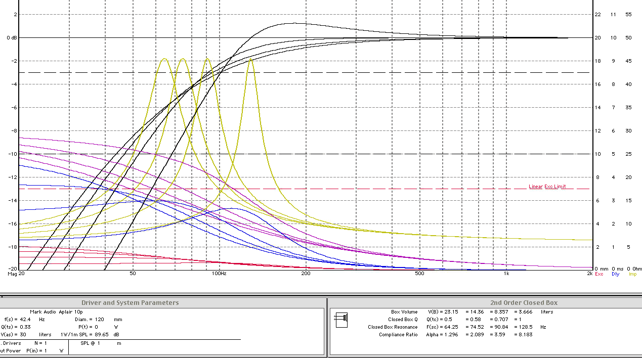

Anyone tried Alpair sealed?
Best cabinet size?
A10.2 has been used sealed (with woofers).
Sealed size is not super critical. I'd suggest 7-10 litres with some damping.
