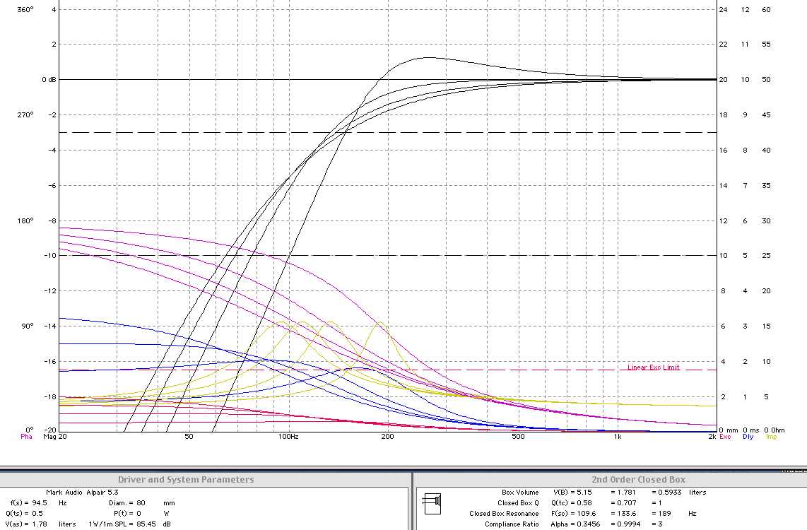

Please bear with me on this as I'm not so well informed as others!The volume is the issue, you don’t want to give up a whole lot of volume in the TL
You're suggesting, essentially, either:
a) use a small enclosure inside your TL design. I note that the graph you posted for the A5.3 has a box volume of 1.7L - so I guess losing that from 138 L (your design) is not so much a problem? Am I right in thinking that you specified such a small enclosure as a means of limiting the response below 200 Hz (ish) - so the enclosure acts as a kind of 'acoustic' XO or filter? Or is my grasp gibberish?!!

Fair summary.
The sealed box is to minimize volume. It does roll off th ebottom and one does have the option of using that as a 2nd order high pass filter. It limits you tothat frequency — 133.6 Hz in this case (you want a max flat enclosure which is the one with Q = 0,707

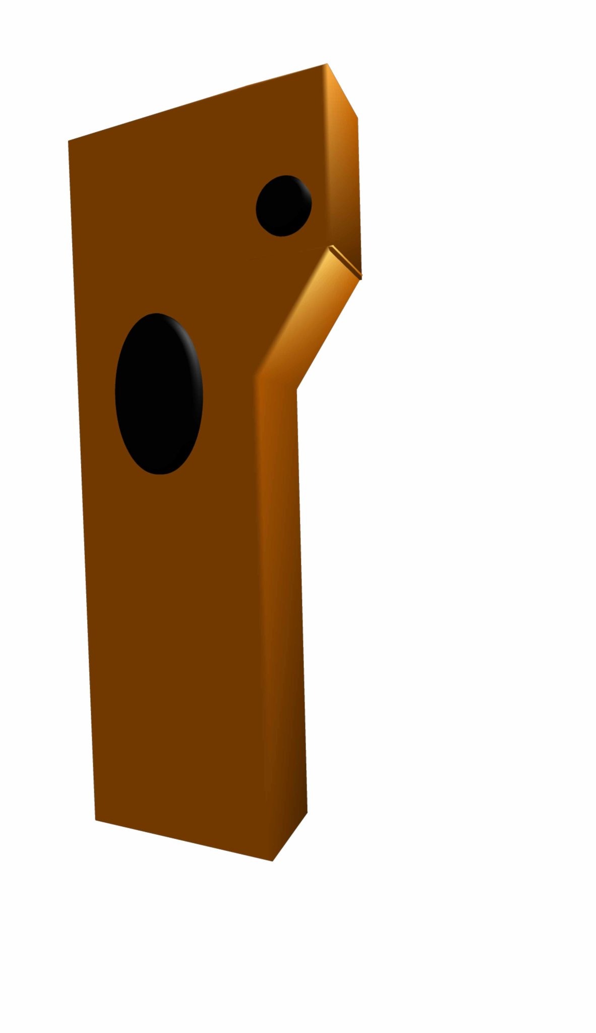

The idea, essentially, was to use the B139s (and preferably the T15s so nothing is wasted) from a knackered pair of Celeste K2s - speakers that my Dad left me and that I grew up with - there's some sentimental value there. What's the best way to realise this without spending a fortune on extra drivers or XOs? - so I came up with a TL.
Dave is suggesting using the A5.3 in a separate enclosure mounted on the side - so I came up with this - basically his triangular B139 TL box and one of Scott Lindgrens Baby TLs using the A5.3 or similar. If the worst is realised - then I have a baby TL that I can use perhaps as desktop speakers - and the large TL can be used for something else. My major concern at present is whether my better half is going to like this rather odd looking speaker!
(yes, I know the depth is wrong - it ought to be the same as the width - it's my first ever excursion into creating images on a computer and it falls sort of professional standards by some distance!)

You want the midTweeter as close as possible to the woofer.
