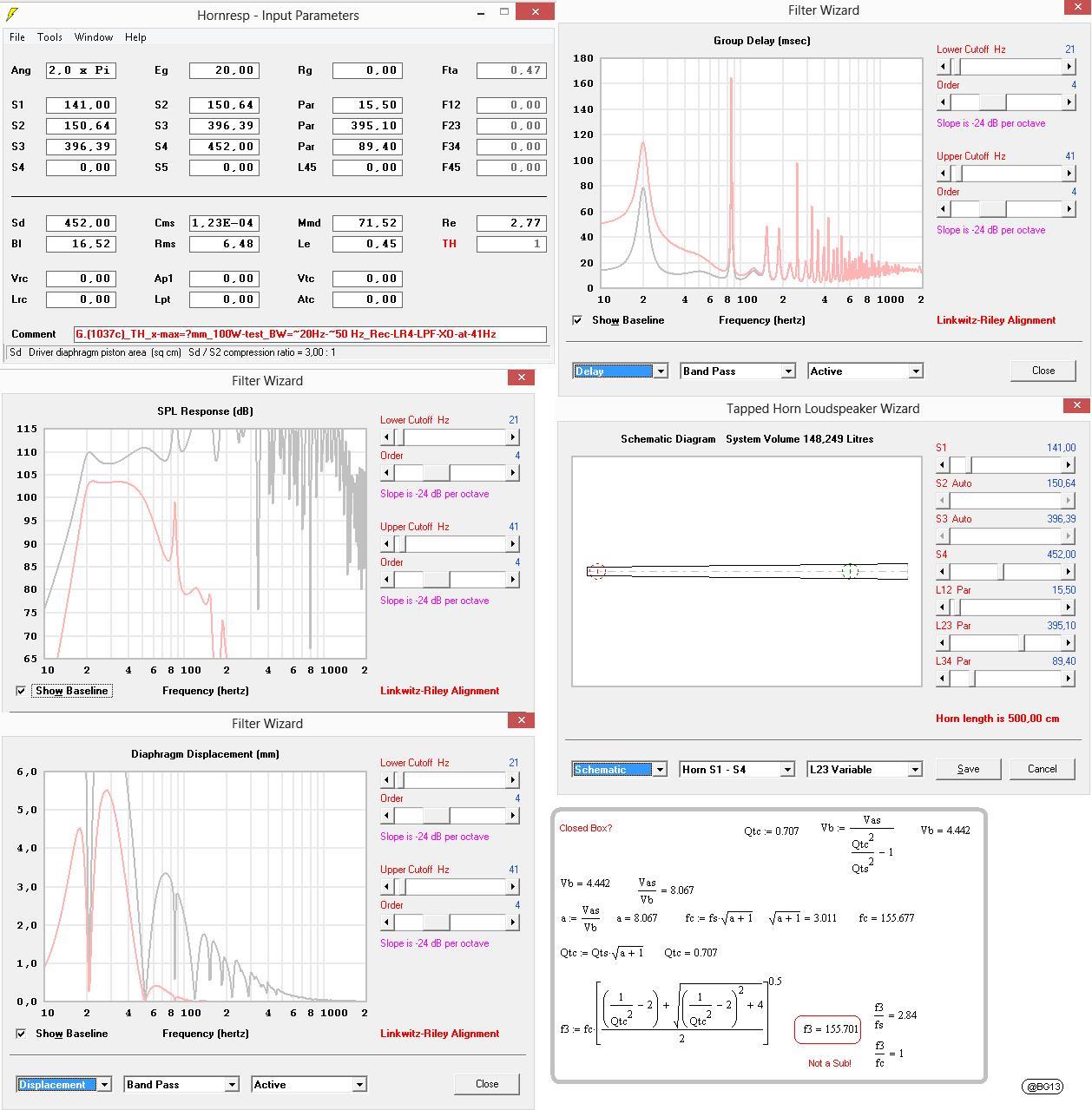

Hi, I have just repaired the cone of a woofer from a genelec 1037c speaker with pva glue. It's not needed for that application anymore as we purchased a replacement. I was wondering if it might work as a sealed sub? I measured the Thiele Small parameters using REW and include them below. It has a very low Qts and quite a high Fs. Would this work in a small sealed sub? Or has anyone any other recommended applications? I dont want to spend much on this project but my home system could do with a bit more low end so a small sub would be a useful project. This is a very heavy sturdy speaker. It has a pleated tacky fabric surround.
Look forward to hearing your ideas.
Nick
