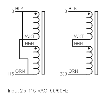

The 'traffo' (sorry didn't know the slang for it 😉 ) does have dual secondaries, the schematics at Plitron threw me off since it only shows it in series hooked up to 230V.
I'll also take a look at that P3A amp, thanks for the input!
Likely I'll be using it in series, so the schematic on the right but just 115 across the traffo.
There's the schematic that was suppose to be above.
