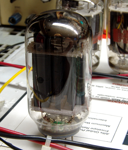

I have seen only one tube shatter abrubtly during one of my experiments. It was an early Chinese KT88, and it wasn't even glowing. Those tubes remind you that the Chinese invented fireworks. It fried some amp parts when it blew too.
In one of my spud amp experiments I found a 21LR8 that had a crack in the glass running down one side. I cranked that tube till it lit up the workbench expecting it to blow up, but it wouldn't die.

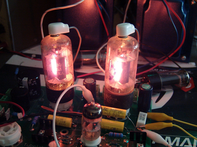

The first picture shows the cracked 21LR8, the second picture shows the tube running at 500 volts plate and screen. The third picture shows that you can get over 20 watts out of a 6BQ6 in a Simple SE, for a minute or two. Makes a good reading light too.
I wouldn't use any of these tubes in an amp, so I "tested" them. The cracked tube can not be trusted and amp damage is a real possibility when a tube breaks. The 6BQ6's were from a box of used and abused TV tubes. At the time new ones were available for 60 to 98 CENTS EACH, so I bought over 100. Used ones were expendable.
