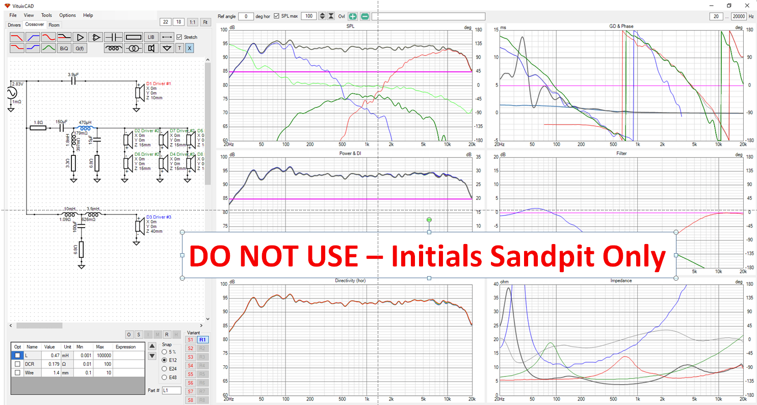

You can make a very nice controlled dispersion cardioid speaker. 400x150x150 mm enclosure, 25 mm roundover, 2 woofers on each side, MTM front with 25x80 mm planar tweeter. I slapped a design together in some 40 minutes, so it is not fully refined and may have small errors. All transfer functions are achievable by active or passive crossover, no DSP required.
Now that's what I'm talking about. Very nice and promising. I'll need to look at that more closely. May be a little on the larger side of what i intended to do - I have alot of bigger projects taking up space so it may have to fly under the radar of the wife.

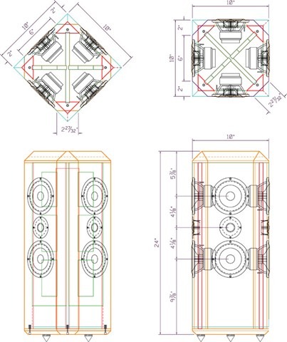

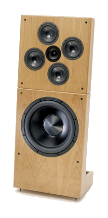

The drivers on 3 sides is sort of like these on MAX (the one with the driver on the top):

I had a moment and simulated the HiVi variant. Radiating surface is about 20x145 mm, woofers spread by 250 mm, everything still fits on the same 150x400 mm baffle. Tweaked crossover shows even better horizontal directivity, achieving really constant beamwidth of 90 degrees (-6 dB; contour line step 3 dB) from 20 to 6500 Hz. 20-50 region is dipolar, but 6x4" probably won't be used that low. Vertical directivity transition is more abrupt and HF vertical directivity may be too narrow, but that's an intrinsic property of long planars. Transition can possibly be smoothed by squeezing woofers and planar closely.I have some Hivi RT2s

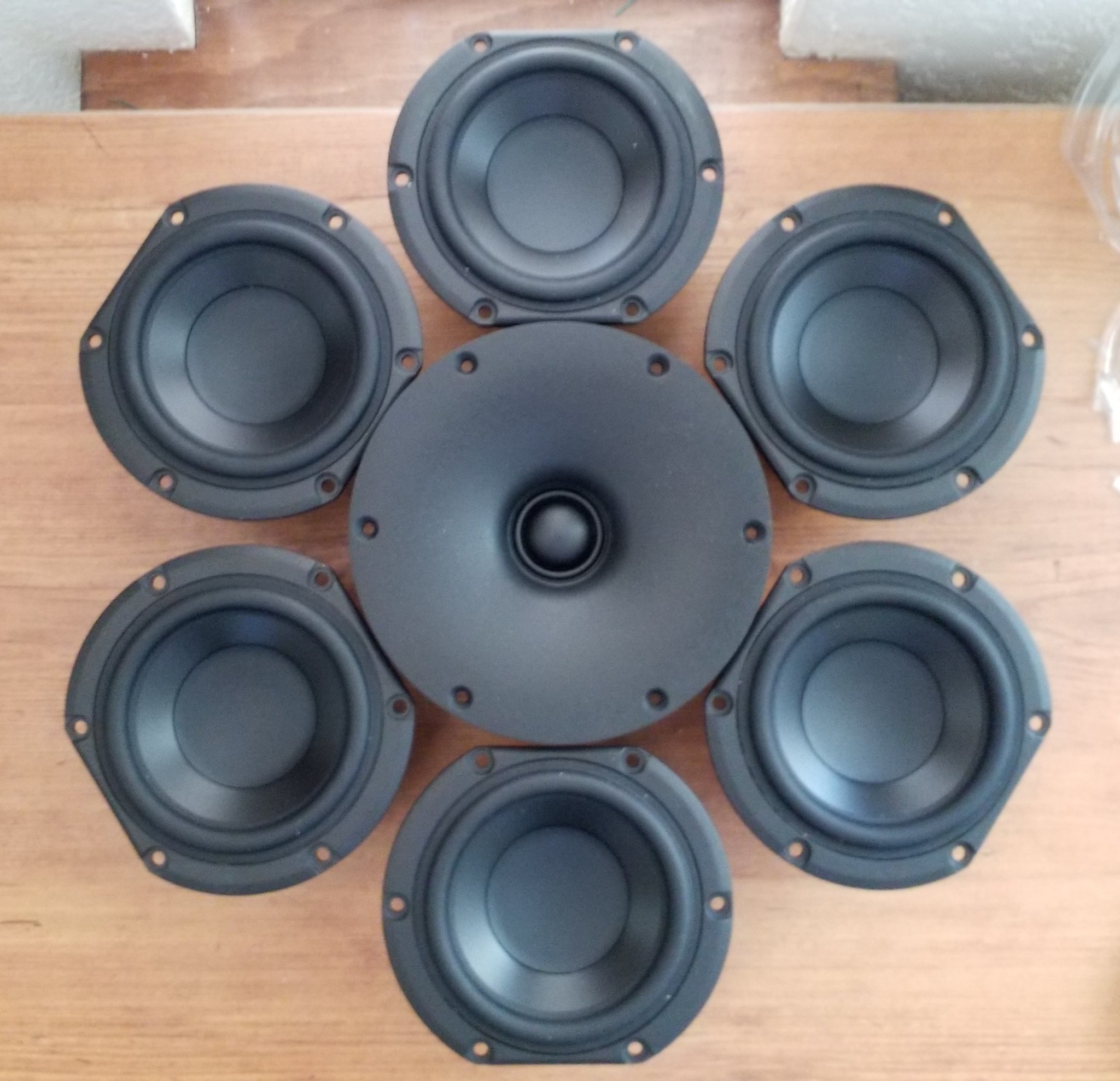

You could do a 6 driver SLOB array. I did a 6 driver array with six cheap poly cone 6.5in drivers, recently switched to 8. But 6 sounded darn good. I can only imagine using quality drivers would take this to the next level. Great sounding low distortion bass with chest punch.

I like the idea of a small array as well as a cardioid setup. On a large surfaced baffle on a flat, wall mounted enclosure, a circular array with a large tweeter for low crossover point could be a nice thing. Something like a TW034 in WG looks to easily be doable given the tweeter would cope. Does anyone know what the array gain would be for 6 of these drivers in a tight circle?
