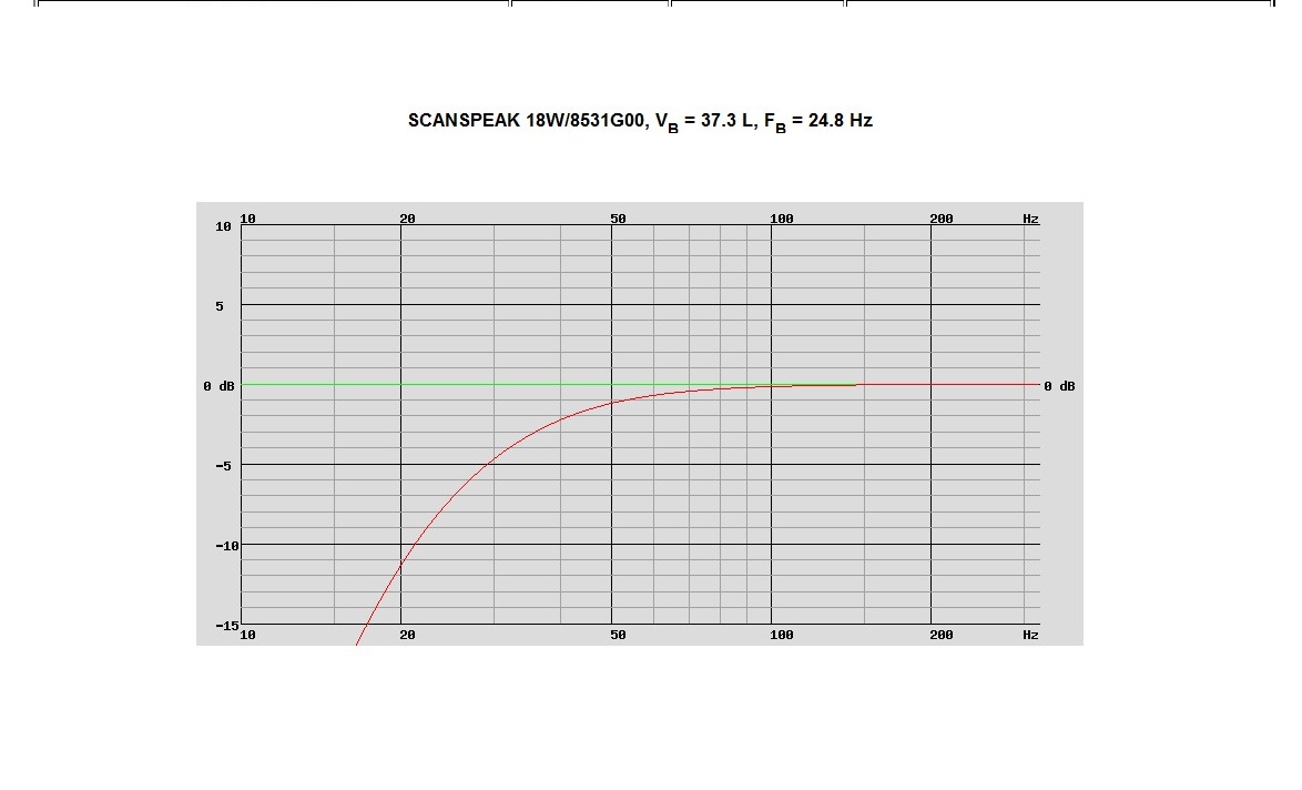

Scanspeak Revelator 18W 8531G00 hereAnd the specs on the website are kind of weird since its mentioned the speaker goes down to F3-35HZ when the SSR is F3-45HZ in 30L with the same woofer !
SCANSPEAK 18W8531G00, VB = 37.3 L, FB = 24.8 Hz, F3 = 35/36Hz
To understand use software for the simulation of all the possible alignments... 😀
