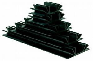

will go with the leach.I will be arranging the ordering and the delivery of the components in the next 2 weeks. is there anything else that you guys think i will need to take into account for the uprating of this design(aside from a bigger heatsink
). will also be mounting the ouput transistors in a fan type HS(pic attached) facing each other in a tunnel ram style .
running on the presumption the leach isnt a DIY amp/heating system

In case you missed it, there is a Leach board group buy going on now. http://www.diyaudio.com/wiki/index.php?page=+Leach+Amp+PCB+Group+Buy this board is a Jens Rasmussen redesign for Plastic output devices. http://www.diyaudio.com/forums/showthread.php?s=&postid=658070#post658070 for info
Contact Gengis immediately if you are interested, as he is taking money right now, planning to order on Friday.
Edit:
No, the Leach does not waste a lot of heat. I've got a 4 channel version on one of Apex Jr.'s tunnel heatsinks (about middle of this page http://www.apexjr.com/new.htm - easier to use than the sinks you show for TO-3 devices) that does not need a fan for most home use. It sounds very nice.
