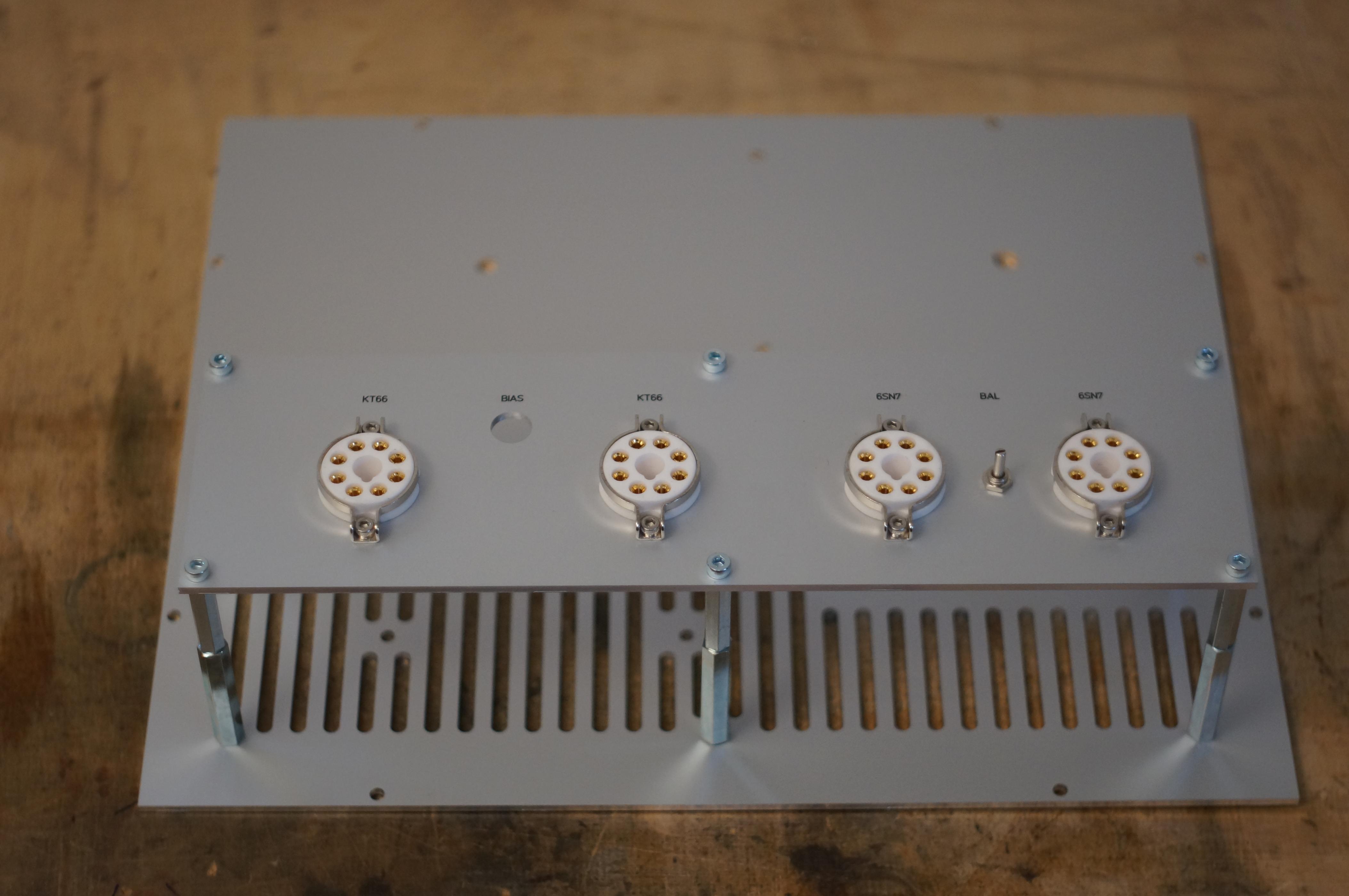

Ok, so I am working on the "proper" build of my KT66 amp. Trying to reduce the use of tape and cable ties...
The input stage is a choke loaded 6SN7, mainly because I already had the choke and wanted to use it.
Ok, so I worked at bit more on the amp. Turns out the plate choke tends to pick up some 50 Hz hum and harmonics. I could just replace the choke with CCS and be happy, but I'd like to see how far I can take the choke. Any suggestions or hints how to reduce the hum pickup in the choke? Shielding? How?
