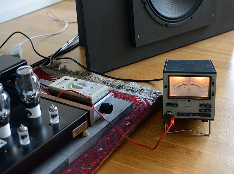

I made a quick test. I found my old Type 2425 Brüel & Kjær Voltmeter which can measure RMS, AVG, Peak, Peak hold etc.
Normal listening level RMS < 1V
Very high level.....higher than I normally listen 2V RMS.
I tried to really push to higher level than I ever will play then I reached a peak level at 10V.
I can still feel it in my ears.
So if the ACA can ouput 10V at peaks it will be all I ever need. Seems the 300B amp is good at deliver peak voltages.

A few post above I measured the voltage output from my 300B amp. Normal listen level I was below 1V output (I have 6 ohm speakers). Playing louder than normal I had about 2V RMS output. Then I turned really up for the volumen to level I will never play and a level that is really bad for the ears. Here I reached a peak output at 10V.
I was not surprised that I only need a few Watts as I knew that a 2 x 3.5 W 2A3 amp probably would be sufficient but I was a bit surprised that I was below 1V RMS at normal listening leve.

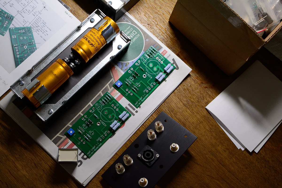

As you can see from the attached picture I have started the "ACA journey". I will also build a linear supply and I have some other plans also regarding output capacitor etc. So it will take a while before I am at the end. It will be two mono blocks. In the moment I am just make som experiments how to place components.

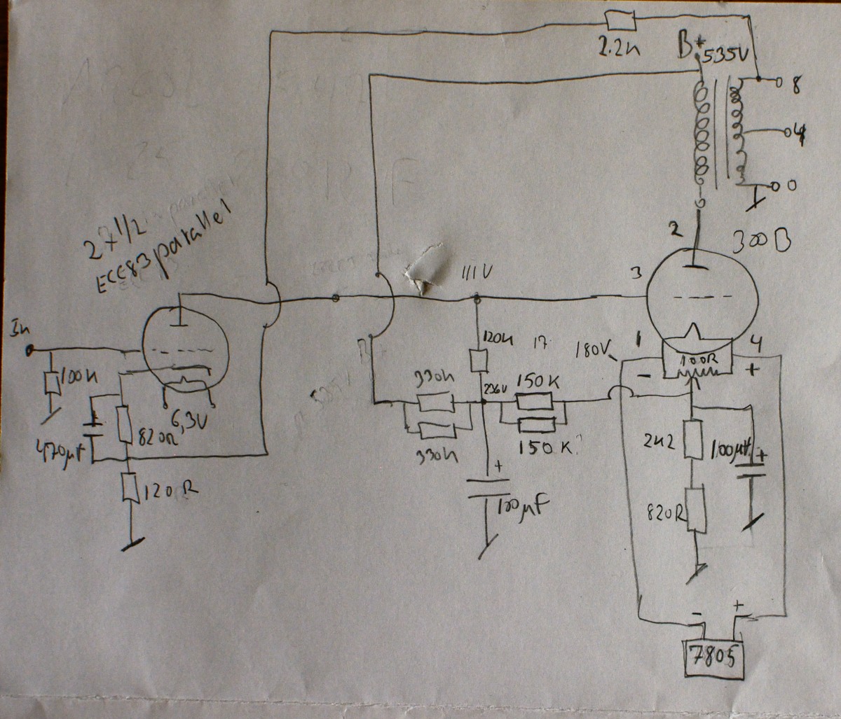

It seems to have something in common with my 300B in simplicity which
now is simpler than the schematic as the 100R humpot has been removed and 7805 is now a Rod Coleman current generator. Know this is not a tube forum......but the ACA could look a bit like a "Solid State tube amp" and the reason I want to build it ....I would never build a bipolar class A/B PP amp.....I have had plenty of those 🙂

Yes, and I already made the first modification as the NFB resistors are 33.2k and 121k HOLCO 0.1 % types to get a little higher input impednace. I will start with passive preamp and develop from there. Therefor I needed a bit higher input impedance. I am a bit unsure if it wil cause more noise as there must be a reason why a relative low input impednace was choosen from the start. But it can be changed if it does not work. Then a preamp could be the next project.....after the ACA. My DAC also have a preamp mode.....it is just not so good as it is done in digital domaine in the DSP.

I have not found info why 10k of input impedance was choosen......but ZM wrote that it was possible to double up the NFB resistors and I have 3 times the values.....so hope it is ok.
