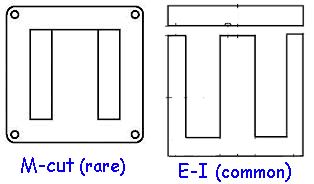

...This image seems similar to an assembled EI core.
It has less air-gap.
OTOH, it is very hard to cut that internal slit, you have two pieces of costly scrap, hard to make it minimum-gap without burrs; and you have to bend the tongue with human fingers to fill the bobbin.
E-I has two air-gaps/overlaps per magnetic circuit, but it can be proportioned "scrapless" (the Is are the notches from the Es), and there is a magic machine which stuffs Es and Is like a card-shark shuffling a cut deck of cards.
