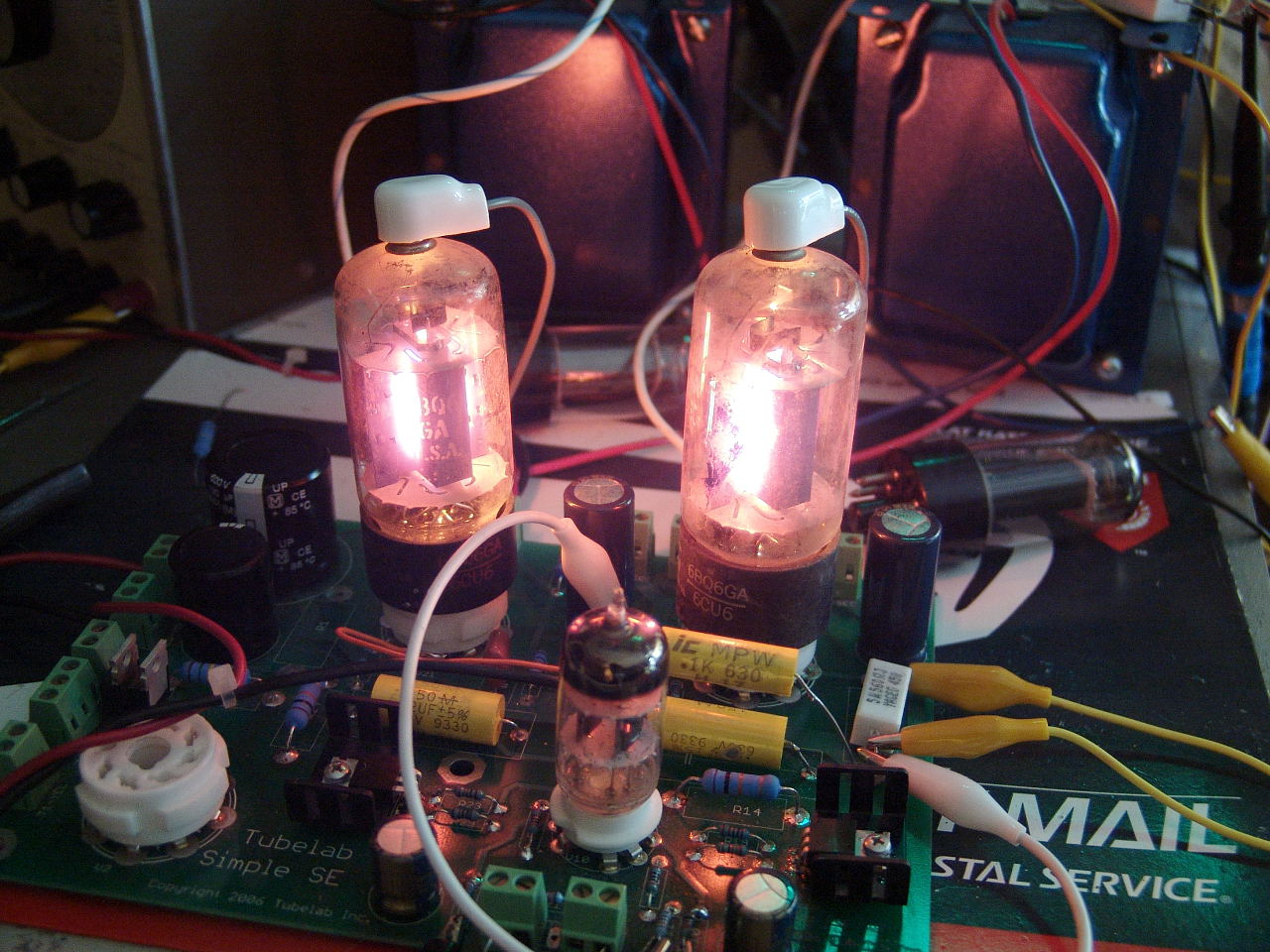

I coined the term A3 about 20 years ago when I was running 811As on a few hundred volts of B+ and had to run a lot of POSITIVE voltage on the grid to get them to draw enough plate current to be useful. Here grid current flows for all of the audio cycle, so I called it A3. Later on, I tried to tame some of those 35 and 40 watt beam triodes like the 6HV5 designed for TV HV regulators. Again, you need a few volts of positive bias to get some plate current with less than 500 volts of B+ with a Mu of 300 and a Gm of 65000 it doesn't take much drive, so grid current will always flow.
Since the term A3 never appeared in the old vacuum texts it has no strict definition and obviously means two different things here.
I also saw references in some of the links here to running tubes in the red plate region full time with no ill effects. My extensive testing in this area reveals that the hotter you run any tube, the more "gas" it will create as ions are released from the impurities in the materials used in its construction. Some NOS tubes from the 70's and older can be run quite hard since they were well made. Red plate a new production tube and you will replace it soon. Note that a tube that fails from "gas" will usually go into a red plate runaway condition in its final moments. This can take other parts like the cathode resistor and bypass cap with it when it goes.

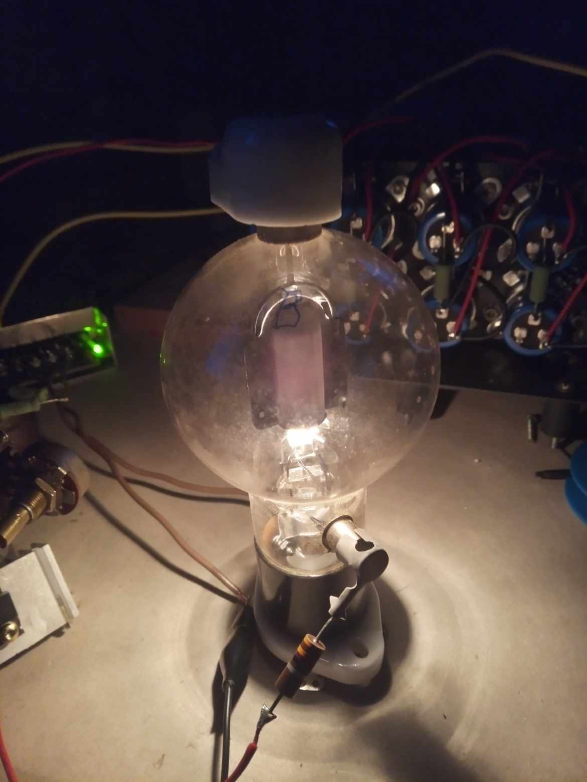

Extreme test - Total tube life, about 4 hours:

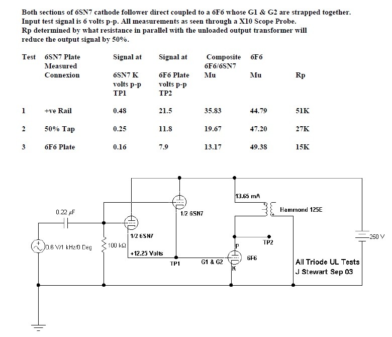

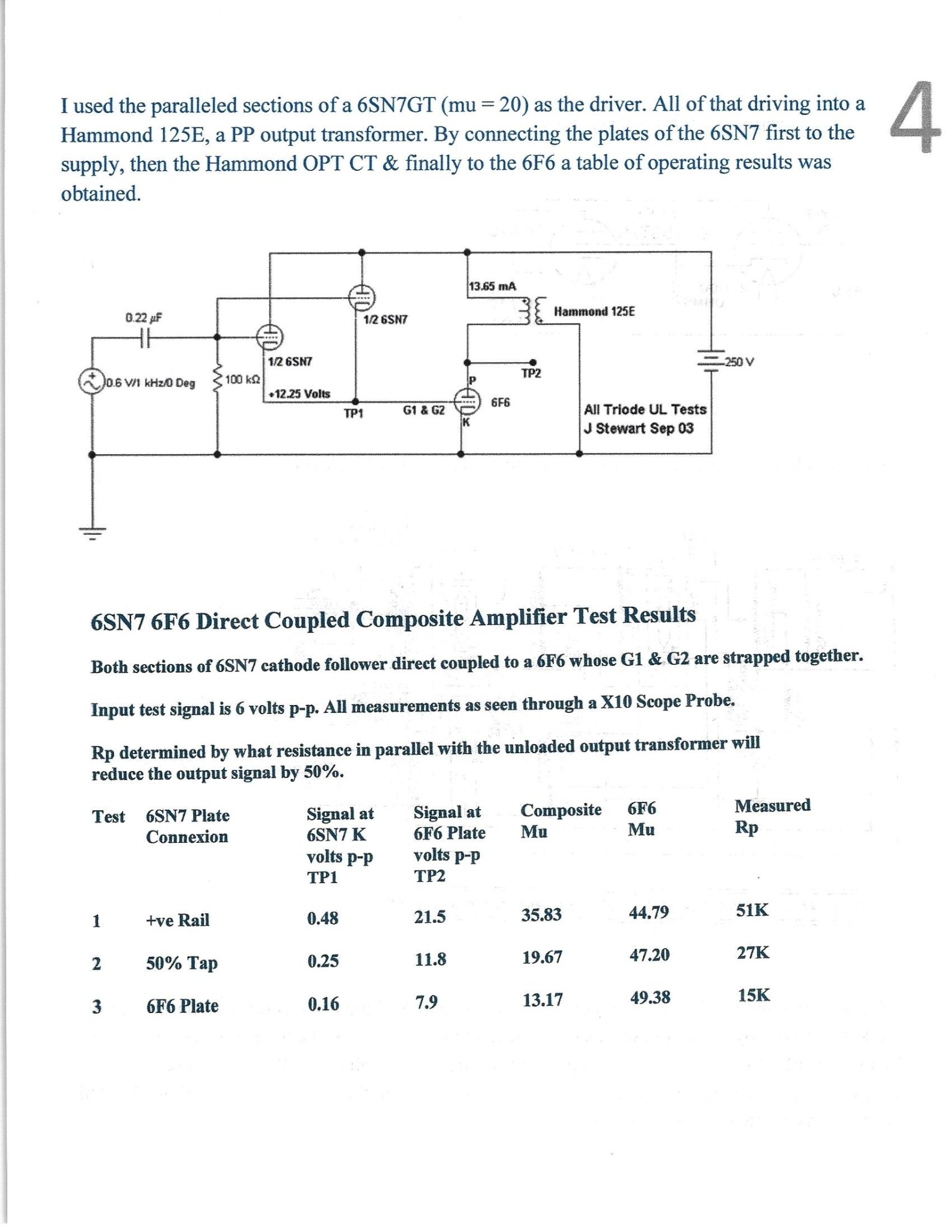

6AC5 runs that way, normally driven by a low mu triode.The main advantage is that it avoids the wild swing in grid impedance from a zero grid current condition to that sudden drop when grid current is drawn.
I tried experimental circuits like that a while back using a 6F6 driven by a 6SN7 triodes paralleled as a CF
And those positive grid drive curves LOOK like pentode curves. Can’t do that with all triodes - most of the modern stuff won’t that much grid current (See dashed lines). Some of the stuff meant for vertical deflection DOES have positive grid curves because they still did it. Those circuits usually used transformer drive so positive grid drive was easy. But when the 6L6 came out no one had to resort to darlington connected tubes anymore so it fell out of favor for audio amps.

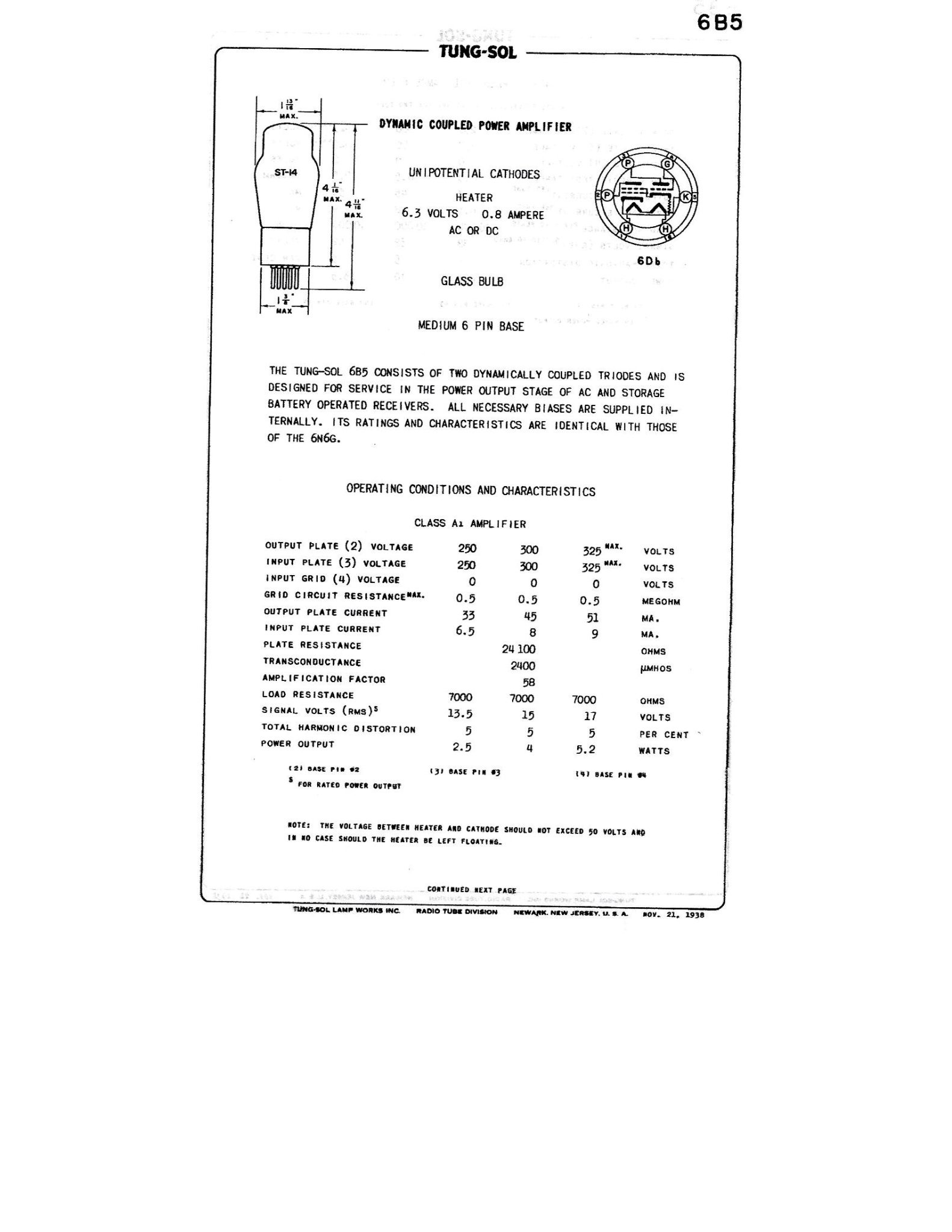

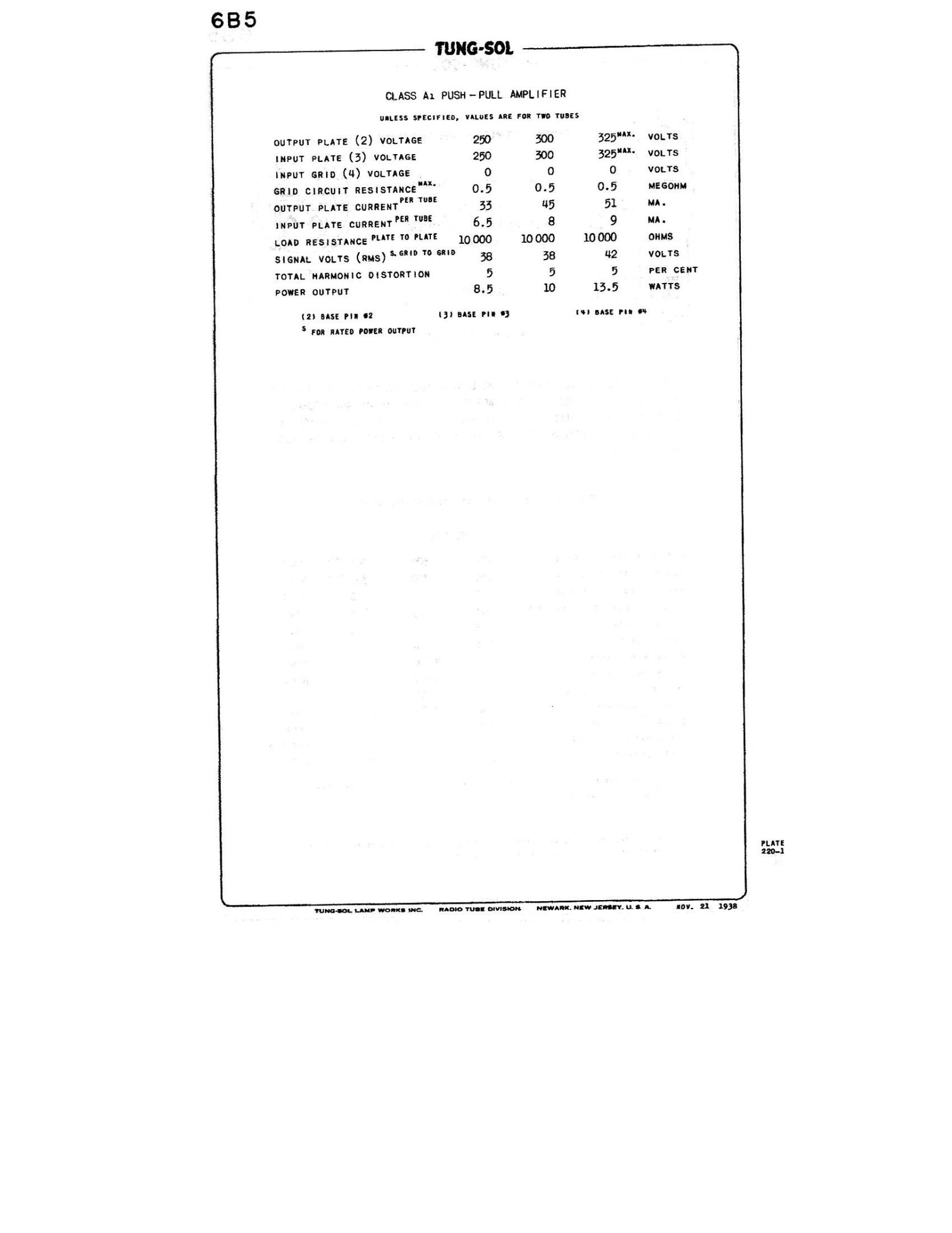

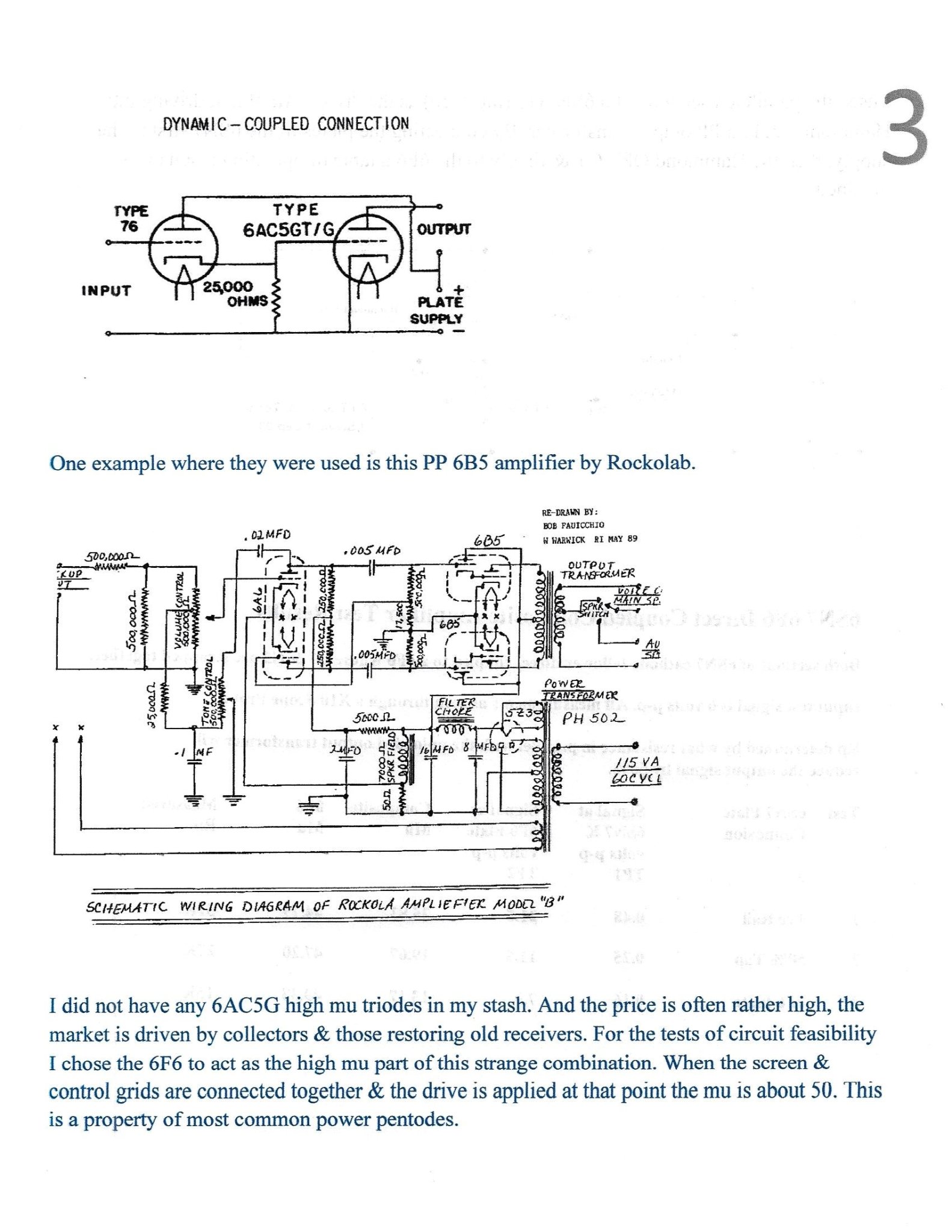

During the late 1930s several composite tubes such as the 6B5, 6N6G. 25B5 & 25N6
containing both the driver CF & an audio power section were put on the market, in particular by Triadyne.
Their 13 page document covering the 6B5 is a good reference for those interested enough to open the PDF.
The socket pin out was compatible with any of the common pentode power tubes of that time.
There was a minor advantage, in most cases they were self biasing. The 6N6G could be pushed a bit at the top end with a simple bias hookup.

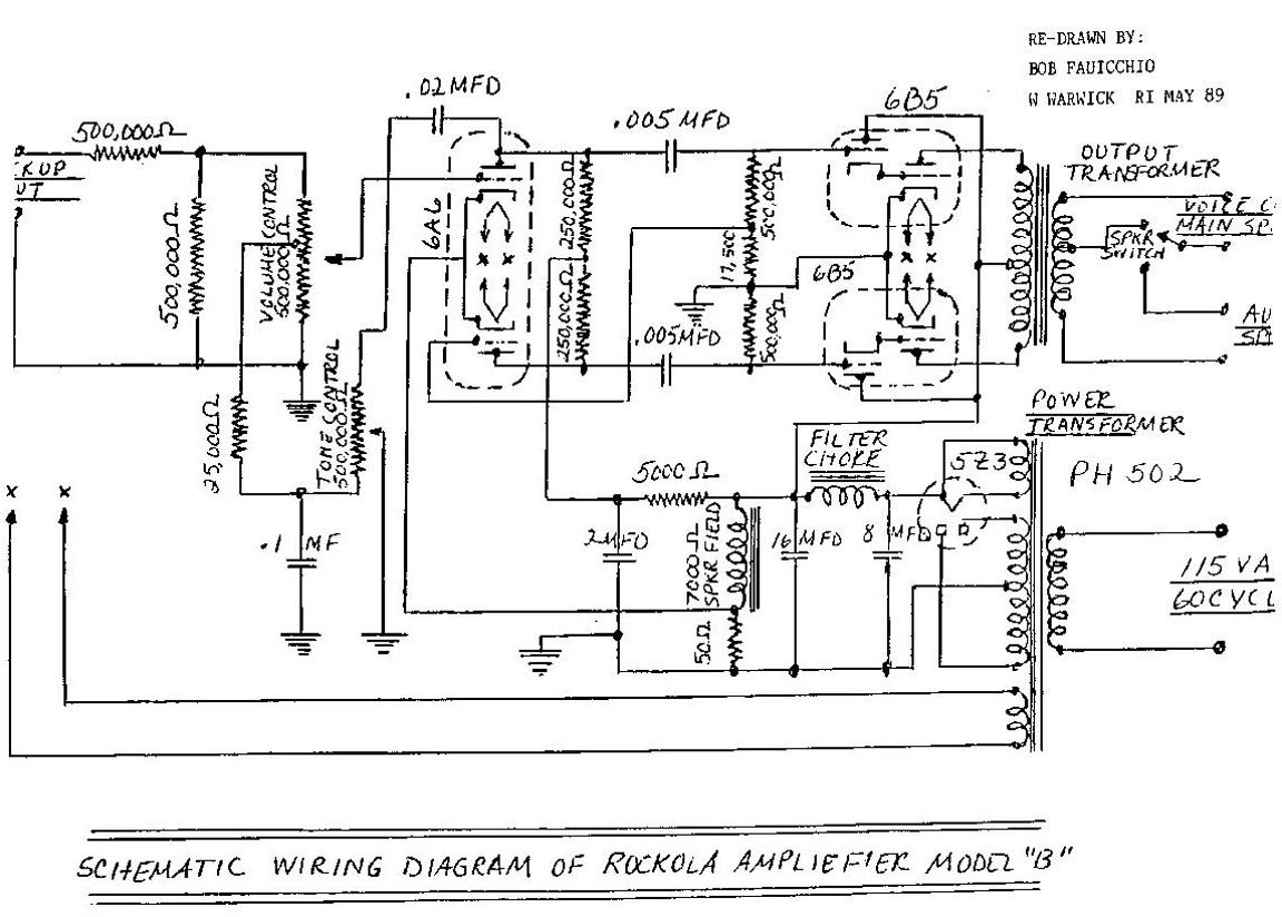

Rockolab built a PP amp using 6B5s, I think these went into Juke boxes.
For the PDF Challenged members on DIY some of the data has been converted to JPGs.

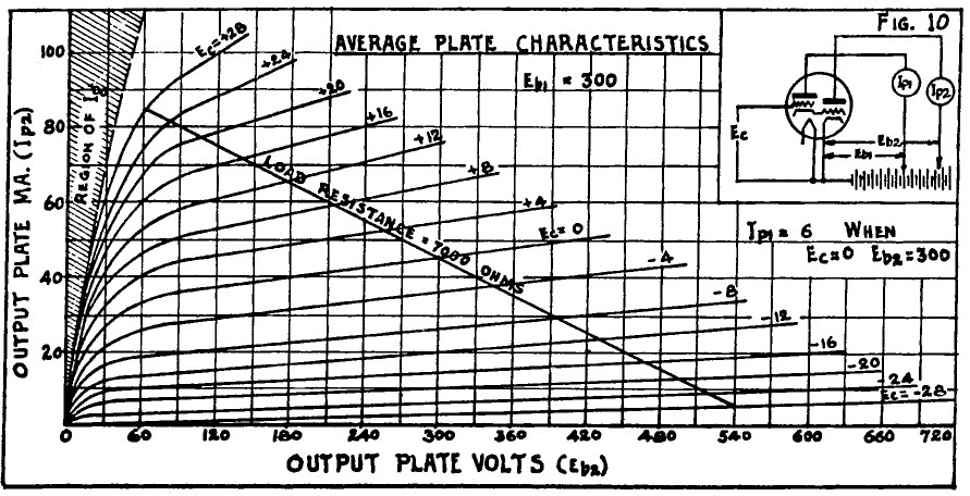

The drawing of the 6B5 internals appear to show a pentode as the output section.
FlaCharlie, often seen here on DIY has built several amps using these toobZ, 👍

The 6B5 looks similar to what Shishido called "dynamic coupling", a cathode follower straight into the grid of the next tube without reference to ground.

George - sounds like putting some decent amount of standing bias in your driver resulted in it ”working better”. 6V6’s are kind of “squished” with little current in them. The grid currents in those output tubes may be “high”, but 10 or so mA isn’t “that high”. Even the classic dynamic coupled may have benefitted, but adding another negative bias to things adds cost and complexity.
When I did the same thing with an 808 driven by an 807 CF, I got much better results after adding a choke from the CF to ground. 808 has lower mu than 811 and needs to dip into negative grid voltage for max power.
I also created a local feedback loop by connecting the 807's screengrid to the UL tap on the output transformer. I seem to remember that it worked quite well but the G2 voltage rating of the 807 was violated. That was just a breadboard experiment ten years ago, I guess I could use 6L6GC or similar with an adequate G2 rating if the amp ever gets built.

Check post #24. UL connexion in this operating mode is the plate of the driver taken to the UL tap.I also created a local feedback loop by connecting the 807's screengrid to the UL tap on the output transformer. I
All shows up in the actual measurements I ran on the 6F6 G1 & G2 driven by the 6SN7 CF..
The grid dissipation is not as extreme as we may think, altho the current may seem high for a grid the forward voltage is low.
Watts = Volts x Amps. And a lot of it is on the screen of the tubes I used.🙂
Nice, looks like there's quite a bit of Rp reduction by doing so, which would be most welcome.
My idea was to reduce the extra current drawn through the transformer primary by only connecting the screen grid to the UL tap but that leaves the driver tube in an awkward situation where the G2 voltage swings from perhaps 400V at idle down to maybe 250V and up to 550V while the plate-cathode voltage only swings a few tens of volts. Probably not a good thing for an 807, with their kind of fragile sceens.
While I was looking at the so-called Class A3 connexion I had found that the plate of the driver triode acted same as the screen in a regular pentode,

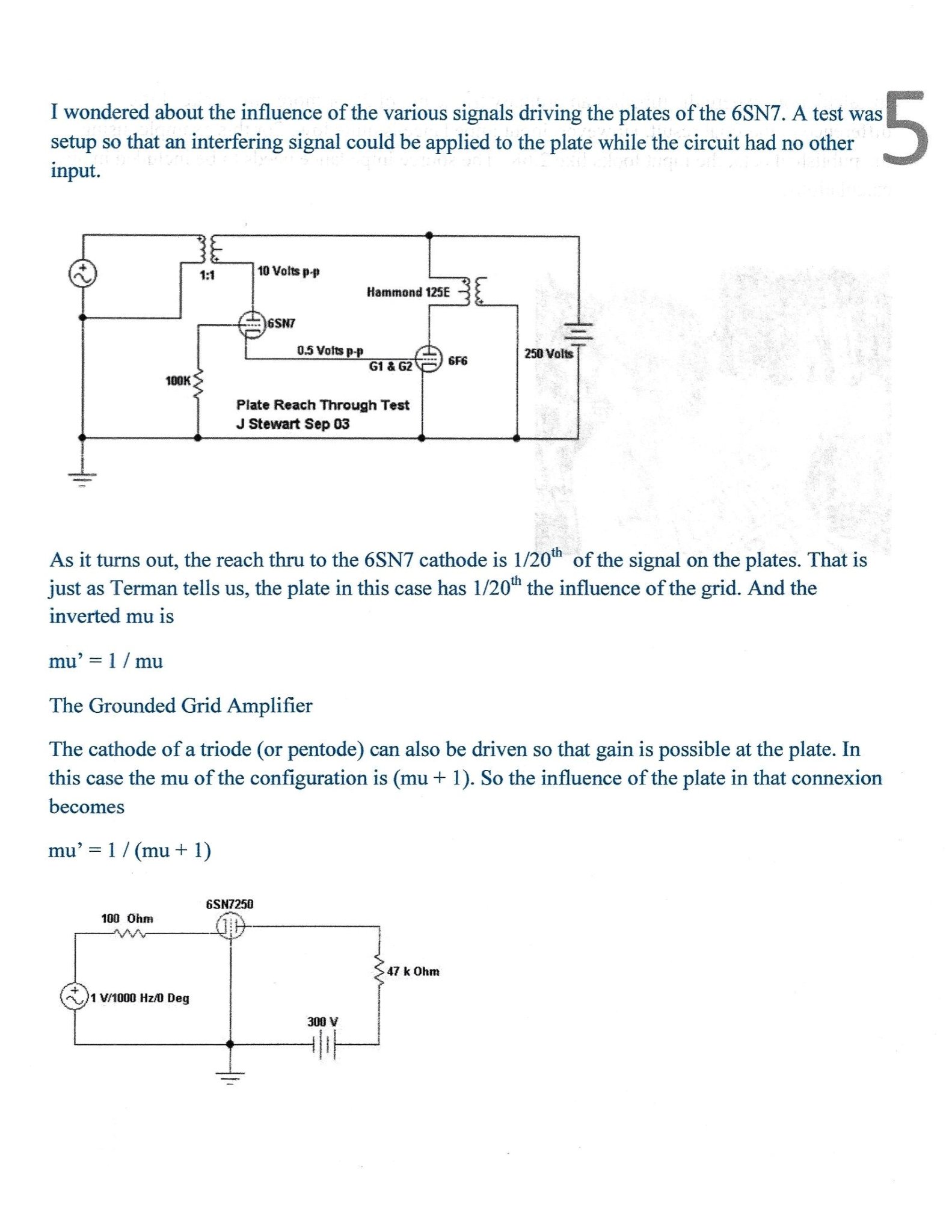

I got some numbers from the simple SE hookup to the tapped OPT, the question was how effective a voltage change on the driver plate was.
Thru a 1:1 common audio transformer, 10 volts was connected to the plate of the 6SN7, I measured 1/2 volt on its cathode. See page 5 of the report.

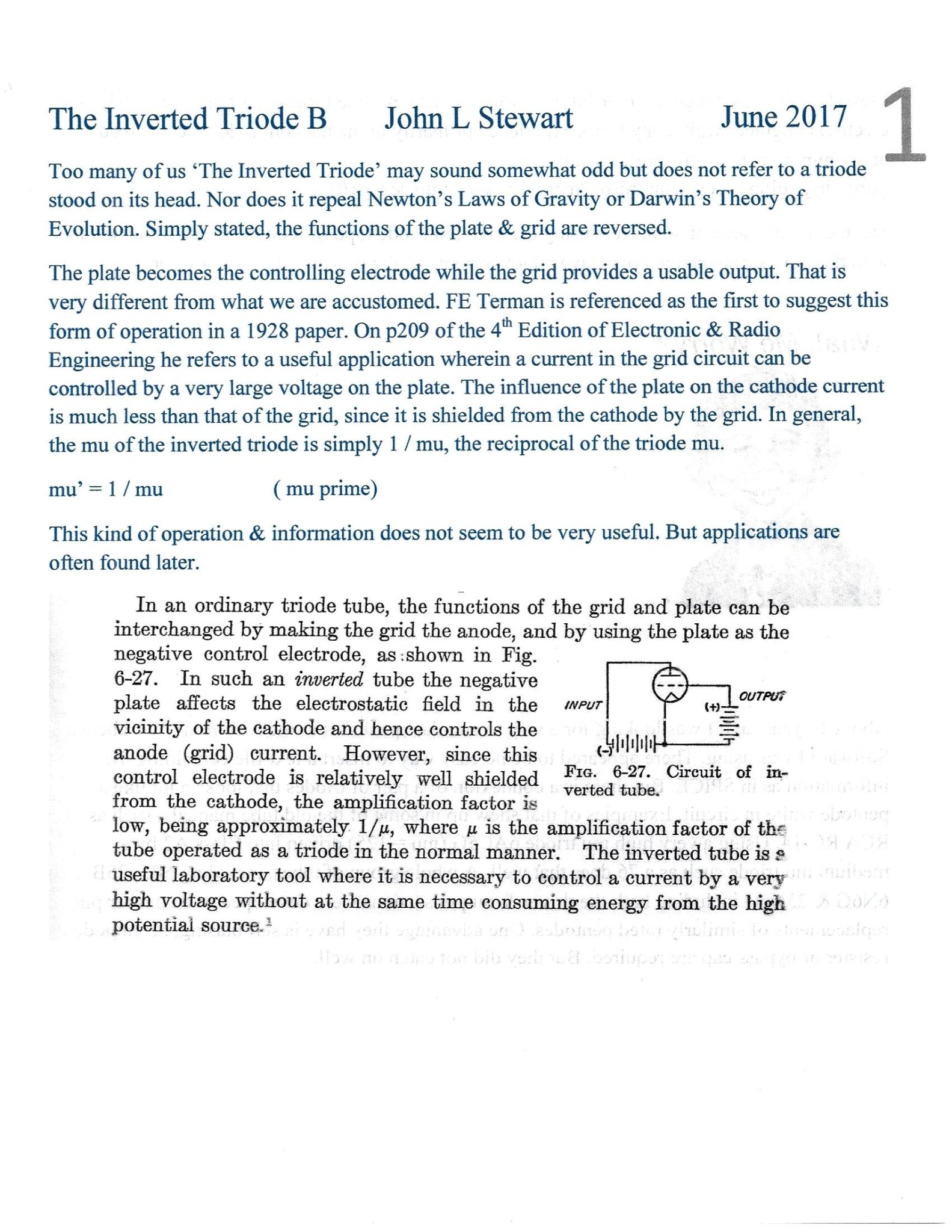

Sure enough in Terman's text book he tells us circa 1930 the inverted triode has a mu' of 1 / mu. For the 6SN7 that would be 1 / 20.
The inverted triode (not the hookup we refer to today) is a useful device. The attached shows one specially built to measure very high voltages.
Inverted Triode as a Device in a HV Measuring System.jpg814.9 KB · Views: 76
Makes sense, 6SN7 mu is ~20 so a 10V change on the plate should cause a 0,5V change at the cathode, assuming a constant plate current.the question was how effective a voltage change on the driver plate was.
I've thought about using a 12B4A or similar as a cathode follower with its plate connected to the UL tap for NFB but instead of connecting the cathode directly to the power tube's grid, it would drive a Mosfet which drives the grid. That way I wouldn't have to draw a big, non-linear grid current through the OPT.
