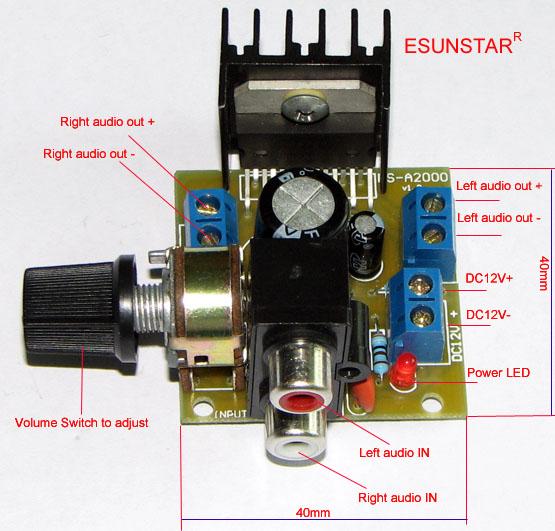

WELL...........A proper power supply came in today, and the little Lunch Amp is sounding great. By "proper" I mean a 12VDC, 2 amp computer type power supply. Not expensive. I think it was about $10, delivered.
I tried all sorts of other power supplies while waiting, waiting...not so patiently. But none of those had the proper amperage ratings and the little $6 amp hummed in protest. But when the 2 amp power supply was introduced...no more protests at all. Just music.
The $6 Lunch Amp as I'll call it is dynamic, amazingly detailed, and dead quiet at idle! Saxes sound like saxes, and drums are quick. I'll try some voices later.
But right now I'm happy listening to a very good jazz CD I'll recommend to you jazz lovers. Curtis Counce: "You Get More Bounce With Curtis Counce". The cover alone is worth the price of the CD! Check it out.
I'm very happy with this amp. Now I'll make an enclosure for it!

Hi there!
Ha. This amp would "swim" in a lunch box! I'll probably build something on the order of what I did for my Jerry's Electronics amp. But smaller. See below.
Yep, I've always been amazed on forums how guys will model stuff to death rather than just try it: speakers, amps, preamps, what have you. Uh... "Just Do It".
This thing is a total no brainer. It does most certainly need a 2 amp power supply though. It squealed like a girl when I hooked those salvaged ones that were rated in the millivolts up to it.
Incidentally, in my quest for a salvaged DC power supply I noticed WILDLY varying voltage outputs from what is stated on the thing. I had one rated at 9VDC that measured double, and a 12VDC that measured only 2VDC. Considering this wild variation in DC volts, it's no wonder so many cordless telephones fail, or even computers.
So, word to the wise for anyone trying any DC power pack: measure it with the DC setting of your volt-ohm meter before you plug it in.

Hi Sofaspud,
I run Klipsch La Scalas with ALK crossovers. I picked them up reasonably cheap, and repaired the cabinets, and painted them black.
Yeah, the power supplies I tired while waiting for a 2 amp one were old wall wart telephone types, and also one like you'd typically use on your computer. It was a big eye-opener to see how much they varied in DC volts.

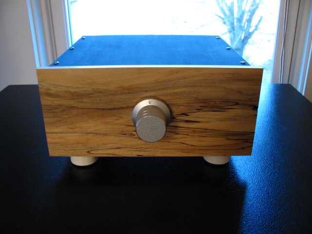

Here's my favorite class D modules. One of the better sellers I've dealt with for over 2 years now. More than $6 though. 🙂
Edit: Here are some pics of the amp I built using these LJM modules.
Rick
Those look nice - similar to all the UcD designs going on in the other threads - self oscillating I think and two power MOSFETS give it a lot of current drive. Do they sound good?
I had it hooked up to 2 DefTech Studio Monitors 350 and I thought the sound was sweet indeed. Not as silky smooth as my Pioneer SC-05 in my HT, but then again, that uses my 'mostest' favorite class D amp modules the B&O ICEPower. They, IMO are simple the best. But, alas it's not DIY either! 🙂Those look nice - similar to all the UcD designs going on in the other threads - self oscillating I think and two power MOSFETS give it a lot of current drive. Do they sound good?
The 350's have side baffles that added some bass reinforcement and of course the mids and highs were clear and concise. I was also using the new Doug Self 2012 pre that I finished up earlier in the year. That gave me a bit more control over the tweaking the sound. And of course, that pre sounds out of this world to me - regardless of the amp I have it hooked to! The LJM modules are very popular as there are a few dedicated threads about them also. Well made with good components. I'm extremely happy with them. And the price is very reasonable.
Rick
