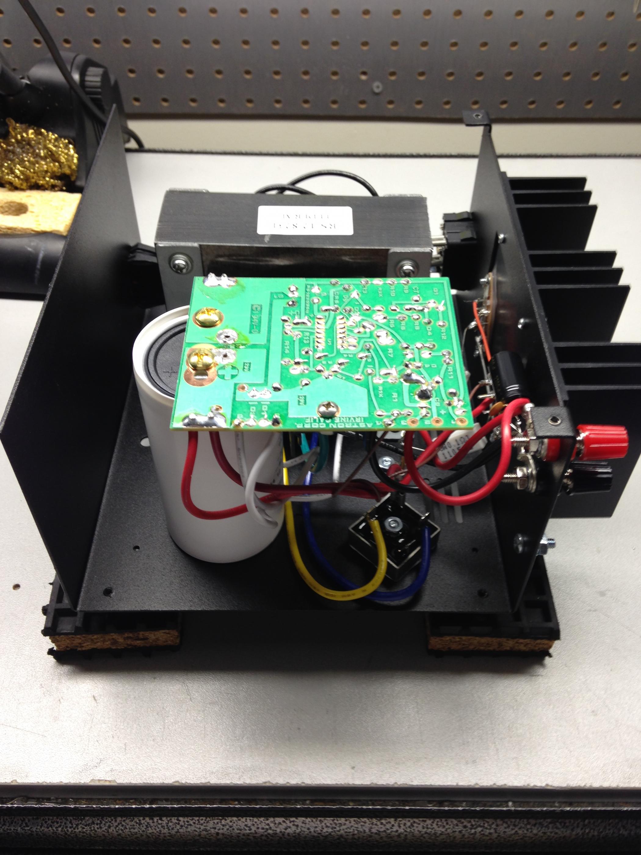

How did you get the cover off the Astron. I removed all 6 screws (2 on top, 4 on bottom), but the cover will not slide off. Is there a trick I'm missing?
Thanks, Mike
The cover should easily slide off forward or rearward once you've removed the screws. If it is somehow stuck, you could gently tap the cover with a rubber mallet. Maybe the enclosure paint is sticking between the top half and bottom half of the enclosure.

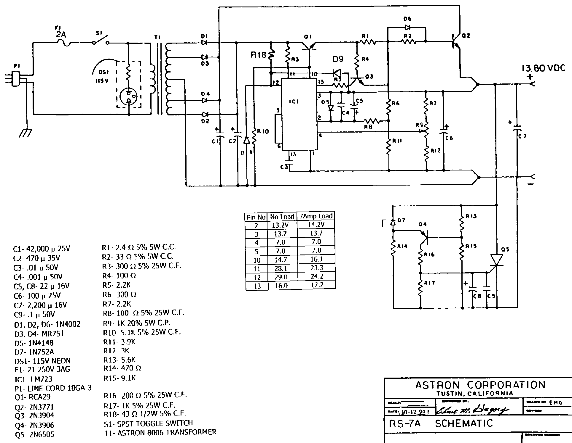

is there a suggested mod for Astron RS-7a, I am using it to drive 7297...
I reference the Astron Power Supply Index:
Astron Power Supply Index Page
This Website has a wealth of information including schematics for many Astron power supplies including the RS-7A. There are many modification and troubleshooting tips there.
According to the above schematic, I would recommend upgrading the following electrolytic caps:
C1 - 42,000uF/25V (Evox-Rifa or Kemet PEH200)
C2 - 470uF/35V (Panasonic FM, Nichicon HE, or Nichicon KZ)
C7 - 2,200uF/16V (Panasonic FM, Nichicon HE, or Nichicon KZ)
I also added a 0.1uF/275V Wima MKP X2-rated Polypropylene film cap across the contact terminals on the AC SPST power switch.
I am not completely familiar with the Astron RS-7A's physical layout, so you would need to insure that all your replacement components properly fit within the enclosure and can be securely mounted.
In the case of modifying a brand new Astron RS-12A, I drilled a hole in the bottom of the chassis to accommodate the M12 mounting stud on the large, white Kemet (Rifa) PEH200 electrolytic filter cap to anchor it and the attached regulator board. I also added some Teflon sheet to the interior surface of the top panel to avoid any potential shorts from the top panel making contact with the regulator board.
I would only recommend doing this if you are familiar with working with high voltages, and power supplies including proper capacitor draining.
For the DC power cable connecting the power supply output to my amps, I used a twisted pair of 16AWG Teflon-insulated Silver-plated Copper stranded Mil Spec wire jacketed in spiral wrap tubing and Tech Flex sleeving. I use either Neutrik 4-pin XLR or Switchcraft S760 DC power connector.
Making these changes on my "new to me" used Astron RS-12A (ca. 1980's) and on a buddy's brand new Astron RS-12A (2013), the improvement was night and day each step of the way going from a cheap SMPS brick to a stock Astron RS-12A to a modified Astron RS-12A. We did comparisons and each improvement resulted in growth of the soundstage, improved separation of performers, improved tonality including deeper bass response. Another friend across the country bought an Astron RS-12A and did the same mods. He heard the same improvements.
I also added some 3M Dynamat vibration-damping sheet material from a local auto parts store to the interior walls of the top and side enclosure panels of my vintage unit, because my unit had a mechanical hum originating from the power transformer. This makes it a bit more challenging to remove and replace the top/side cover, but I've been able to manage without scratching the finish.

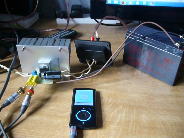

Bought a couple of these (came un-assembled). Up graded the heatsink, with an old Intel Zeon server unit.
Running on a 12v SLA.
Amazing value for a couple of £'s
