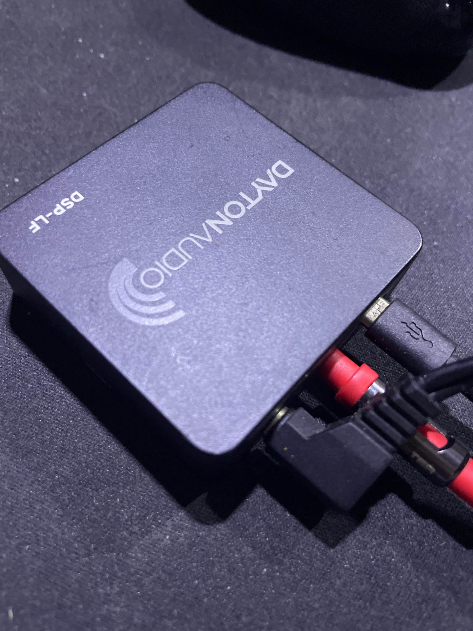

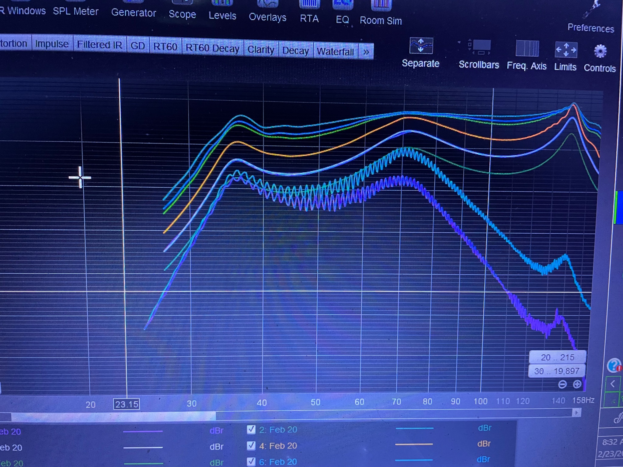

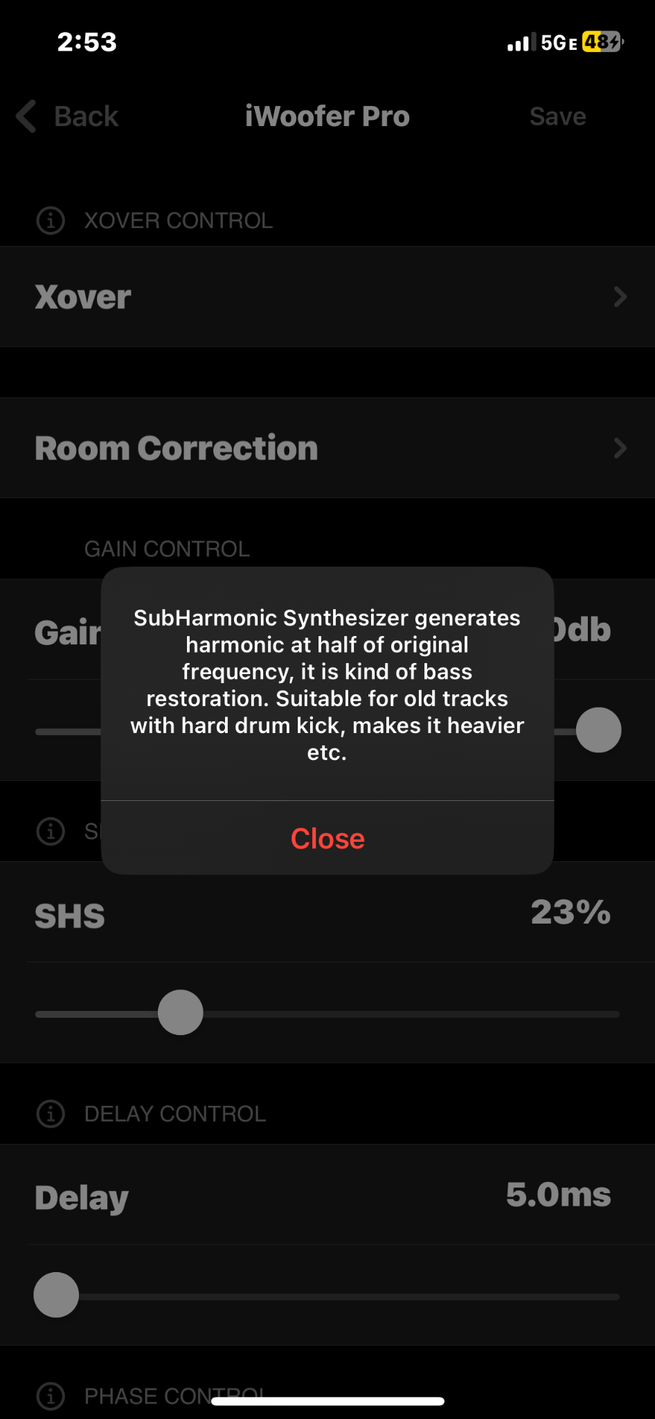

Booger weldz Member Joined 2019 2025-03-01 4:23 pm #1 2025-03-01 4:23 pm #1 What the heck is that doing to the signal (dayton dsp LF in the super squiggly bottom two measurements )? Attachments IMG_2539.jpeg 1.1 MB · Views: 82 IMG_2527.png 120.5 KB · Views: 82 image.jpg 824.3 KB · Views: 77 Rik_bS Member Joined 2012 instagram.com/batteryacidsoundsystem/ 2025-03-01 11:07 pm #2 2025-03-01 11:07 pm #2 First thought is some sort of "bass enhancement" psychoacoustic processing - check the settings? Reactions: Booger weldz Booger weldz Member Joined 2019 2025-03-02 10:54 pm #3 2025-03-02 10:54 pm #3 I think you’re right Attachments IMG_2617.png 371.5 KB · Views: 61 Reactions: maxolini You must log in or register to reply here. Share: Facebook X (Twitter) LinkedIn Reddit Pinterest Tumblr WhatsApp Email Link
