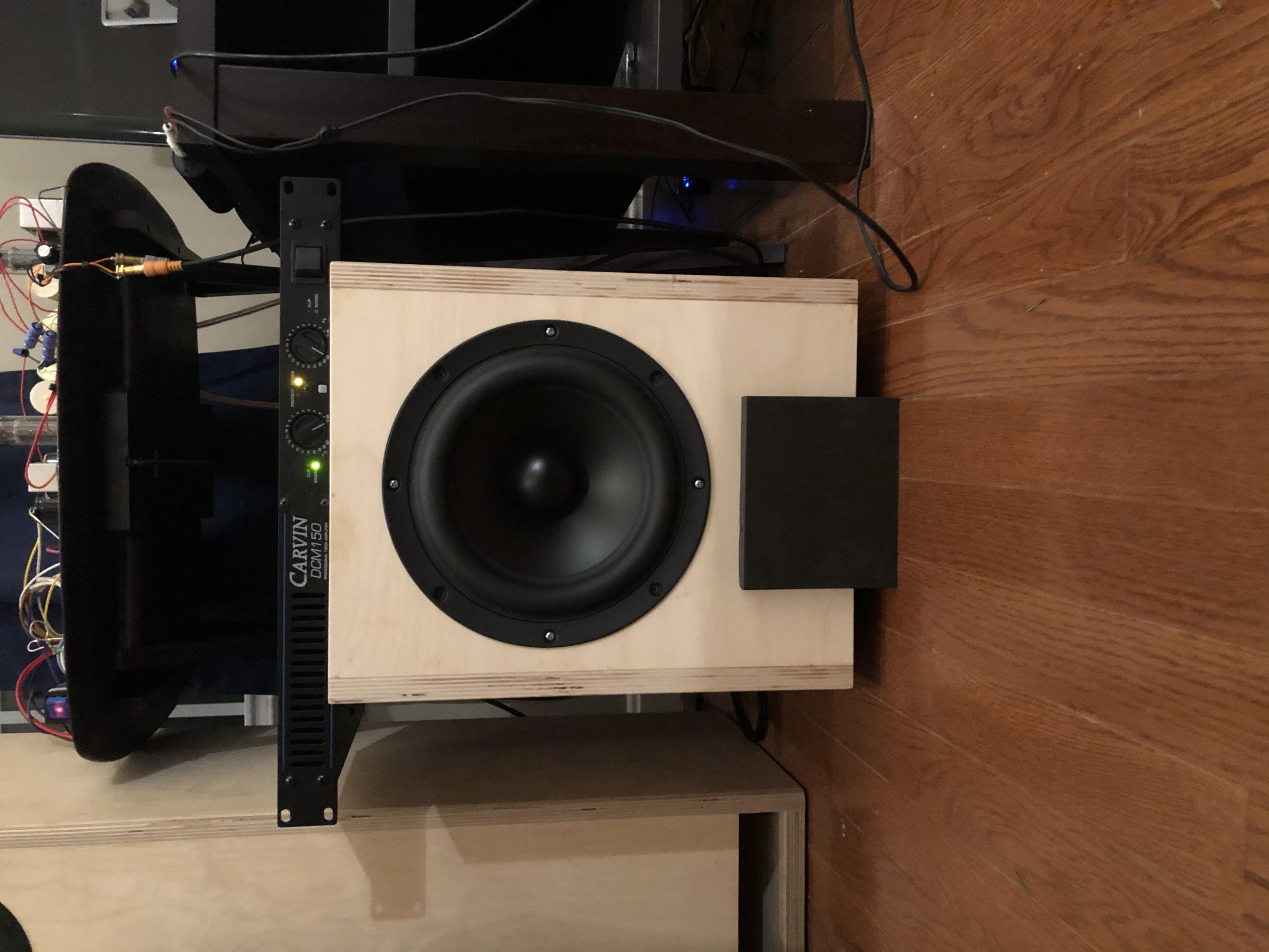

Well I think I’m going to get some plywood cut up tomorrow and put some boxes together. I’ll order drivers over the weekend. I’m going a bit bigger than absolutely necessary to lower the qtc and ensure some excursion headroom for eq. I’m looking at about 36l gross in a 12x15x17” enclosure. The driver will be on the the 12x15 side and biased to the top to prevent vacuum cleaner impacts. By mounting on the narrow side I can nest them close to the tv table and optimize space.
I made one over the weekend. Sounds nice. I have parts to make a second.
