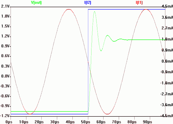

So how do I determine what's reasonable settling time? For example, how much can I test how aperiodicity may affect THD? Here's a simulation result with an actual square wave. I have no idea if this is too long or too slow if say I'm aiming for THD on the order of 1 ppm, and how much a large transient would affect the distortion.
