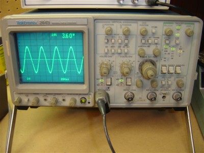

Just like the topic says.The only reason I'd like to buy one is for audio repair. Can I get by with one that maybe doesn't have the greatest bandwidth or features?I have no idea what to look for in these things but I think its a necessity if I plan on learning more about amplifier repair.
Don't worry about bandwidth. I have two scopes with 2MHz (not a typo) bandwidth and they work fine for virtually any amp made.

I'd suggest that you avoid virtually all scopes that don't show a 'locked' waveform on the display. Those with no display may not be able to produce a trace. Those without a locked waveform displayed may have triggering problems.
If the photo is taken in a darkened room, it's likely that the CRT is weak and the trace wasn't bright enough to be photographed clearly under normal room lighting.

Perry Babin said:I'd suggest Tektronix scopes. B&K also makes some good scopes. In the Tektronix line of scopes, the old 400 series scopes are a good choice. The somewhat newer 2200 series scopes are also a good choice. Stay away from the older LCD scopes and the 2400 series scopes. They have too many problems.
The 2400 series scopes are among the best analog scopes Tektronix ever built -- and there are boatloads of them for sale all the time, but absolutely buy from a seller who deals in scopes -- someone who will take back a dud.

I agree that the 2400 series scopes are very desirable (I wish I had one) but they're not a good choice for someone that's just starting out.
The problem with the 2400 series scopes is that they use proprietary hybrid ICs that fail and new replacement parts are no longer available at any price. In some cases, the only way to repair a scope with a dead vertical or horizontal hybrid IC is to salvage it from another scope. The problem with that is that the hybrid IC is likely the reason it's being used as a parts scope.
If I'm not mistaken, the older TDS scopes had significant problems with leaking capacitors that made them virtually un-repairable unless the problem was caught early. Again, not something that you want to have to deal with when there are lots of other options.
The scopes I recommended are, for the most part, readily available, inexpensive, reliable and repairable.
