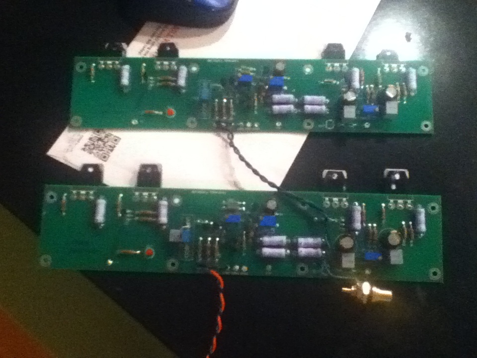

This summer I'm building an aleph j using boards from the diyaudio store.
I'm tempted to buy a pair of ohm Walsh 4 or 4xo but only if the aleph j will match.

Depends on how loud you want to listen: 25 watts into 90 dB / 1 m ~ 104 dB / 1 m. Which is a lot. In practice you might have slightly less as the Alelph J doesn't have a lot of current if I remember correctly but you should be able to get 15-20 watts into 6 ohm so say around 100-103 dB / 1 m.
100 dB / 1 m is a lot, for me it would be enough by far =)
EDIT: As this is DIY it might be possible for you to lower the rail voltage on the Aleph J and crank up the current to give you full 25W into 6 ohm. It would probably mean modifying the circuit though.

It will probably work, I ran mine on 22V. If you want to tweak to get more power into lower ohm then as 6L6 says the magic isn't in reducing voltage but in increasing current. Reducing voltage is just practical to do as if you just push up the current you increase dissipation.
If that isn't a problem then you could probably get away with just adding more output devices, it could double up as a heater in the winter =)
Addition: Just reducing voltage will result in more distortion too. In the end the difference between 13W and 25W into 4 ohm is ~ 3 dB which in the grand scheme of things isn't much. If 3 dB makes a huge difference for you then the Aleph J might not be the amp for you anyway so it's probably easiest to just build the default version first as you should have enough power anyway even into 4 ohm. The distortion performance of a lower voltage -> higher current into 4 ohm should be about the same as the stock one, the stock one just has less total watt capability into 4 ohm.
