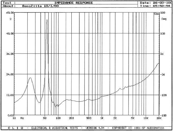

This is the impedance response plot provided by Dick Olsher, the designer, in the BassZilla construction manual.
attachment.php
Larger amplifiers, like the Aleph 2 and the Krell KSA-100, do raise the room temperature during long listening sessions. The Aleph J has lower heat rejection, which is one reason why I am favoring it and the F5. But the main reason is how the Aleph J enhances textures and the sense of presence in the room.

NP's caveat means fairly sensitive benign impedance speakers - no dips too low, no wild reactance. If your speakers will give you 90 db/W and your Aleph J will make 30W you can get 105 dB peaks cleanly. OTOH, your speakers are more like 80 dB/W you will be limited to 95 dB peaks. This may be enough for you, or may not.
On the FirstWatt website the Aleph J is rated 25W into 8 and 13W into 8 ohms. My question is at which impedance does the amp start running out of current ? A speaker with 6 ohms minimum will already lead to limited power output or not ?
What the first Watt site is saying is that the Aleph J can produce 3.125A of output current.
The simplified equation is P = I^2 x R So, at 6 ohms you can expect 18.75W.
The reason that is simplified is that 1. Speaker impedances are not constant and 2. Speaker loads are not purely resistive. So, a "6 ohm speaker" could have an impedance ranging from say 4 to 20 ohms over the audio band. The power delivered depends on the magnitude and phase angle of the load and the voltage available at a particular frequency. Look for a review of your speaker to see what the load actually is.
The good thing about DIY is that you can change things to suit the load, within reason. Output power is determined by output voltage and current. The A-J is a single ended amp and can deliver roughly rail voltage and bias current times AC gain (typically set at around 50%). This differs from typical push pull circuits that can provide increased current into lower impedance loads.
Have a low impedance load to drive with your Aleph J? Increase the bias, add more output devices, change the active current source gain or all three. I'd tend to leave the current source gain alone just because that has more of an impact on the character of the sound than the others. Need more power? Increase the rail voltage, up to say 30V. This will put a bit more stress on your 2SJ74s but NP seems to think they can handle it in the F5 Turbo article. You can add another pair of output devices (one ACS and one OP) or maybe 2 without impacting the sound character. Need to drive lots more output devices? Parallel multiple pairs of 2SJ74s.
These options allow you to make your A-J YOUR A-J This is a lot of the fun of DIY, at least to me. Read through the various Aleph threads. You'll see a lot of discussion about increasing bias, number of outputs and AC current gain. All applies to the A-J, with a rail voltage limitation due to the JFETs.
