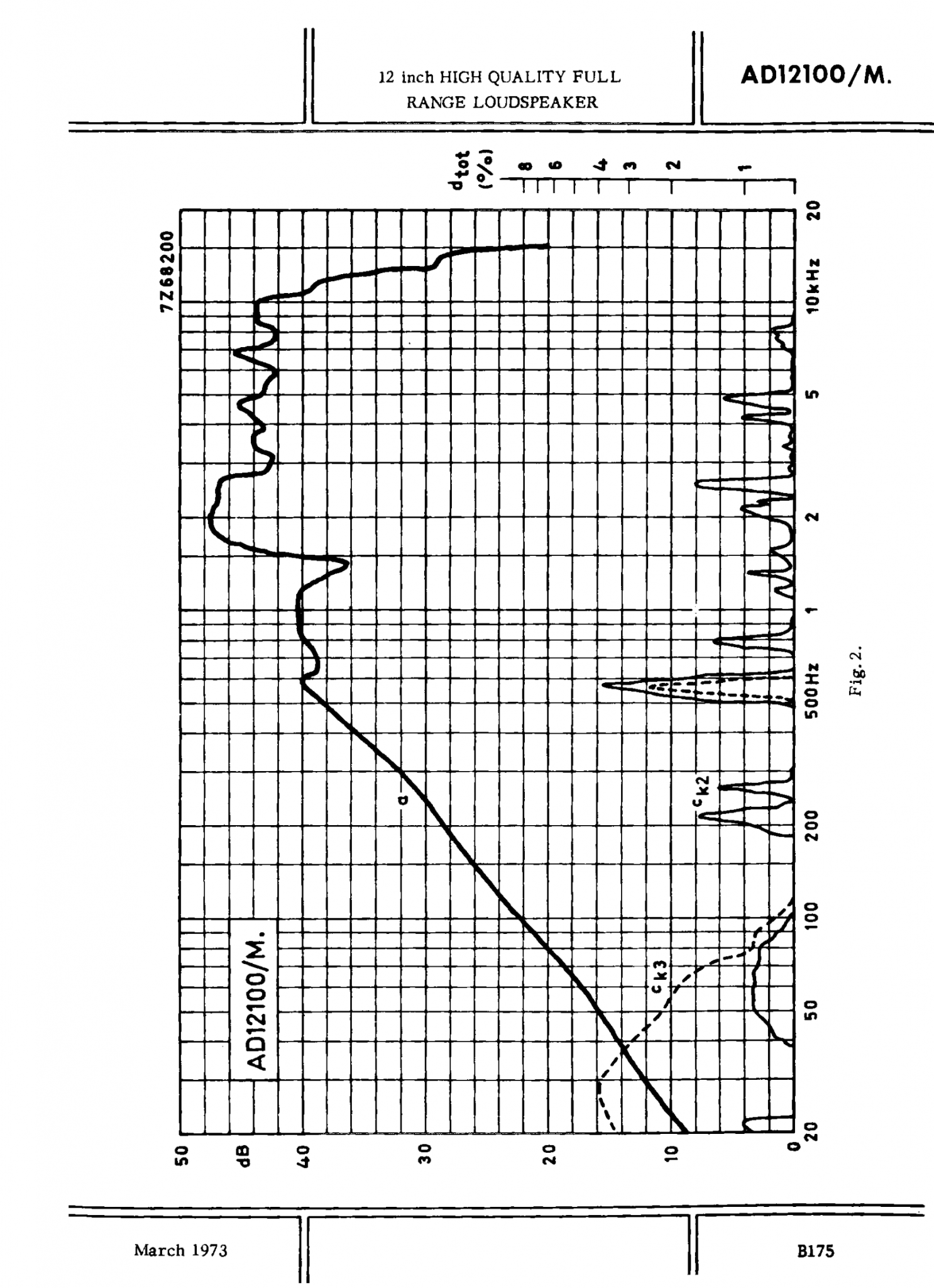

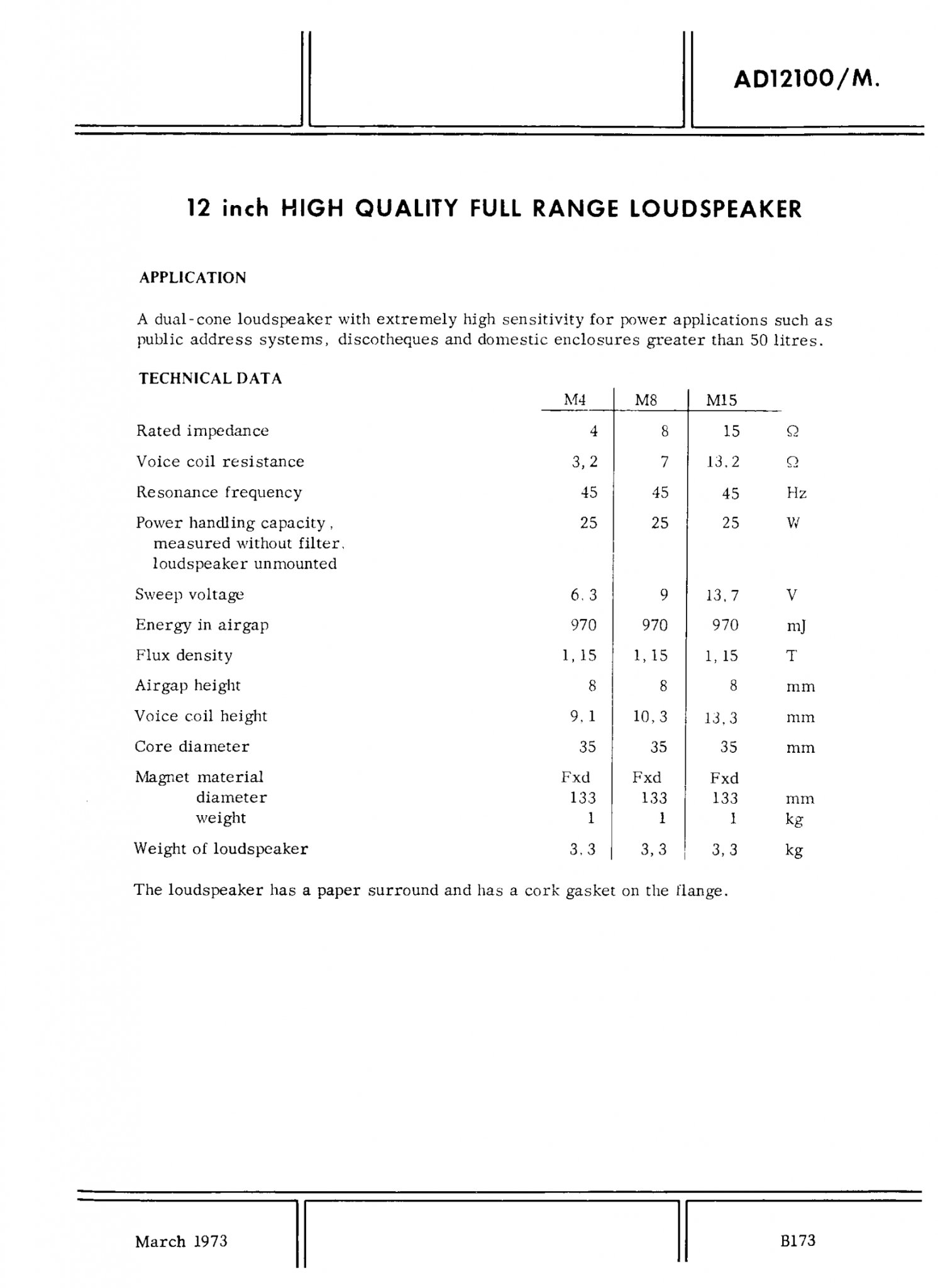

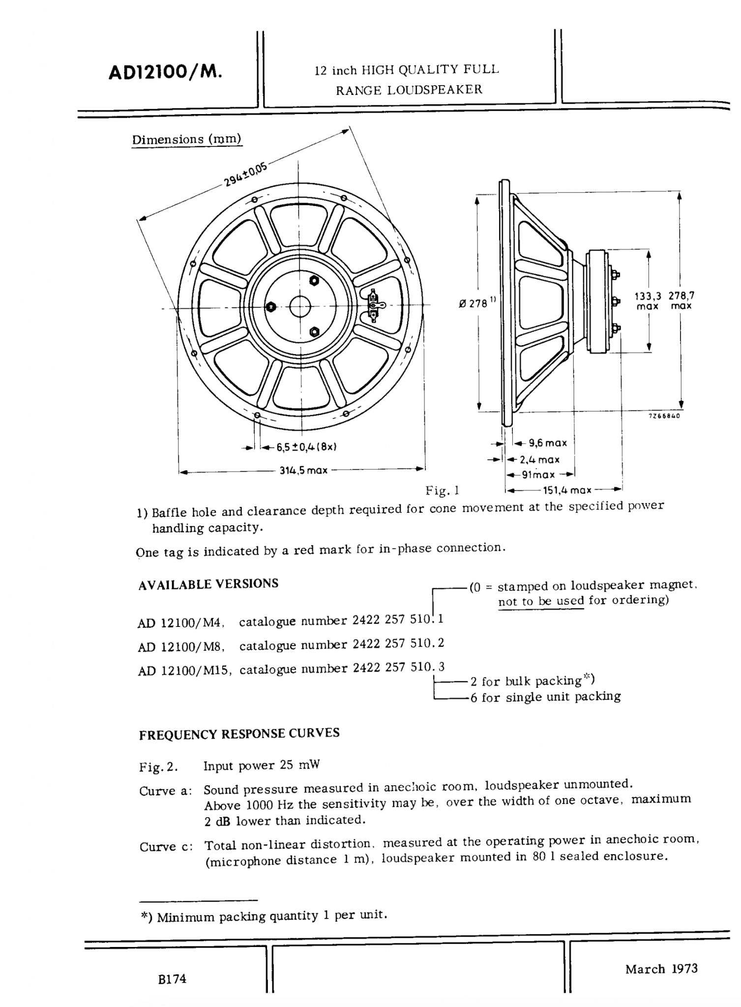

They were rated at 15Watts RMS. Here is some data on them;
Philips part number; 2422 (Denotes finished product) 257 (factory ID) and 51001 (item stock code). Designed for Public Address employment and mid range applications.
