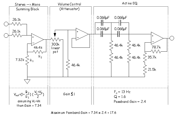

What software are people using to draw their schematics?
I use a freeware app called Wobblyhand(tm)
