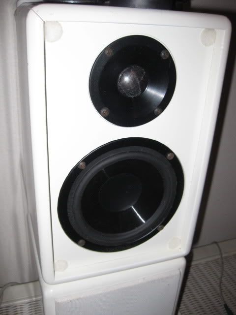

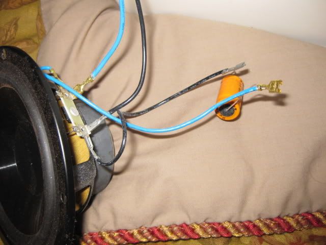

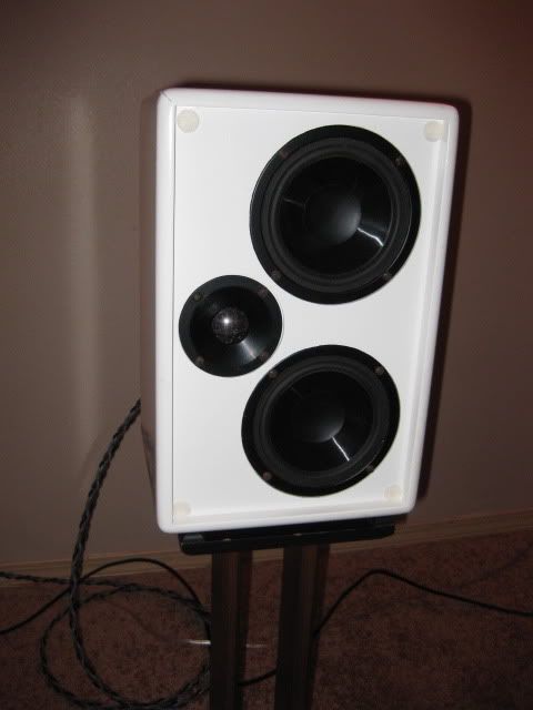

Hello everyone, it has been awhile since I have posted here. I have two pair of Pinnacle Arctic 1's and a pair of Pinnacle Arctic 2's.
Arctic 1
Arctic 2

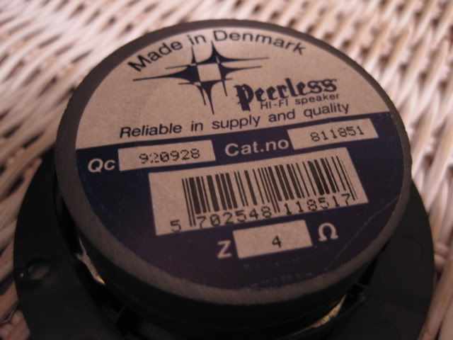

I also have enough extra woofers and tweeters to make an extra MTM Arctic 2 giving me enough to make a 7.1 channel home theater. I cannot find anything about these on the web at all. I called Pinnacle and talked to a tech who has been there quite awhile that gave me a little info. The Arctics were built in 1993 and were considered a premier speaker but were short lived due to the fact that the cabinets cost too much to manufacture. They were hand painted and had too many hours into them. They do have a beautiful gloss finish. The 1's were $375 and 2's were $475 I believe. They use 1 inch aluminum dome tweeters and 5-1/4" poly cone mids, both made by peerless
These have to be one of the cleanest, best sounding speakers I have heard. They do everything very well with the exception of bass, but I believe almost all bookshelves need subwoofers. I have heard many speakers and these have always trumped when it comes to treble, midrange, midbass, especially vocals and strings.

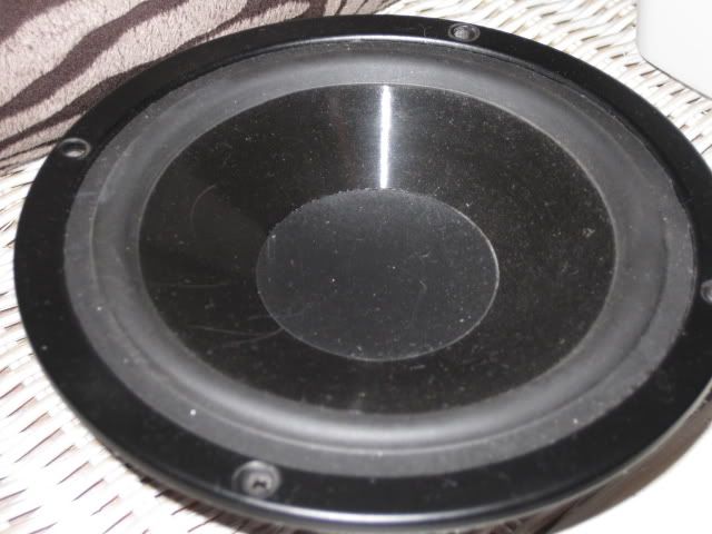

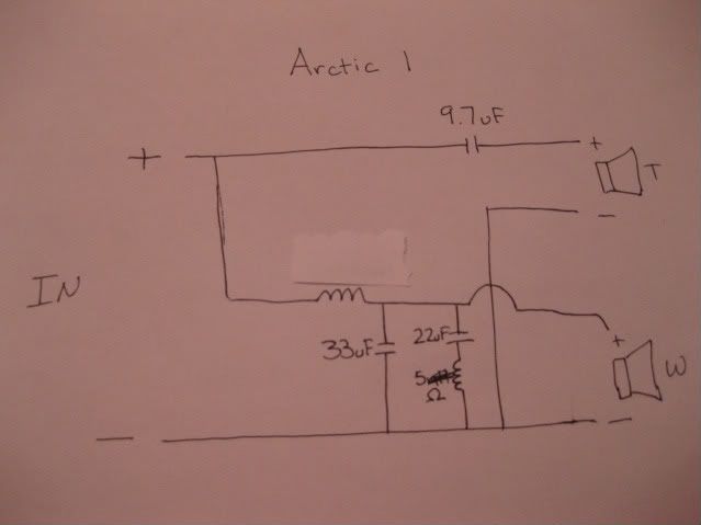

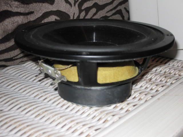

My father and I were talking and thought it would be fun to do a tower, a small line array, possibly open baffle. Problem is I don't know the T/S parameters. The crossovers for the Arctic 1's seem simple using electrolytic caps, here is a schematic. (my first time drawing one so please point out anything that looks wrong)
So what would you do?

Also, if I were to send someone trustworthy a woofer would they be able to measure it for me so that I can find out the best app for it?

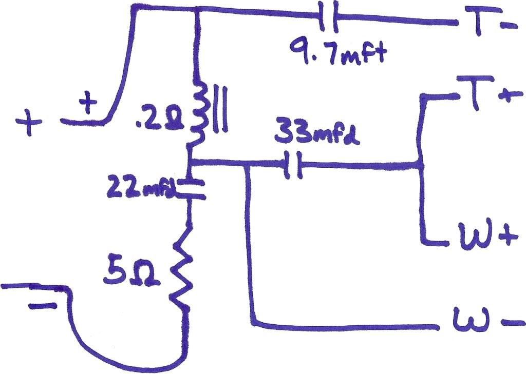

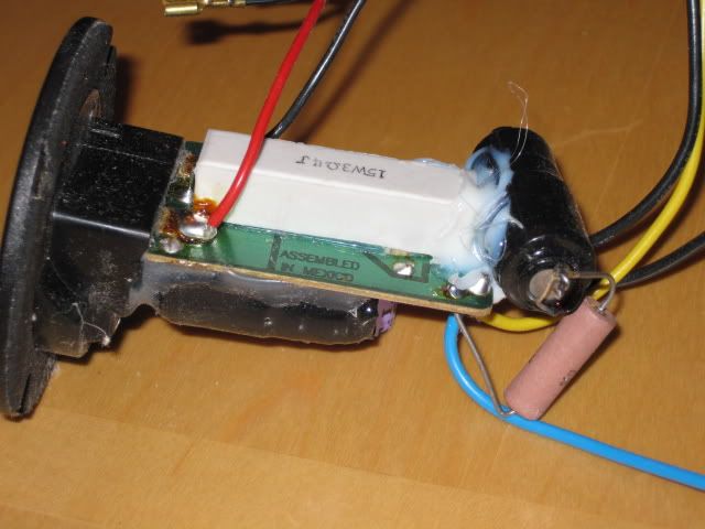

I don't think you've got the xo schematic right. Look at other 2nd order xo's and study up on how caps and inductors work when in series or parallel with tweeters or woofers. (And use units of uF for caps and mH for inductors.)

Hmmm, I thought I got it right, I just followed the flow the current would take on the board. I doubt these would help.

I second the crossover looking iffy - there is no 'return path' for any of the components there - the components need to be relative to ground (negative). From reviewing your pictures, those caps are RELATIVE TO ground, ie. they are forming part of a filter, not DC-blocking anything.
Like this :
NOTE - the uninterrupted negative line.

ohh I see, I'll go over it again and redraw it. The negative in has an uninterrupted line going to the positive of the woofer and tweeter, not the negative, unless they marked the drivers weird. I assume the positive of the tweeter is the terminal they marked with a yellow dot (hooks up to yellow wire) and the positive to the woofer uses the big spade connector.

I would severely doubt that there is an uninterrupted line to the positive speaker terminal from the negative line!? Wow, that's...erm...upside down!
If you have a multimeter, trace it that way. I think you'll find there will be a cap in series with the tweeter (and inductor to ground/negative) and inductor in series with the woofer and capacitor to ground. These are high pass/low pass filters respectively
Once you figure out the xo for both the A1 and A2, post them here.
Think about changing only the main cap to the tweeter (10uF?) for a film cap and leaving the rest alone. Also leave the R's alone. (Those Jantzens are cheap enough, but there are also much cheaper film caps from Madisound and Apex Jr.)

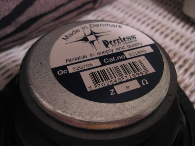

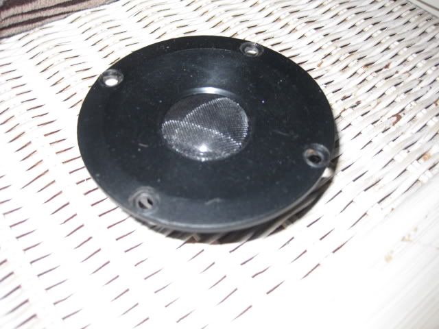

When you say "I also have enough extra woofers and tweeters to make an extra MTM Arctic 2," do you have the actual A2 drivers?
Ok thanks guys, I will open the A2s and get a look at the crossovers. What would be the reason to not replace the other caps? No significant difference to the woofer? Yes I do have the actual peerless drivers from the Arctic series to use for the other "A2" that I want to build.

If the other large value electrolytic caps are part of a notch (or even alone) in parallel with the woofer, the return on investment swapping them for expensive film caps diminishes (so save your money for a proper Zaph project). But in series with a tweeter, the effect of a film cap is quite noticeable.
I've been pleasantly surprised by cheap 'surplus' film caps from Apex Jr, in particular the 4.7uF ($1) on this page:
Whats New at ApexJr
Two of these in parallel (9.4uF) might be just the thing as a sub for the 9.7uF (assuming that's the one in series with the tweeter). There's also a 10uF ($0.60?) from Madisound.
Since you have the actual drivers, why not build an Arctic 2 clone (as opposed to measuring them and attempting to find a suitable project)?

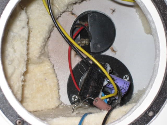

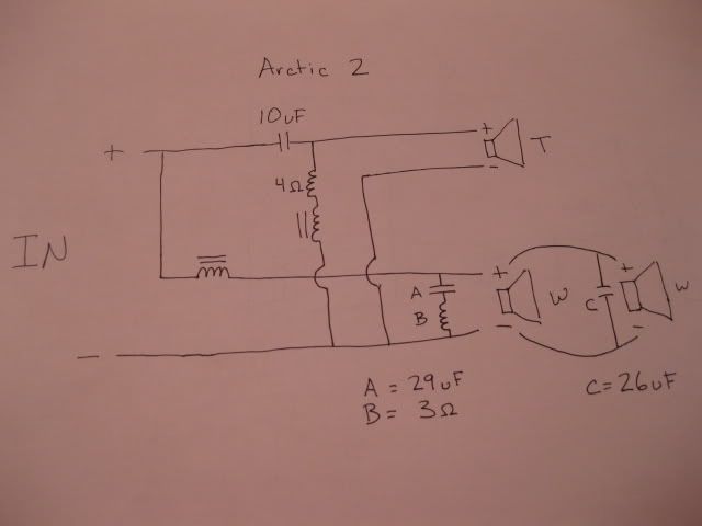

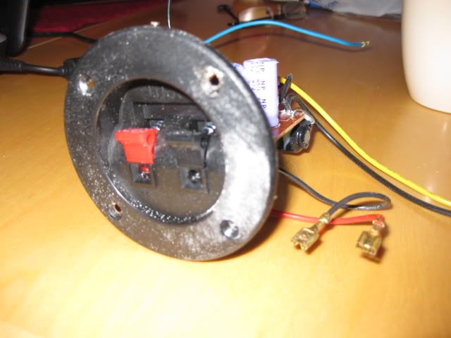

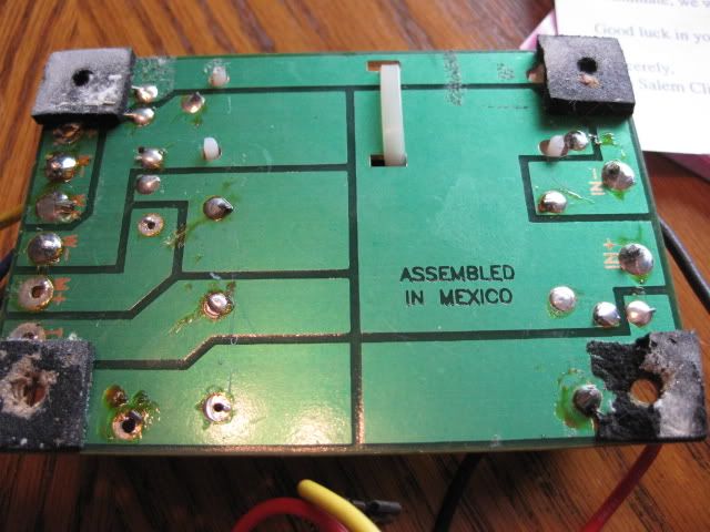

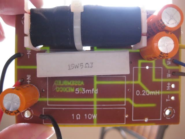

Well I opened up the A2's today and traced out the crossovers for both.
It seems as though the just screwed a terminal down inside the box for the crossover.
Here are the schematics, hopefully the look right, obviously the A2 was a bit more complicated. I marked the resistors with ohms since they were labeled. I know it was suggested that I use mH to label the coils, but I have no way to measure mH so I left them blank.
If everything looks right I do plan on building an Arctic 2 clone.
Dan

Now we're getting somewhere! I think you'll agree these were not put together with much love and might not deserve being called 'premium speakers'? (Or is it possible someone has monkeyed with them afterward?) But that's good because now you can make it right.
As practice for your later 'proper' project, I think the most you should do is rearrange and rewire the existing xo parts (except for the new 10uF film caps I previously mentioned) on a new piece of board (hardboard, pegboard, mdf, etc.) and replace the spring-loaded terminals with something beefier. Or just replace the caps, and move on....
What is that stuffing material they're using? You could add to that.
Thanks! The spring binding posts are not actually being used, just being used as a mount, the speaker actually uses very decent 5 way binding posts. What do you mean by the speakers not being put together with much love? Are you speaking of the crossover layout, components, or? I do believe that they are in their stock form. The stuffing seems to be some sort of cotton fiber, finely minced, with netting holding it all together.
If I took the crossover completely apart and laid it out on pegboard using the schematic I drew, would there be anything to gain, other than experience of course! 😀
Thanks again,
Dan
Thanks again,
Dan
