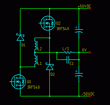

Thanks Poobah & Flq for ur replies.
But I am still confused. You mean to say that it is the fastest among all, leaving aside capicitance, reverse leakage or forward drop. I have used UF series as a snubber and it works well, but not in the config as shown in pic, where they recommend schotky.
Why so?
ajazz
Why so?
ajazz
I assume this a class d amp? In this circuit, these diodes are called "freewheeling diodes" as they allow "buck" action. Schottkys are chosen for their efficiency and their lack of recovery effects. In this circuit the transistors see the recovery current, large recovery currents can develop voltage across the source inductance and cause difficulties in maintaining good gate drive.

Thanks Poobah & Flq.
If Schotky diodes are so good, which can be used everywhere then why are they still manufacturing Ultra, hyper & fred diodes.
Is cost the only factor. I don't mind keeping a single inventory rather keep all varieties.
Dear flq though I love ClassA and have made many varients for personel use but it can't surpass the sound quality of Class D at high power levels (good design). Well thats my experience and feel that a good D amp is the future of sound.
BTW. So I should stick with Schotky - - thats right ?

Hell, I don't know... I work with off line SMPs in the daytime and we care about that recovery stuff and all mostly on the primary side. but we are jamming square waves on and off of an inductor at high voltage and 100kHz+. In the output, there are other considerations but schotky's are popular there if the turns ratio allows it(reverse voltage thing ussually). We dont ussually care about the parameters we've been talking about here in the SMPs because of the harsh invirenment. Noisy as that electric drill test without the drill.
As an example; When you have 5-10 amps dc output current the schotky forward voltage being so low provides substantial effeciancy increase.ie... 5A X 1V =5watts lost in that "Freewheeling" diode if it is a fast or ultra fast component. If it is a 5V supply you just lost 20% of your power in that diode!And at that level it will be expensive and need a heat sink. However, 5A X .5V is only 2.5watts maybe in a schotky. about 10% loss!... That is a big deal... Schotky's are expensive in the SMPs world but those people build many thousands of units so they scrimp werever they can... We use these things a few at a time... It is not acttually that simple but I'm sure this belongs in another forum catagory if I continue...
Basically the lower current operation of any diode has shot noise. Even the LEDs we sometimes use for bias ref voltage... The schotkty not being your normal silicon PN junction has lower noise in that region than the others... To us audio finatics that is a big deal. In my power supply, the diode will see the 0 crossing portion of the AC waveform 60 or 120 or whatever times a second, and that is the noisy area...

The reverse rating of the Schottky is not forgiving at all. A few Volts "over the line", for few nanoseconds, and you're out. One good glitch from the power line will do this. Hell, you can blow one up walking across a carpet!
Surely placing a metal oxide Varistor on the primary between phase and nuetral is going to remove those spikes.
And a well designed soft start will limit any surges.
Dan
True enough freakyone, do keep in mind that MOV's are consumable... they can only take so many whacks.
My point is that Schottkys fail because of a purely voltage related mechanism.
Silicon PN diodes will avalanche (zener-like) when their ratings are exceeded... the failure mechanism then is about power and the thermal capacity of the die. PN's are just tougher.
