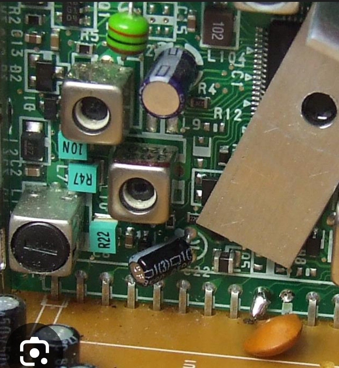

What resistor is this?
Hello everyone!
I've been trying to fix a FM receiver and I found this weird resistor. I've found it the receiver it's a blue box that says r22 so I would think it will be 22 ohm but it measures sort circuit. Is this some special kind of resistor or it is faulty and that's why it measures sort circuit? You can see it in the top right in the photo.
I think it's a variable inductor.
It is, ofc.
@VaggelisDer It changes the inductance by screwing the powder core in or out of the coil within the metal screen. In a tuner these are used to tune the receiving bandwidth, suppress mirror frequencies etc. If you mess with them you'll have a hard time to get the tuner to the former sensitivity and bandwidth work again properly. Don't screw yourself with these! 😉
Yeah I meant the one at the top right sorry for the quality of the photo I didn't see the red box. If it is a .22 ohm resistor why would it make sense to have almost sort circuit the antenna to ground. This FM module is not recieving any signal or noise it's completely muted.
It does not make sense to short the antenna to ground. Above the R22 component in the board silkscreen it is marked L6 (upside down in the photo). That would indicate an inductor.
Depending on what else is connected that does interact with it. It's very likely to limit the bandwidth or part of an oscillating circuit, an impedance transformation could also happen there.
